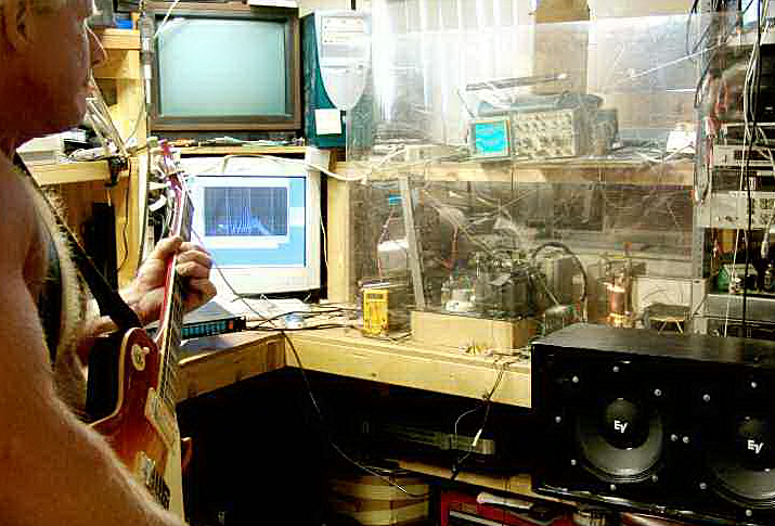

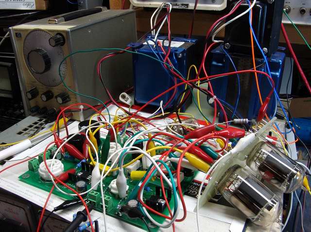

Two pictures.
The first shows "furball construction". A quick way to find out if a circuit works. This one actually got made into a PC board but I am still waiting for the 9 pin compactron PC board sockets that are "due any day now" from China.
The second shows my last "practice guitar amp" prototype. It too is made with clip leads, but runs on 1500 volts. That is why there is a Lexan blast shield between me and the amp. There is also a fire extinguisher on the floor nearby. This little toy is entirely SE class A and put out over 200 watts. The spectrum of the output of a fully cranked chord can be seen on the PC screen. For me 200 watts is easy, 2 watts is a challenge.

I've driven an original Celestion Greenback with 3W and it sounds really nice. But the Greenback is only rated at 25W (20 for the new ones) and they are expensive. Does anyone make a lower power 12" speaker? The only one I've found is the Celestion G12 Blue and it is way pricy for me (> $250).
Since this is a bedroom amp, I would think something like the MOD 6-15 would be nice.
