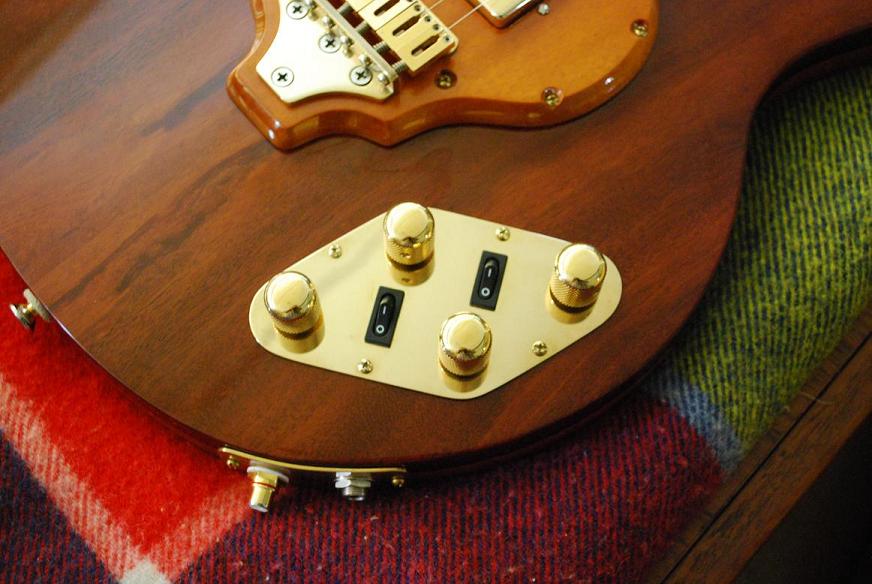

Gday Cassiel,
Yes, an Acoustic tone, it's one of the sounds you can choose from my guitars, my guitars have 8 different tone settings by using the two switches on the control panel & the pickup selector switch.
I'll attach a picture of the control panel.
The Acoustic tone is one of the settings as well as Blues, Heavy Metal etc etc.
