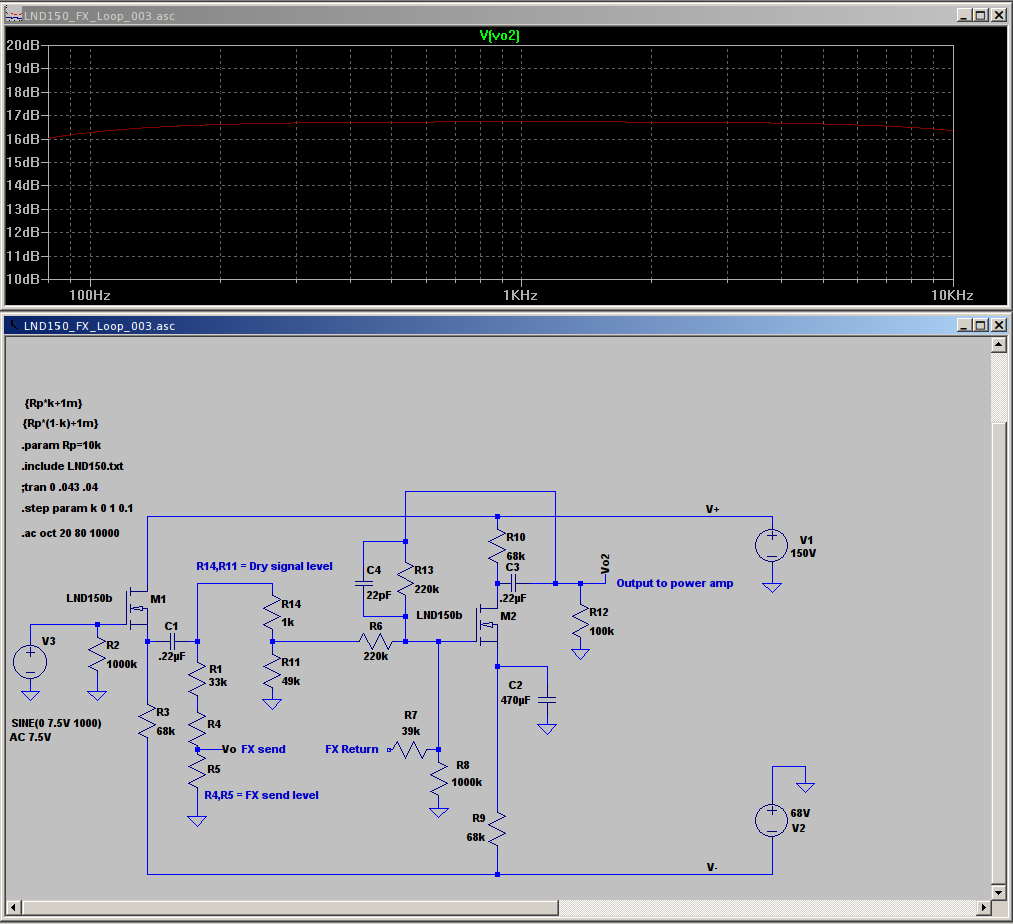

The electronics of my amp are almost done - but there is one last piece of the puzzle missing. I really want to have an effects loop. Gotta have some reverb and delay after that distortion!
The loop doesn't have to be all-valve. Solid-state is fine as long as it contributes no audible distortion (i.e., is kept out of clipping, and produces less than 1% THD). But it must respect the basics of audio electronics: reasonably low source impedance on the "send" side, and enough clean gain to bring the levels back up, post-stompbox.
With two independent preamp channels, and very little room left on my plywood circuit board, I am momentarily stumped as to how to manage this. My initial ideas quickly evolve into absurd levels of complexity, and then get discarded. I haven't found a simple approach, yet.
I have +150V and -75V rails in my power supply, and a few LND150 MOSFETs, so that seems the way to go, but how to keep the whole thing simple?
I am also thinking parallel effects loop; less chance of ruining the basic sound of the amp that way, I think.

Anyway, here's my first attempt (simulated in LTSpice) at an FX loop. One LND150 to buffer the signal from the master volume pot, a passive FX send using a tolerably low impedance (10k) pot, a second LND150 to bring the "wet" signal from the FX loop back up to its original level, and mix it with the dry signal if desired.
The second LND150 operates as a crude virtual earth mixer. With up to 150 volts p-p of headroom, it should never clip in use, so it should be completely inaudible in the amp.
There are an annoying number of controls: master volume in the preamp, and then, in this FX loop schematic, an FX send level pot, and a "Dry" send level pot. I'll probably need to add an FX return level pot too, or at least a switchable pad in case return levels are too high.
3 pots, 2 MOSFETs, 2 quarter-inch jacks, a slew of resistors - this FX loop circuit is more complex than an entire classic Fender preamp. And this is after a few days of trying to simplify, simplify, simplify!
LTSpice screenshot, and .asc file attached. Comments, suggestions, and constructive criticism will be gladly received.

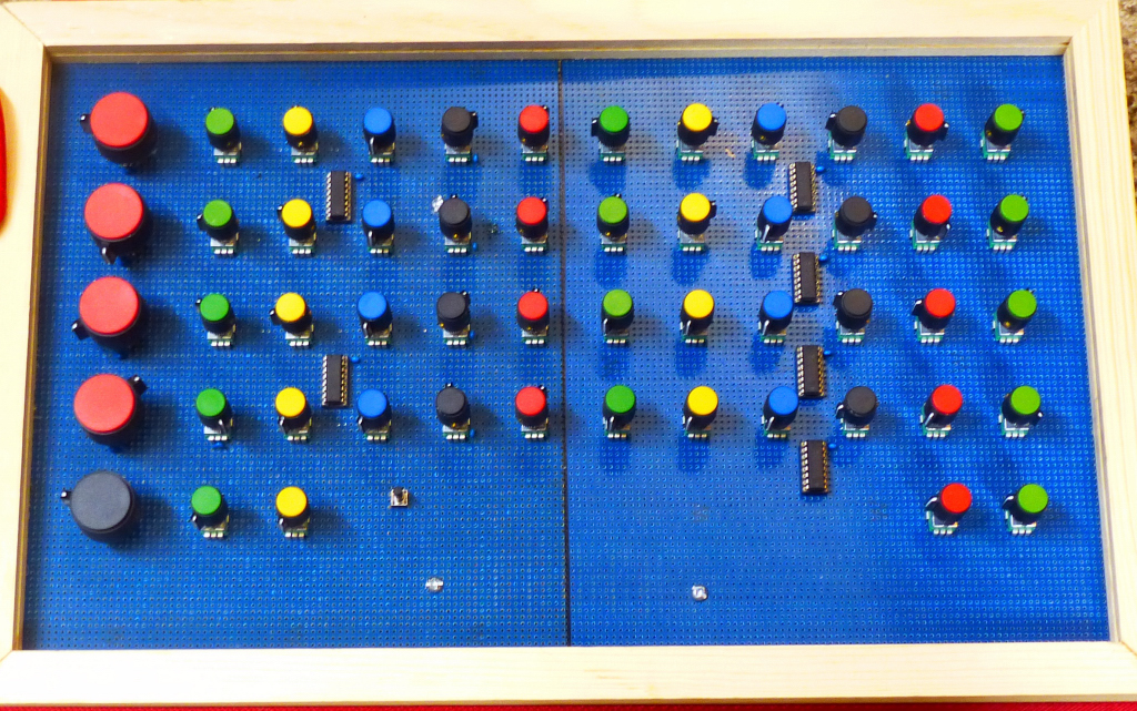

My latest project has 53 knobs and a "test" button. It however cost a bit over $100, but that does include the knobs. It could be duplicated for about $100 without knobs, but I don't think we are ready for a Hundred Buck Synthesizer Challenge.
This is neither an amp, has a guitar input, or uses any tubes, but all are planned long term. My favorite "controller" is six note polyphonic, so that's the next obstacle. Polyphony requires a more powerful processor with more I/O. An advance prototype Teensy 3.6 will be headed my way soon. I plan on making a basic LCD / menu version that will fit inside the guitar.

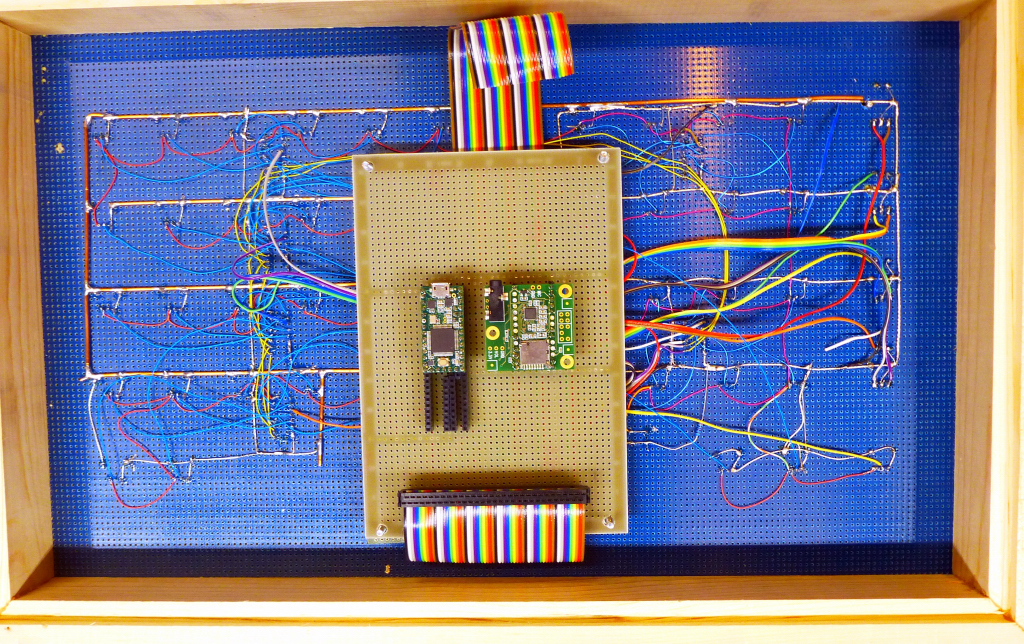

Oh, boy! I can see why you had to color-code the knobs!My latest project has 53 knobs and a "test" button.
I hope you never have to debug any of the wiring. That would not be a fun job!
The wiring looks ugly because I did it all in a hurry, but it's really simple. Each pot gets ground and 3 VDC. The wiper from each pot goes to a pin on the micro. Each corresponds to a variable in software with names like VCO1_BLU, so it's rather obvious where it comes from. The left side is all VCO's, and the right is VCA's VCF's and ADSR's, same color coded variables. The big black knob and its 4 little friends on the bottom row are LFO and modulation knobs. I have an Excel spreadsheet to keep track of wire color and pin numbers.

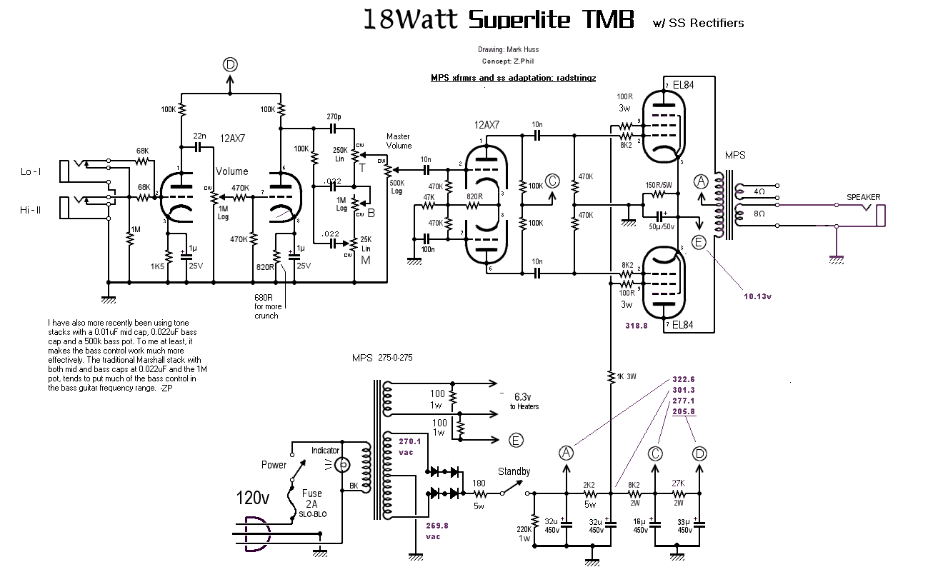

Hi guy ......got a hold of a mullard 5-10 amp the other day and thought this would make a good guitar amp.....nice set of transformers , yada yada etc
so a started making a 18 watt tmb.....so far all good....but it seems I have ultrasonic oscilation in the PI.......I come to this conclusion after I disconnected the preamp 12ax7 entirely and attached some music direct to the PI grid .....the sound is almost like blocking distortion but having droped the signal caps and grid stoppers resulted in no change ...dropped a 47pf on PI plates no change
The amp itself without signal is wonderfully Quiet....you can hear white noise as the master fader is brought up.....no squeals or pops of any kind...
would redressing the stage fix it or is there a simpler way...I have not come across this problem before....
Help !!
To add I've made this one before without issues....nice base amp,pedal freindly
