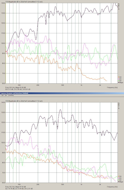

A conventional horn that plays to 150hz needs to be very big. For instance, the length should be at least 23 inches, and the mouth needs to be very large... A diameter of 92 inches isn't "out of the question."
Now we can reduce the mouth size, but the frequency response goes to hell. The typical solution is to find a "happy medium", where ripple isn't too bad, and the box size isn't too big.
Danley stumbled across a novel solution to the ripple problem, which is basically to "tune" the ripples to smooth out the response. It works quite well for subwoofers, but not so great at high frequencies.
The reason that it doesn't work at high frequencies is that a "notch" is introduced into the passband, and that sets the upper limit.
For over three years I've been trying to figure out how to get a tapped horn to play full range, and I think that I'm very close now.
- This horn's response is +/- 3db for three octaves, from 200hz to 1600hz.
- Above 500hz, the horn's distortion is over 40db below the fundamental. To get this kind of performance in a sealed box requires very expensive woofers. There are other horns with comparable distortion performance, but none that are this small.
- Probably the most impressive aspect of this horn is that it has the best of both box types. It has low frequency performance that's comparable to a sealed box, a box size that's competitive, but distortion that's much lower, with a wider bandwidth than a tapped horn.
Like the HOMster, the device above has lots of HOMs. The difference is that this device is generating reflections in a very calculated manner, and then using polyfill to "soak them up." So you wind up with the low distortion of a horn, in box which would normally be far too small. (The entire enclosure is less than two liters.)

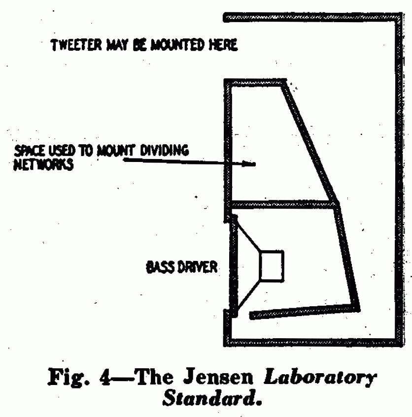

I've seen that shape before... What was it "Jensen Laboratory Standard"???
Drawing ripped from Radio Electronics April 1955 pg 31.
"Horn Type Speaker Systems" by George L. Augsperger
There was a PDF of that article floating about recently,
but I've lost track of the link.
The text of the article describes just what you were saying.

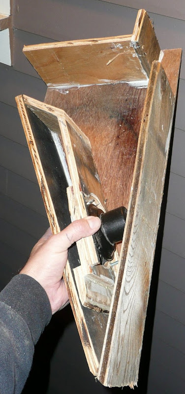

Tried something stOOpid that didn't work, but thought I'd share all the same.
NXT exciter near the throat of my StyroSmith. Does not appear to have any
use or abuse as a unity driver in this application. Maybe its just septums of a
Smith horn damp out the flex modes? Certainly got along plenty well enough
with large flat panels of the same exact pink extruded polystyrene foam.
Proabably comes as no surprise to those who know, that this shouldn't work.
But I was dumb enough to try it anyway. Figured I'd save other dummies the
five bucks price of admission to repeat the experiment.

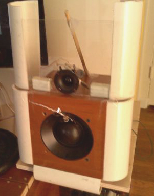

The roundover on The HOMster really made an improvement. But what if we filled the horn with foam? And while we're at it, why don't we add a vertical roundover?
So I chopped up about fifty cents worth of PVC pipe, and added about a dollar worth of 30 ppi reticulated foam inside the horn.
Geddes uses reticulated foam to damp the sound which doesn't travel down the axis of the horn. The way that the foam works is that it absorbs the axial wave once, but the reflections inside the horn are absorbed many times. (Since the reflected energy is reflected back down the throat, off the walls, off the mouth, etc...)
Also, just to be a complete lunatic, I put a *full* roundover on the horn. In other words, the roundover extends *into* the mouth. Because the top of the horn is baffled, my hypothesis was that this wouldn't affect the low end dramatically. Besides, if half a pipe is better, how about a full pipe?
Here's what the horn looks like for these measurements:
Note the roundover on the sides *and* the mouth.
The horn has been filled with 30ppi reticulated foam. The 2" PVC pipe extends all the way into the mouth now. In the previous measurements, it was a half pipe, duct taped to the bottom of the horn.
In the side view you can see this is a REALLY small horn. That's a Radian compression driver.
Of course, this is outside the car. The polar measurements were performed inside the car.
And speaking of polar measurements, here they are. The untreated response is at the top. After the second stage of treatments, I measure the horn at the same voltage level. In the graph the second set of measurements were lowered by 10db.
The HOMster with a horizontal roundover, a vertical roundover, and stuffed with reticulated foam
The HOMster with a roundover
What do you think? Here are my thoughts:
- The 0 degree (purple) and the 15 degree (red) curve are virtually indistinguishable now. They track each other within 2db from 1200hz to 10khz. Remarkable for such a funky horn! And a dramatic improvement over the untreated horn.
- The untreated horn has a nasty dip and a peak at 1800hz and 2800hz, respectively. When you have a peak and a dip so close together, it's a challenge to treat with an EQ. But that didn't stop people from trying. These horns were used in dozens of "sound off" cars, where they were frequently paired with expensive Rane equalizers, modified for use in the car. The equalizers alone cost hundreds of dollars, and modding them for the car increases the cost. Now look at the treated horn. Where's the peak and the dip?
