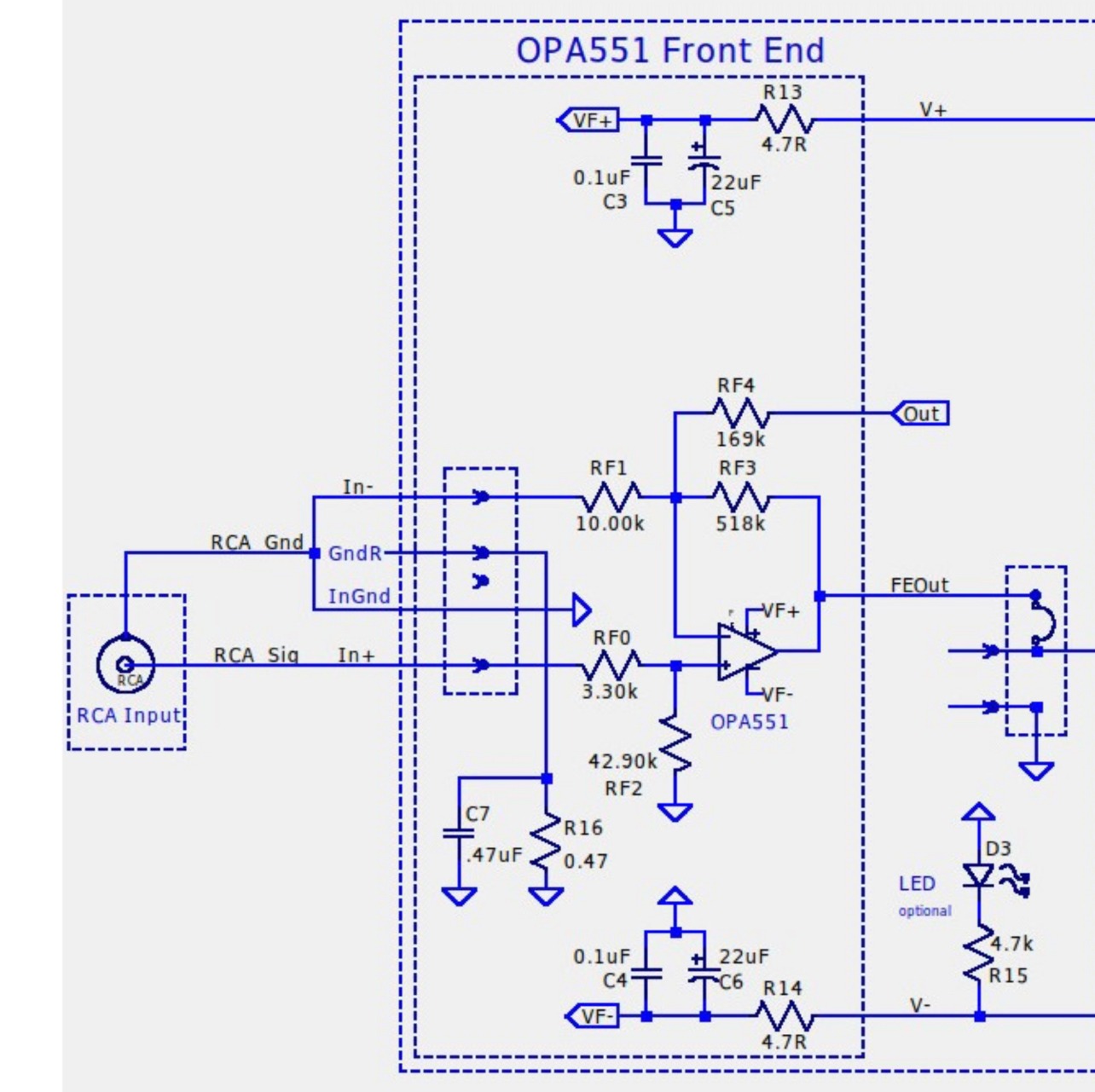

The schematic and PCB include the opa551 opamp front-end that works quite well. Go to post #306 and download the Build Guide.
looks like I have some reading to do. Thank you as well!
Edit: duh!!! Right in the build guide!!!
