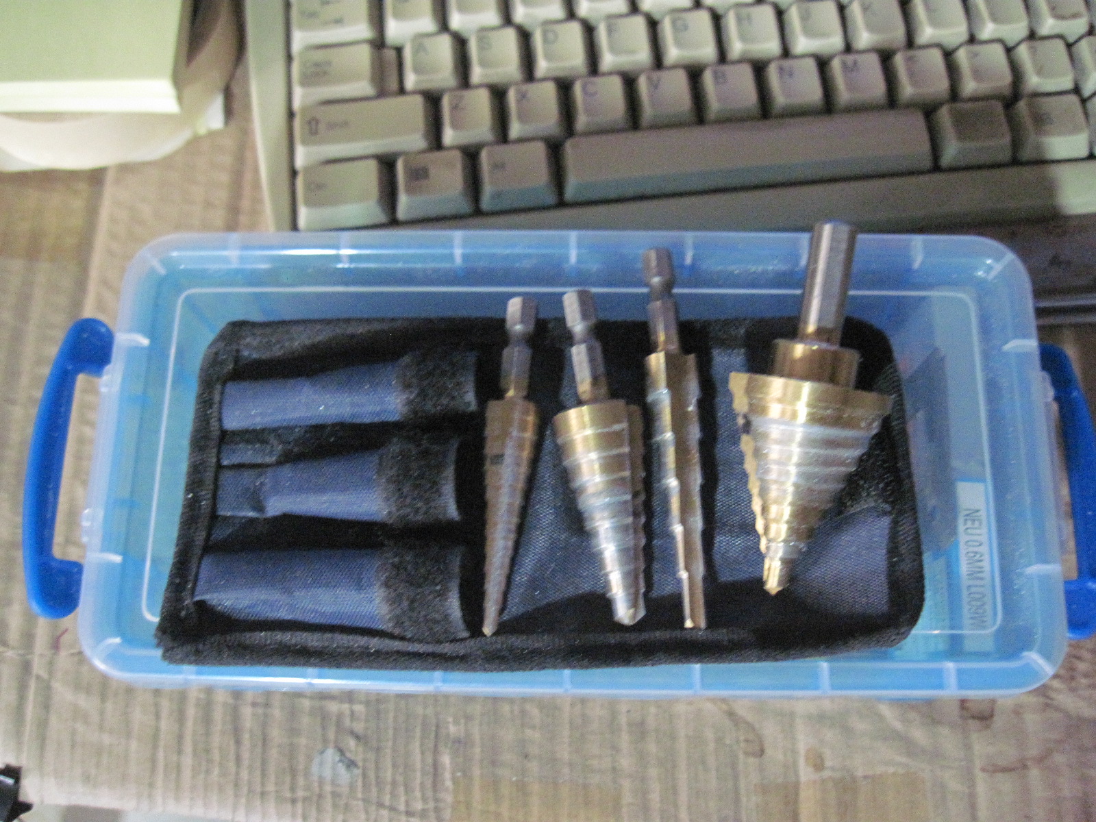

i work with aluminum 1.5 to 3mm exclusively, very easy to drill,
for rectangular holes, i drill 10mm holes on the four corners and
then use a nibbling tool to cut, flat files to straighten up....
for round holes, i use hole saw cutters, i have them from 20mm to 70mm dia.
i also use step drill bits aside from the usual twist drills from 1 mm to 13 mm...
for deburring, i use angle grinders with flap sanding attachments,
i also use small rotary grinders for those hard to reach places....
thank you. i use a few unibits and a hand drill. an old knife and x-acto to deburr. and a little hand tap in m3 and m4. the boxes are standard hammond 12x8x2" aluminum.
I've never owned or used a Unibit. I suppose that if you can manage to get it started on-center (always the trick), it would hold pretty well.. better than a series of progressively larger bits.
So do you start with a stubby center drill, then straight to the Unibit? Or do you size-up first?
I imported several hydraulic punches from China can punch up to 5 mills, but I use 3 or 4 mill aluminum; I have square and round punches up to 104 mills only recently found how useful step drills are, also have sets of cross hole counter sink bits and centre drills from China. I have a Japanese hydraulic Punch; one die for this machine cost more than 10 complete sets of the Chinese Hydraulic punches.
