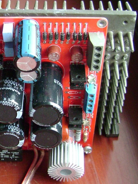

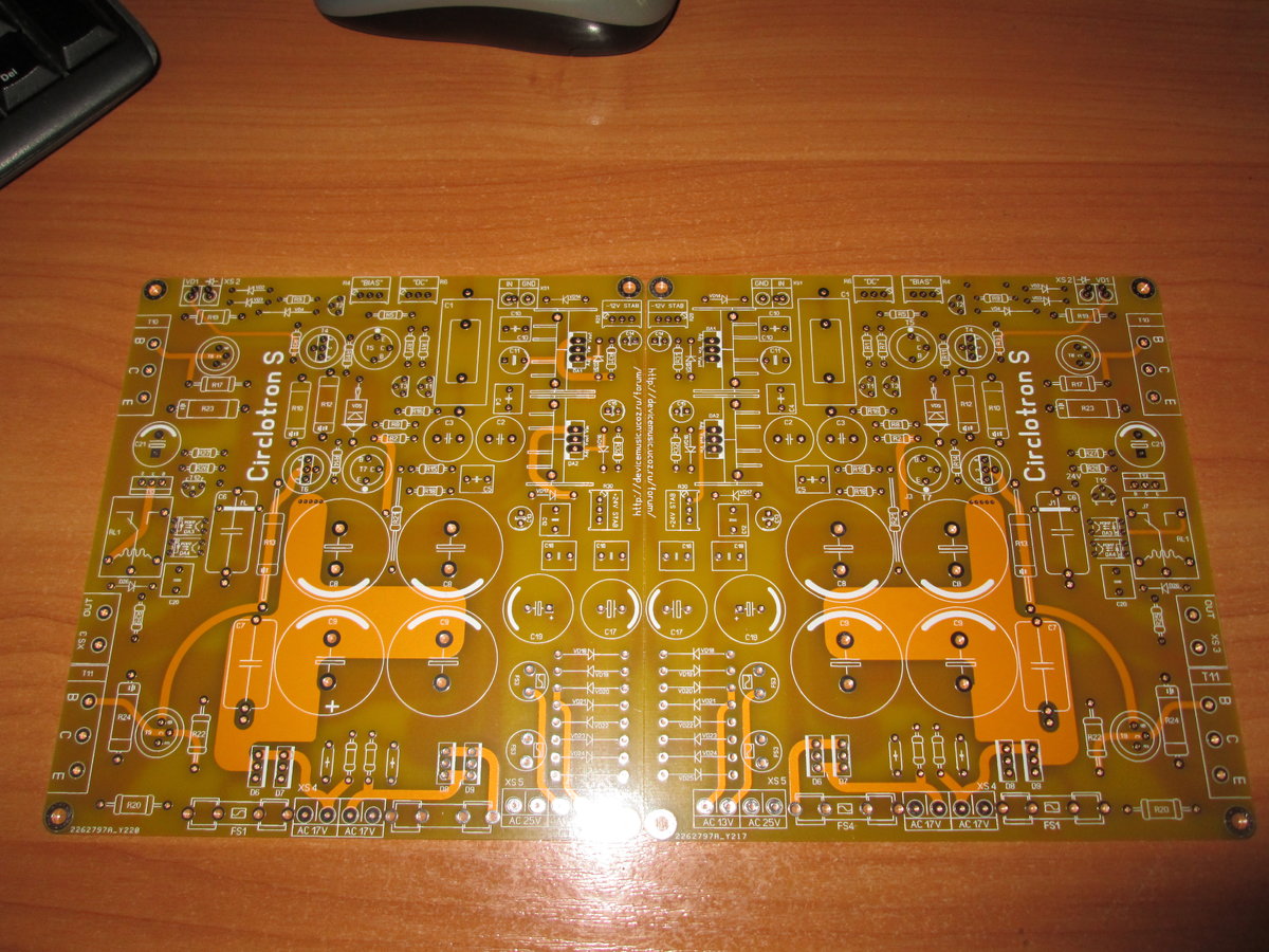

The Germanium-only circlotrons. Powerful, wideband.
Circlotron-S

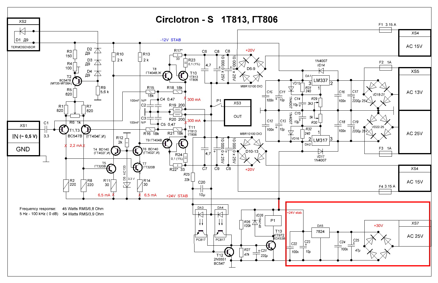

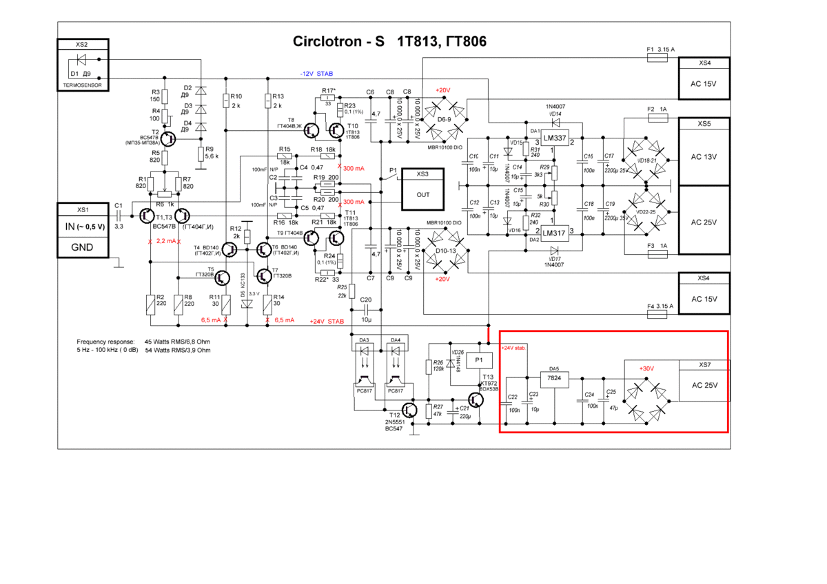

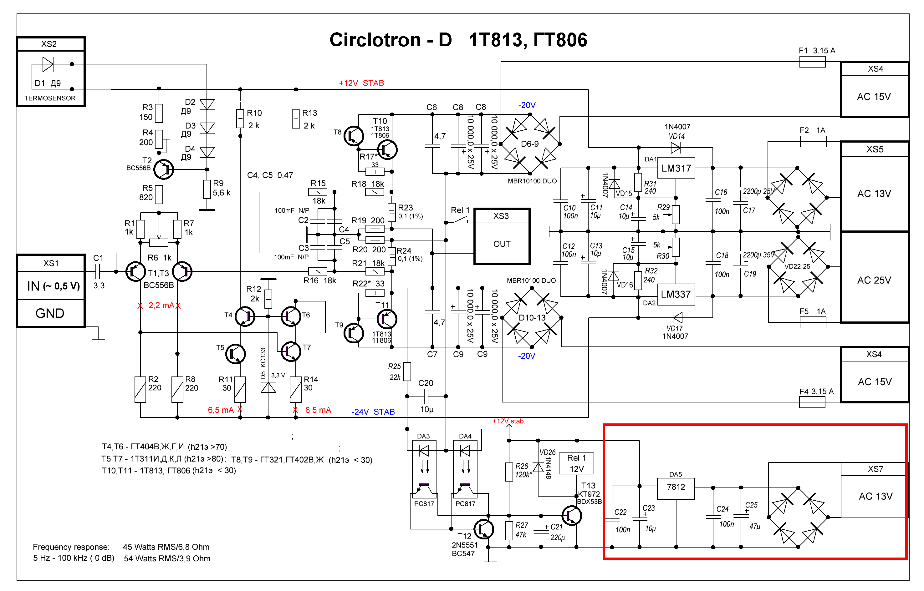

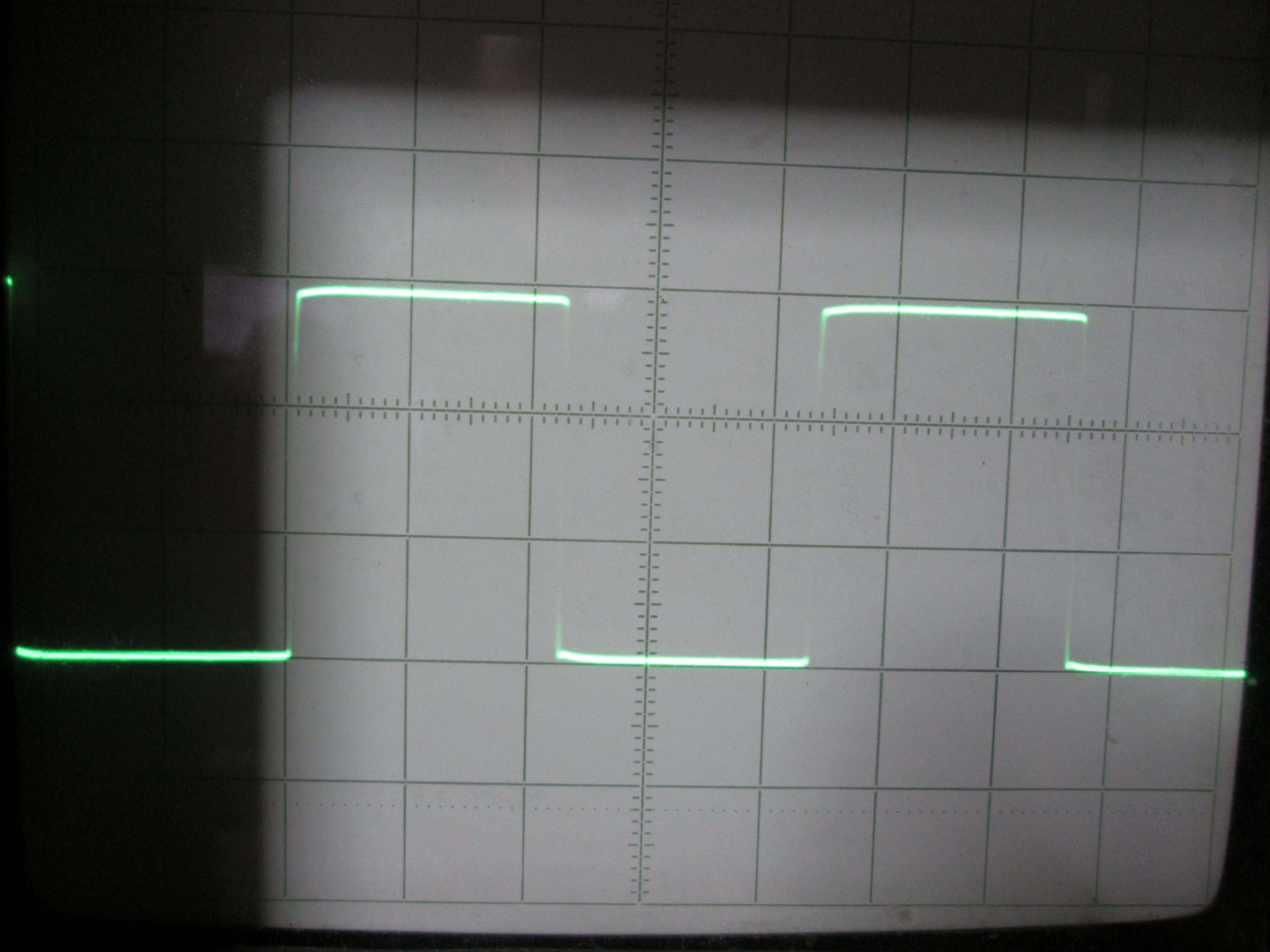

If there are europian analogs 1T813, then it is possible.
On the other hand, the 1T813 seems to be made not quite in the Asian country.
She's a bit European. )))

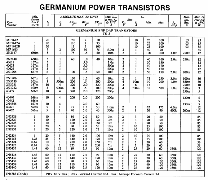

The GT806 is slightly weaker. The analogues are given by reference.
But whether they really are appropriate, you need to look.
Транзистор ГТ806 — DataSheet
