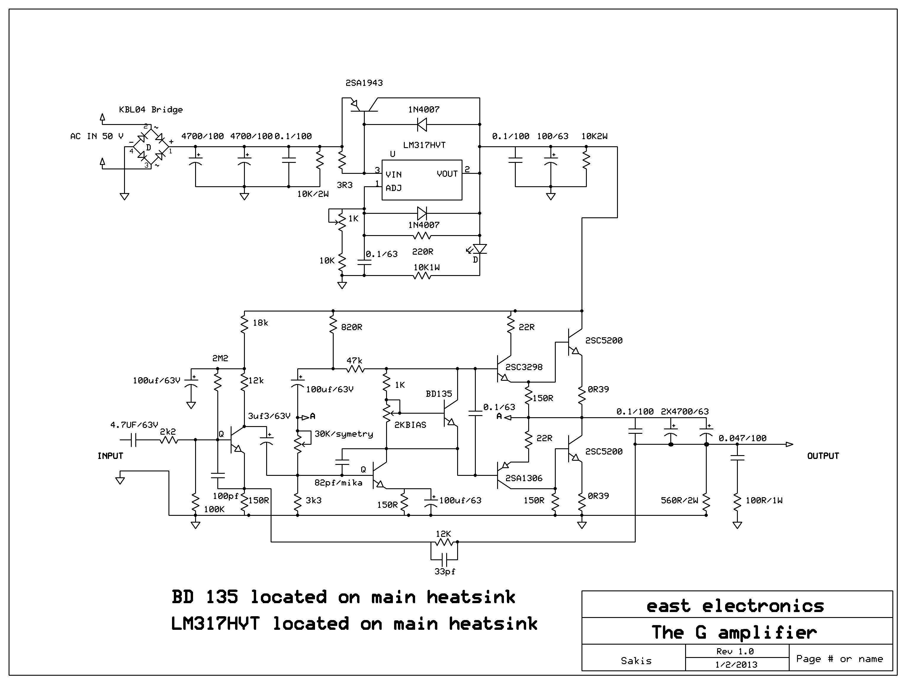

the G amp ....
there we go ...since the one and only published a class AB schematic based on TIP142-147 which i actually think is very bad and over dated only because is depending on those transistors but also cause darlington topology shucks to my understanding .
Said to my shelf not much happening in class AB so i may as well go back ( like NP did :D) and draw a schematic based on 1970 technologies with a few upgrades to gain topology and semis .
So we have the G amp which G stands for Geriatric
The design is simple i choose to run it of 63V regulated power supply and as we speak its working on a vero board producing amazingly sweet bass crisp high and very clear mids...Next step will be to produce a proper pcb and then measure or debug
highlights :
The common heatsink of the LM 317HVT will also provide thermal protection and the regulated power supply sziklai style is pretty quick ,very quiet , and capable of almost 3.5A well enough to supply one Chanel ( intention is to keep i dual mono or mono block and pcb will be based on that )
The design is very free and you are welcome to criticize ,contribute ,debug ,simulate and comment on
Kind
regards
sakis

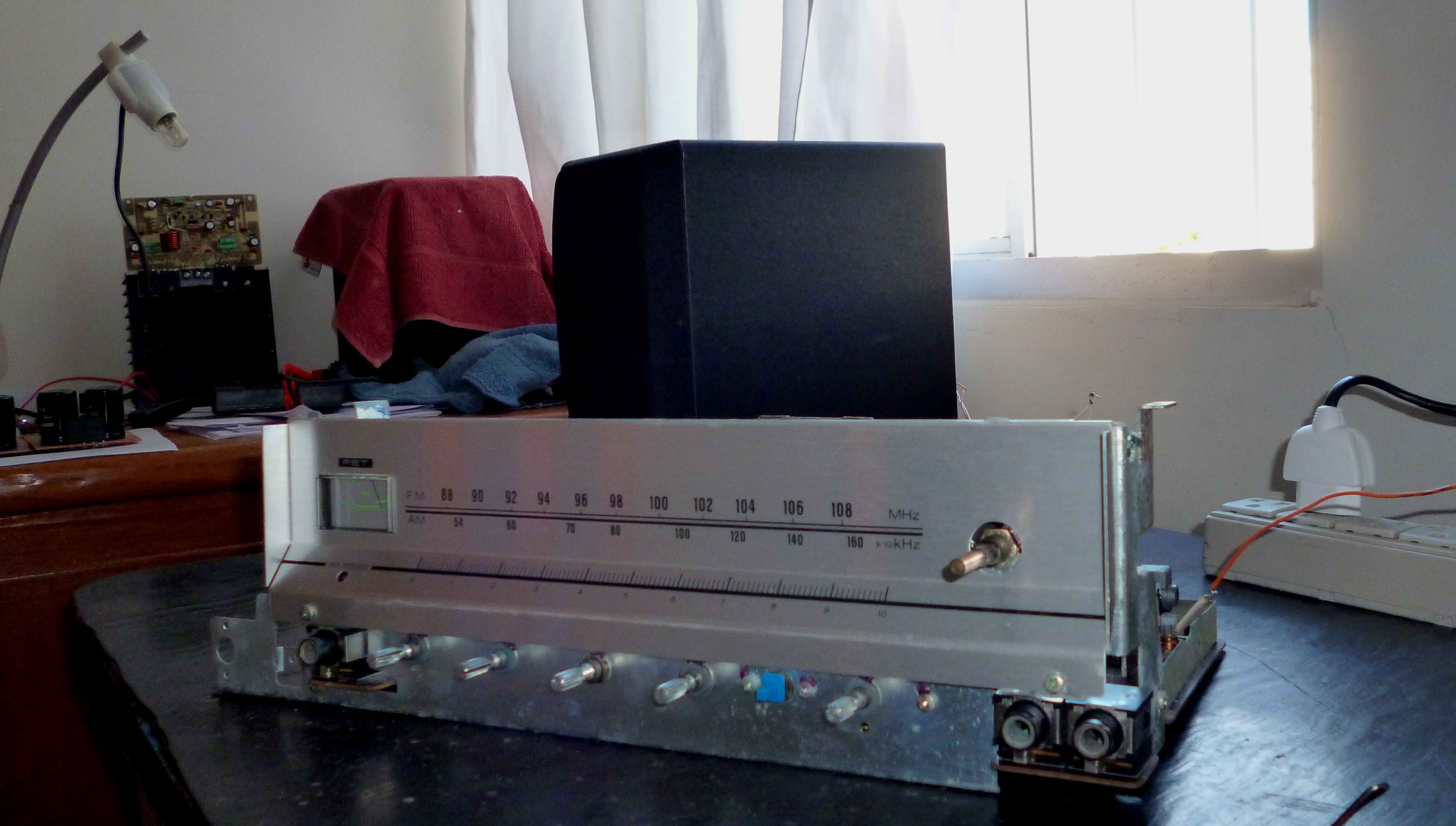

This is what i am doing rigth now Sakis.... a very old style (1970) system that i receive as a gift..was dismantled but i could not kill it because the lovely radio reception.... it goes playing that old style (distorted) sound, filled with crazy harmonics...but sent me back to my good old days.
The circuit is alike yours...not that different.
Will make a picture now!
regards,
Carlos

thanks for thinking. I qualify to build this, I'm retired.
Is there supposed to be a dot (connection) between the rightmost 4700 uf cap and the speaker out, or does the output transistor junction just connector to the 4700 uf cap which connects only to the 560 ohm resistor which connects to ground?
Congratulations, I think this is a single supply amp which could be protected against shorts by a single 3300 uf cap between output and speaker, without the stupid noises back to back electrolytic caps make when they go through zero volts. Unlike the MJR7 which I have been thinking about, this design has parts you can buy at distributors. The MJR7 fets come mainly from counterfeiters. I've been collecting parts to clone off the dynakit ST120 for organ replacement amps, but this design looks more modern. Simpler, too, without the 7 transistor djoffe bias board required to solve crossover distortion on the ST120. 30 W, 8 ohm speakers is what organs need. I need no closely spaced IC leads to be bridged with the soldering iron. This qualifies, all leaded discrete parts.

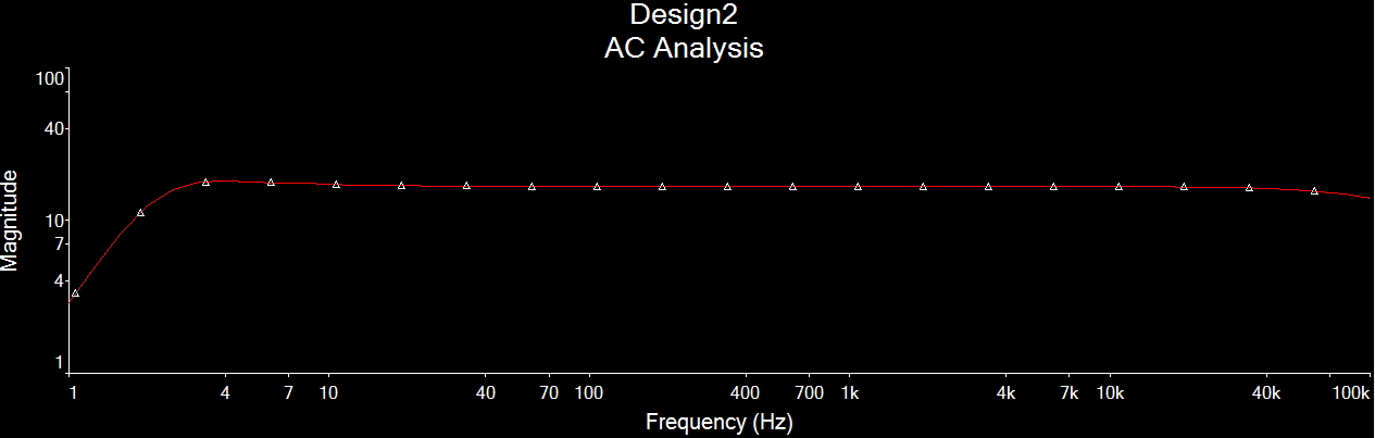

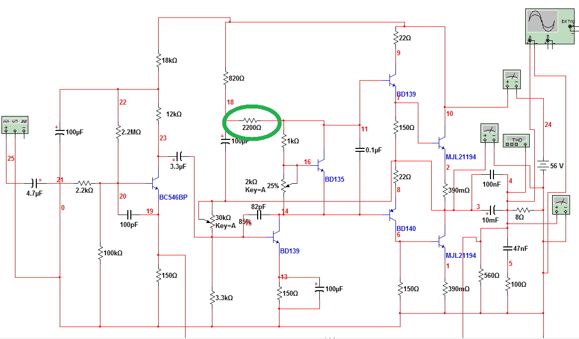

This one may sound very good because the ratio in between third and second harmonic
Despite harmonic distortion is very high (0.5%) at 18 Watts RMS output (8 ohms) it may sound very good, because flat and because the harmonic distribution.
Harmonics, compared now a days is huge... 250 times bigger...but this produces nice effect too.
We use to worry a lot..but speakers, itself, already produces much more than that in distortion...so...the exercise of harmonic reduction is just academic.
What means 0.001% distortion compared to speaker 1 percent?.... you just do not listen the amplifier quality...you listen the speaker bad quality (all them are terrible!)
I have simulated....made a fast simulation, have adjusted only the green circle resistor that i found needed.
I have not spent too much time on it...i do think we can reduce this distortion tuning and tweaking this amplifier..distortion of 0.05% is possible and this will represent 10 times less than i could have...i am busy with other things, i have just made simulation because Sakis is an old friend..but you can do a lot on this circuit to make it even better.

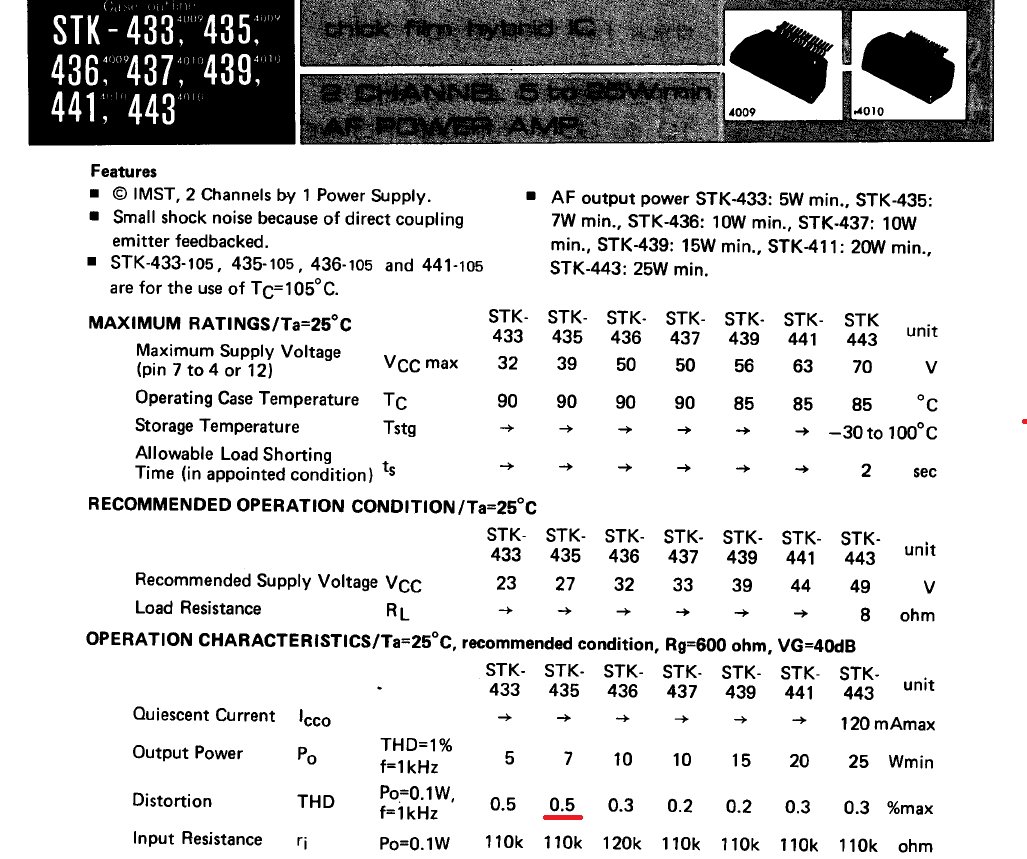

You see...this kind of circuit from the seventies, sounds nice
Despite distortion is very high.
Look it is the same circuit used into the STK435 audio amplifier integrated circuit..the one i am listening..the one i have published the picture.
Look the THD, and the schematic..almost the same.
Hammond organ produces a lot of harmonics and we love this!

Hi Sakis
Well, you have tried something different. Fantastic!
I think perhaps you could look at the trace connection "dots" of the output capacitors on the schematic, as Indianajo queries. It looks a bit confusing as to what is connected and what is not, though I'm sure DX has it right with a parallel connection for 10,000uF in his Multisim draft.
Congratulations and keep up the geriatric ideas - this one looks very interesting.
as about the resistor is a typing error it supposed to be 4K7 than 47K thank for pointing out
as about the output .... dont exactly understand what i ve done wrong but its supposed to be like that
output from transistors goes to a bank of caps
output of caps is feeding the output
while feedback senses from the output
while loaded with a resistor to ground
while accommodating a zobel in the output to ground
kind regards
sakis

Hi Sakis,
Look at the second 4,700uf output cap. The bottom (-) connection has no dot. (signifying no connection to the output). When there is no conflict, like a T junction, no need for a dot. For a X junction, it can be either a junction or a crossing.
So, to be obvious, it looks like only one 4,700uf output cap and another 4,700uf in series with 560R to ground. Of course, I hope I know better but maybe.... I don't? :D
