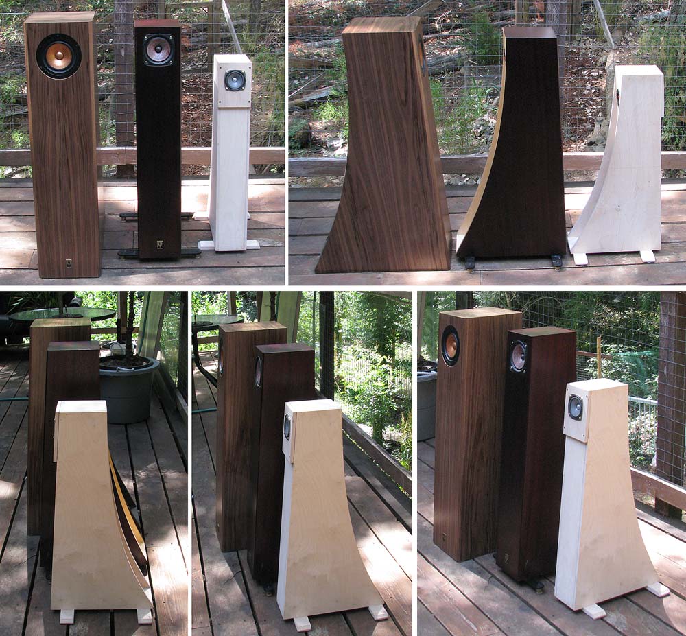

The 1st Frugel-Horn debuted in 2006. 4 years later in 2010 a much improved revision, the Frugel-Horn Mk3, was released. In 2013 a larger Frugel-Horn XL, and in 2015 a smaller Frugel-Horn Lite became a reality.
Today i took the 1st pics of all 3 together.
One of the design goals has been to be able to easily support many drivers in each design. The results have exceeded all expectations. The use of a tapped hypex horn with internal choke, after Olson, with the judious use of damping allows for all these different drivers -- adjust the damping for the driver, the room (& placement in the room), as well as your taste in bass quantity and away you go.
Scott Lindgren gets credit for the design of the current horns, Ron Clarke deserves mention for coming up with the curved mouth which allows a rectangular mouth to act more like an ideal circle, David Dlugos (me) for drawings & web-site, Chris Bobiak for blasting out prototypes, and the legions of diyers who have made these horns a huge hit. Cottage-industry commercial manufacturers & makers of flat-pak makers have popped up in diverse locations.

Those look fantastic. Especially that curved edge walnut(?) finish on the XL!
Must take up quite a bit of floor space .
Monty - yes that's Walnut on the XL,s quarter cut Sapele on the FH3s, and raw BB ply on the lites - rough sizes* are as follows:
FH Lite - 387mm D x 126mm W x 767mm H (15.25" x 5" x 30.25") shown with FF858WK
FH3 - 450mm D x 170mm W x 900mm H ( 17.75" x 6.75" x 35.5") shown with FE126E
FHXL -543mm D x 223mm W x 967mm H (21.375" x 8.75" x 38") shown with Alpair 10.3
* our builds / kits have standardized at 15mm ply for all panels except for 18mm for front baffles
-DIYers have used different thicknesses of materials, so adjust accordingly
- the first pair of FH lite prototypes were done in 12mm (1/2" ) ply, because there was sufficient offcuts on hand, so would grow a bit in each dimension with thicker material
Now is as good an opportunity as any to invite builders who've not already done so to forward a picture or two of their builds to Dave for inclusion in a gallery at the FH website. As the plans for these are "freeware", I for one am curious as to how many have been built - with our own builds, and kits shipped domestically in NA, our own count must be close to 100.

As Chris suggested, FF165wk in FHXL. I'd add Alpair 10p. Others have tried drivers that might work, particularily if it is an SE 2A3, the Fostex FE166En, FE168eS. Bass will be sacrificed for midrange efficieny. I am sure there are others that have not yet been tried yet.
Chris has veneered these, but i don't yet have pictures.
With the Frugel-Horn Mk3, the usual candidate for a low power SET is the FE126En, a PP would open things up considerably. I'd personally give up some ultimate level and choose Alpair 7.3 (my personal favorite) or Fostex FF105wk or FE103 SOL.
Some people complain of some specific resonances in some of these drivers (particularily the Fostex). Around here we invariably use treated drivers, where the drivers end up more controlled.
