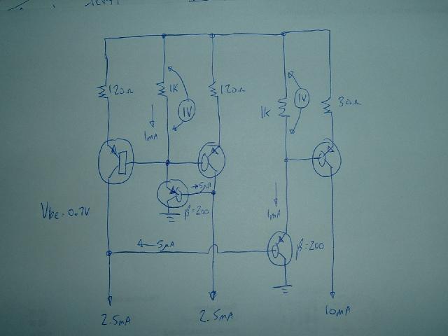

ostripper said:glen, you mean QX = Q8 (hfe) ???
Yes. If QX is the same type of transistor as Q8 and the 4.7k resistor is reduced in value so that the emitter current of QX is the same as that of Q8 then the base current pulled from each leg of the VAS will be equal.
However if you used an MJE350 for QX and forced that much current through it you'd hardly have an improved circuit.
You can buffer the VAS with an EF (ala D.Self) while using an identical device for QX. If the emitter resistors are selected so that the emitter currents of these transistors are equal, then you get the same base current drawn from each leg of the LTP.
Glen
Edit:
See attached pic. To simplify I am ignoring the current mirror transistor and VAS transistor base currents as they are negligible and I have assumed Vbe=0.7V for all transistors, but you should get the idea.

Good idea OS to get rid of that RC. Looking into the crystal ball of the simulator I spyed that was a source of instability.
If you don't like an EF on the VAS, changing the VAS to the 2SA1381 (as jaycee suggests, and me previously) will make a large improvement. This is worth doing.
You might want to run your VAS a tad cooler. It is running hot now for no good reason. Certainly if you do go with a less rugged device for the VAS you'll need to cut the current or kiss it goodbye.

ostripper said:1. changed C1 input cap to 2.2 uf bipolar (are el caps bad?)
better bass. Got rid of RC phase comp. across CM collectors
(why add another pole?)
2. I start the bias at 11mV across emitter resistor (50ma),
as amp heats up it goes to about 15mV, then when it
really gets warm it levels out at 17mV and sometimes
backs off a little.
Shut amp off, 11mV again after cooling. Does this sound
normal??
3. How do you get more gain from an amp ? Almost have to
overdrive my soundcard to get descent output.
1) Electro caps are definately evil in GEB land. That RC made no sense.
2) Yes that sounds normal, but 11mV isn't much
3) Increase the value of the feedback resistor connected between the output and the inverting input.

By GK - Well the thread starter decided to design in that inconsequential but controversial third current mirror transistor himself and seems to be intent on keeping it for some reason
As far as the buffered current mirror I might go the route
of a balanced diff. VAS which would eliminate the problem
entirely or go the self way and just EF the existing VAS to
at least minimize the issue. This all started with 1 little 2 cent
diode...
