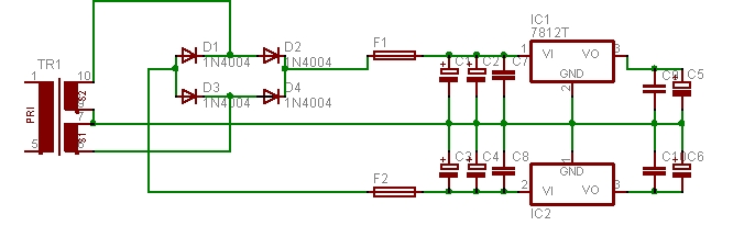

trafo is 2x12V and 2,25VA per secondary winding.
capacitors are 150uF-150uF-100nF before the regulator and 100nF-220uF after.
I tested the supply with a 4,7K and later a 1K load and it worked fine, then I connected it to the preamp and one of the regulators stopped working.
they are (+ - )12V and rated to 1,5A

Hi again, I built a powersupply using the datasheet for the 7812-regulators and etched a new pair of Mono-yardbird PCBs. I have 47pF on the cap designated CRF and on the RG I have 0,85R since I didn't have the exact value.
My casing is made of MDF with aluminumfoil on the inside connected to ground. Internat wire is unshielded.
The problem is a buzz combined with a sparking sound that is more or less constant. What should I look after to solve this?

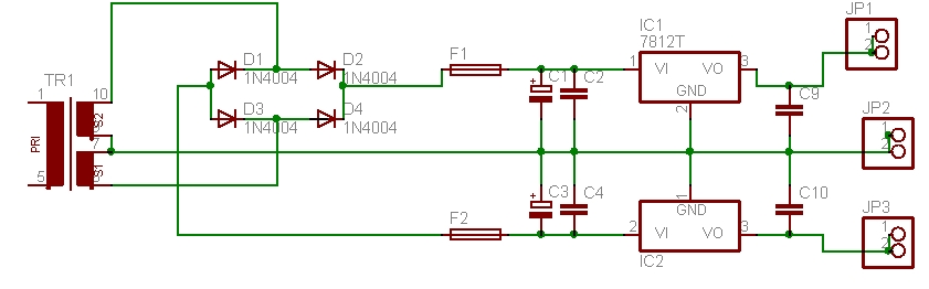

An update and some changes. I added 470uF between each fuse and the first capacitor.
So on the positive rail it's fuse->470uF->0,33uF->reg->0,1uF
and on the negative it's Fuse->470uF->2,2uF->reg->1,0uF
The positive, negative and common rail ends with a dual pinhead which connects to the two boards.
So the powerstarground is at the PSU-board and the signalground is as specified on the board. The signalground of each channel is separated from the common with a 0,82ohm resistor.
When the CD is connected to the poweramp directly there's no buzzing sound so it should be the pre that is the source.
Attaching a schematic of the PSU (one psu to two channels)

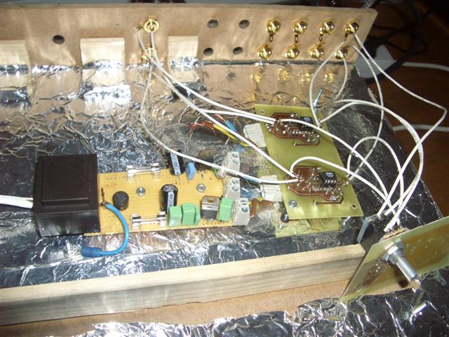

kmj said:I measured the voltage to approx 11,9V positive and negative. The layout is from the datasheet exept for the added 470uF caps, shouldn't it be good enough?
Attatched a pic of present setup, one channel disconnected.
Is it possible you have the opamps on the solder side?
If so they are upside down.
Not if you turn the paper upside-down when putting it in the UV-boxIs it possible you have the opamps on the solder side?
I managed to etch it on the wrong side and that's why the OPs are on the copperside, they are however correct. Forgot to mention it
