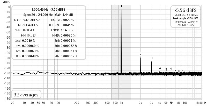

A coorection is due for post #59.
The plot shown was for 2.8Vrms output, i.e. +/-4V 1kHz.
This has been re-measured for 2Vrms output.
H2 is -94.5dB, H3 -102dB.
Especially H3 is quite a bit better.
Patrick

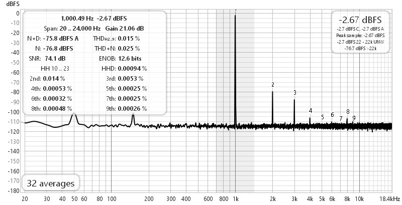

Next one to follow is the F5Pi frontend using 2N5457/5460 + FQP3N30/3P20.
As expected, distortion is quite a bit higher at -77dB H2 and -86dB H3 for 2.8Vrms 1kHz output.
Still comparable to the latest F5m, despite the very low transconductance input JFETs :
https://www.diyaudio.com/community/threads/pass-f5m.406472/post-7534522
The Spice simulation is actually quite accurate on H2 at least.
Patrick

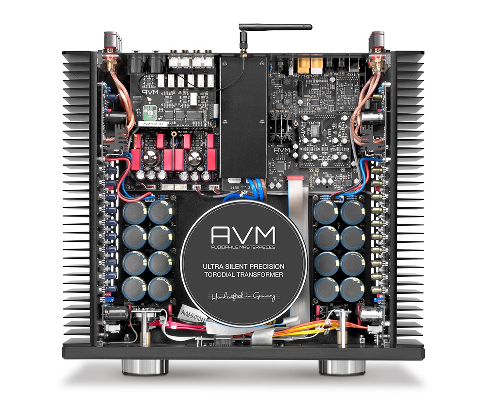

Oh, one more OT point if I may :
Looking at the above picture, the totally encapsulated toroidal transformer is maybe 150~160mm diameter.
It is claimed to be 1000VA. And I searched Toroidy for similar size.
Toroidy Supreme 100VA is 210x90mm, 500VA is 168x80mm.
So either they are using a toroidy with double the height (~160mm), or with much higher pearmeability material.
And then it says in the photo "handcrafted in Germany".
I wonder if that means that they don't use a winding machine, but thread each turn through the toroid with a bobbin.
How many hours would you need to make one of these by hand ?
And we already knew how much heat their heatsinks can dissipate.
:geek:

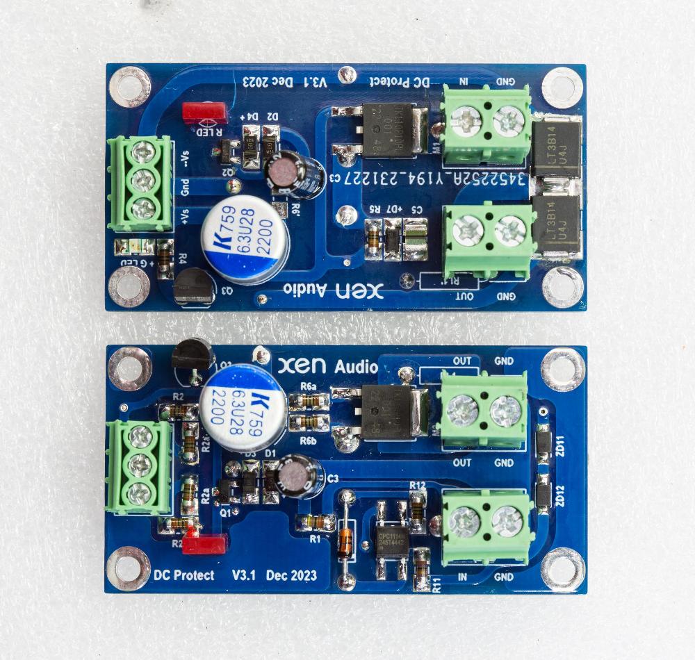

For the new year a further improved version of the speaker protection circuit of post #46.
https://www.diyaudio.com/community/...tage-perfectly-integrated.406024/post-7532667
Works first time.
The US version of the F5Pi above has a bit of DC drift from cold to warm (~100mV).
This is caused by the JFET pair 2N5457/5460.
So a DC servo daughter board has been designed and will be tested later as add-on.
Optional, without saying.
Patrick
