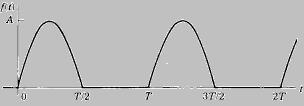

The minimum AC signal the DAC can swing is 1 bit positive to 1 bit negative. Anyone who thinks the signal below is a sine wave should be happy to give me a 20 dollar bill in exchange for a ten using the same rational. Any takers? I hope that doesn't leave the least significant twit in a dither....
Could you explain to me the reason why a DAC cannot swing from 0 to +1 LSB? Or the converse? My data books don't indicate that this is a restriction. Nor does the Burr Brown sheet you've posted.
The drawing you show does not represent what happens when you do the 1 LSB swing and then run through the anti-imaging filter. But I'm sure you knew that. Nonetheless, the comedic effect could give people the wrong idea.

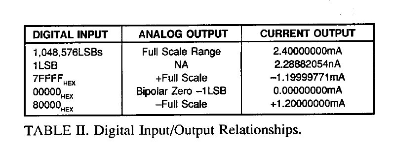

My turn to pour gasoline on the fire....
This is directly from the '1702 data sheet......the oldest DAC that I have data on.
I assume that we don't have any Second Class Telephone Sanatizers here, and that everyone can do the math themselves.
(I really love these food fights......livens up an otherwise slow day.)
Jocko

Jocko Homo said:
It shows that a 20-bit DAC does 120.4 dB. Which is 2^20.
So it follows that a 16-bit one should do 96.3 dB.
Jocko
Actually not. One of the first things we learnt in the introductory
CS course was the distinction between data and information.
Data is just a collection of numbers or equivalent, having no
meaining by themselves, like the DAC tables posted. Information
is data + interpretation, that is it must also include how what
the data means and how to interpret it. THere is nothing in
those tables saying what the dynamic range is. That requires
a definition of how calculate the dynamic range from the data,
and this very definition is what people do not agree upon here.
PS. the tables are, of course not pure data, but for the purpose
of dynamic range they are.
