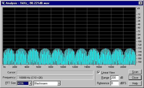

What on earth created that file? It's basically just a string of odd harmonics at the same level. Something you wouldn't even get with a periodic square pulse.

So much for trusting software. Hey, I am a computer scientist,
why don't you listen to me when I say you shouldn't trust a
program? :)

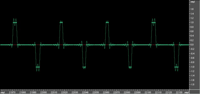

'It's not a difference between three possible output voltge levels and two. It's about a positive level and a negative level about the 0 axis."
'It's not a difference between three possible output voltage levels and two. It's about a positive level and a negative level about the 0 axis."
The Stereophile shows a 90.3 dB output as the smallest output voltage step from zero volts to a positive voltage followed by a transition from zero volts to the smallest negative voltage step. The smallest voltage output step being the smallest voltage magnitude change in response to a digital input word change. One of the possible DAC output states to a digital input word is zero volts.
Lets count on your fingers since I am not sure how many toes you have left.
1 ...... the smallest positive voltage increment
2 ...... zero volts
3 ....... the smallest negative voltage increment
It follows that the -96 dB waveform will contain two possible output voltages as it is half the amplitude and can only use the smallest output increment that the DAC will produce in response to a change in the input word to the DAC digital input.
That being:
1....... zero volts
2....... the smallest positive voltage increment
OR (but not both or you will be at the conditions for the -90.3 dB wave form above)
1....... zero volts
2....... the smallest negative voltage increment
In the COOL EDIT outputs in the following post
http://www.diyaudio.com/forums/showthread.php?postid=194988#post194988
You show three distinct out voltage states, The smallest possible out put from the DAC has 2 states. Don't drag out any subterfuge about DC offset or 1/2 LSB ......... two does not equal three! Put down your keyboard and calculator, hold up your fingers and count with me.
1.......2........3
When you demonstrate that you can count to three I will be happy to talk about logarithms and 65,535 discrete levels ............ (the DACs full scale positive voltage is the full scale negative voltage minus the smallest voltage step)
Or maybe you are, as John Cleese put it, arguing on your own time.

This is getting ridiculous.
GO READ A BOOK!
se
It shouldn't be necessary to read a book to see that the three
(or how many was it?) waveforms clearly differ, although they
all have three discrete levels. Since they are all encodings of
sines, they thus cannot have the same amplitude. Maybe the
confusion is about what we mean by theoretical limit. Although
I think about myself when posting my program and wavefom
earlier, it suddenly becomes obvious when looking at your
waveforms that I, and probably many others, have missed
something. The question should more properly be phrased,
what is the smallest signal we can encode and reconstruct
assuming a perfect LP filter. Or maybe this isn't quite the correct
phrasing either, but clearly the "duty cycle" (sloppily used for
ternary signal without defining it, but I think you get it) is
different for the three signals, which gives a modulation
(pulse density modulation?).

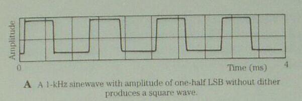

twos complement or threes insult?
I own the first and the fourth (all the fingers on one hand except your thumb) edition of Principles of Digital Audio.
I also have the data sheet for Burr Brown PCM56 DAC
http://katalogi.iele.polsl.gliwice.pl/en/download.php?id=4083
I will try again...........
DIGITAL INPUT (BTC) DAC Output ANALOG Voltage (V),
7FFF Hex +Full Scale +2.999908
8000 Hex – Full Scale –3.000000
0000 Hex Bipolar Zero 0.000000
FFFF Hex Zero –1LSB –0.000092
TABLE I. Digital Input to Analog Output Relationship.
92e-6 divided by 6 is -96.3dB
On page 41 of Principles of Digital Audio:
Figure 29 A shows the square wave generated by a 1 kHz sinewave with an amplitude of 1/2 LSB.
It has two values, there is no zero volt value as shown in the waveform under dispute in my previous post, other than the leading and falling edges of the square wave. I am thrilled to see you reference a book as I often do and recommend others do, but it does not support your premise of the wave form being that of the smallest signal possible, that with an amplitude of 1/2 LSB. Perhaps that page is missing from your copy? Shall I mail you a copy of this page?
