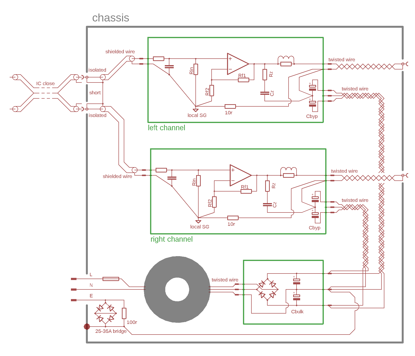

@ ilimzn : if I follow you correctly, that leaves us with the attached scheme which would be valid for most cases ? Or should I add a bridge from the RCA input gnd to chassis, so that everything has a low impedance path to earth in case of a major fault ?

@aparatusonitus : the rationale to sense the ground at the output connector of the pcb is coming from this page by Tomchr: LM3886 chip amp grounding.
On a properly laid out pcb, those two points should be close and linked by a low impedance track or a groundplane anyway.
It looks like chip amp layout and connection differs quite a bit from convectional discrete high power amplifiers! Normally we take the input ground at the quietest point possible, or in some cases directly to the main supplies. We return the speakers directly to the supply. We connect the zoble network (not in your diagram) away from the input ground, preferably on the opposite side the rail caps from the input supply and we take the feedback connection as close as possible to the output inductor.

@ jwilhelm: actually, a chip amp is just a quite classical amp in a very compact package. So pretty much everything applying to chip amps applies to any amp.
Btw, the output zobel is on the pcb in my diagram, see Rz/Cz, returning directly to the bypass caps.

Yes I see the zobel now. As I said your measurements are completely different to what I've normally seen, so something must be different in your situation. I'm not the only one seeing improvement returning the speakers directly to the supply and keeping the input ground quiet.
Well, obviously, this must be done properly. The connection between the speaker return, the bypass caps and the power supply ground on the pcb must be low in impedance.
Still, Tomchr is hardly alone in promoting such scheme. All the Hypex amps have speaker return to the amp. See for example the NC400 suggested wiring.
I’m curious, is it better to isolate the PE from chassis with the GLB (as shown here) or connect PE directly to chassis and isolate chassis from amp and psu circuit by the GLB (as done in the generic Pass diy psu and first watt builds)? Does it even make any difference?
The safest way to build your amp is to bolt the PE to the chassis close to where it enters the chassis. This way you have complied with the most important class I safety requirements. Then connect the 0V/ground of the PSU/AMP to the chassis via a GLB.
This provides a current path to PE in the case of a transformer failure.
Any ground wires from the transformer shields should also be connected to the chassis. These wires should be kept short as they potentially could interfere with the inputs.
This is what I’ve done in the amps I’ve built as well. The reason I ask is the diagrams in this post showing the GLB between PE and chassis. Though it is not clear to me that they are not essentially equivalent, assuming short wires everywhere, and the posts mentioned don’t really address the question.
