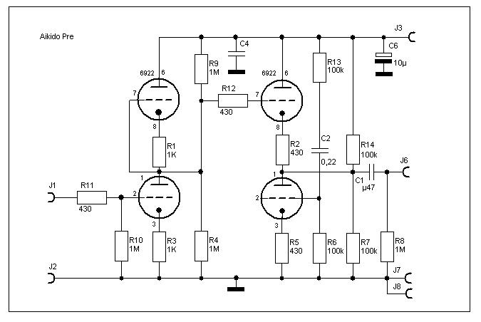

... I tried yesterday to exchange my Aikido linestage ( ca 10-15 db gain, using 4x 6cg7 tubes) with a Slagle autoformer box ( used as my pre for many years in front of SE 300B amps). ...
You could try re-configuring your Aikido as an Aikido Cathode Follower (ACF), which mainly acts as a buffer.
I did that by pulling out the first tube, the one that provides all the gain. The only thing that I then needed to do then was connecting the two connections in the empty socket where grid and plate of the lower half of the tube would have been going with a capacitor. 220 nF to 1 µF is fine, and voltage rating must be sufficient for the full B+.
in the attached schematic, the left socket would be empty, and the capacitor would go between pins 1 and 2.
Just try it ... it's an interesting alternative. It gives me enough gain in most situations (M2 into 100dB/W efficient Jericho Horns), and has about half the distortion of a regular Aikido.
Just remember that the regular Aikido is inverting, but the ACF is not ...

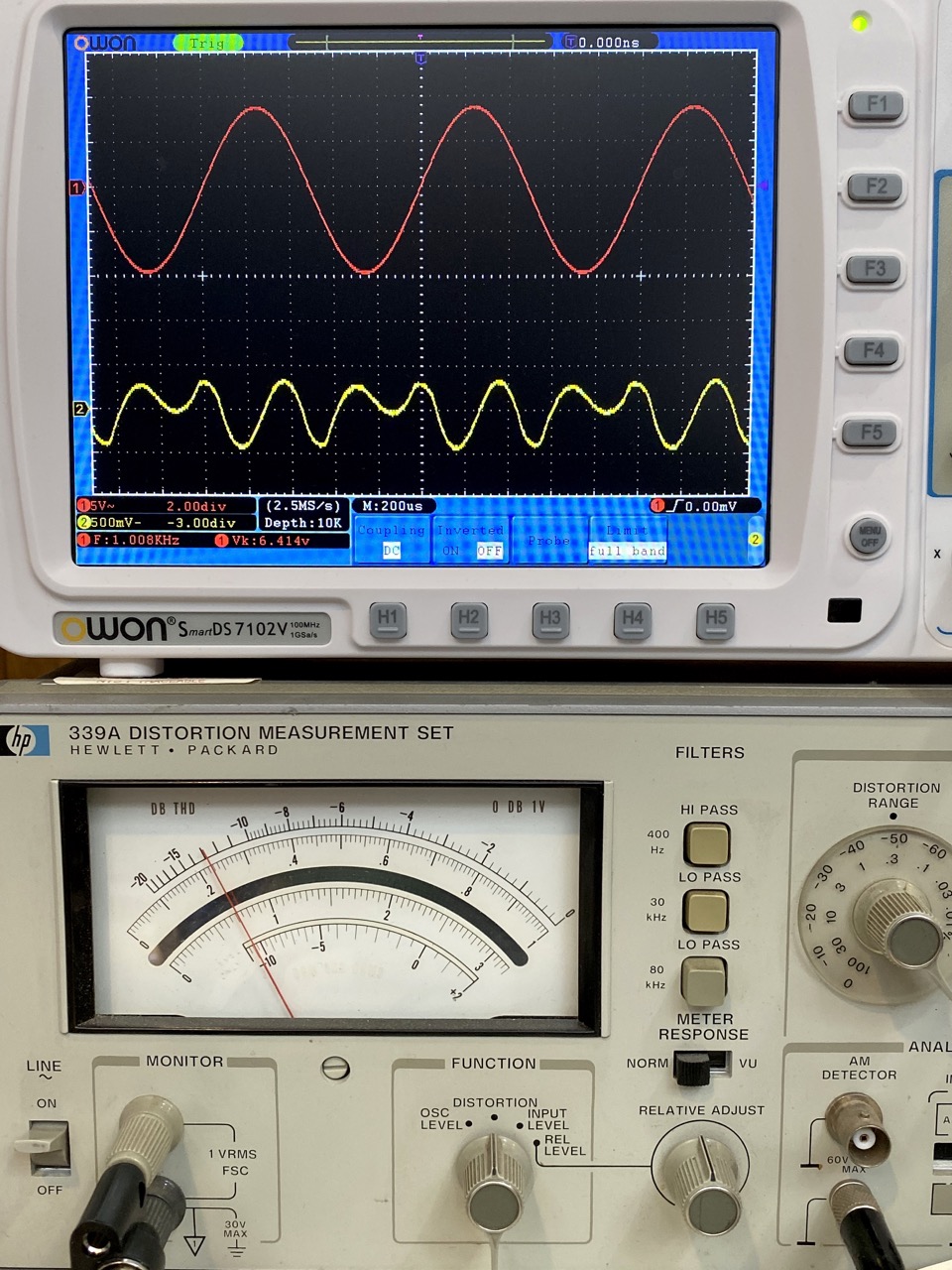

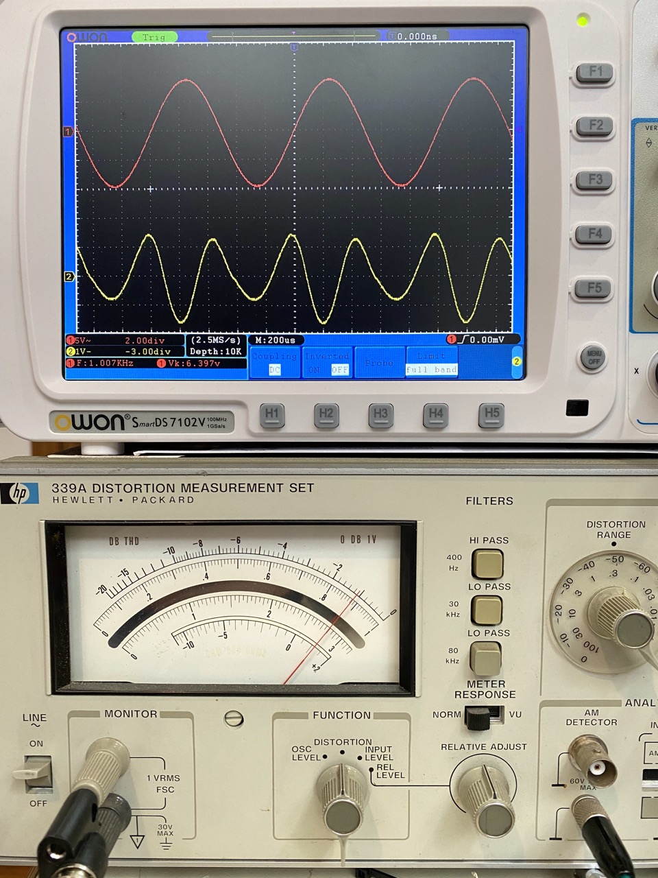

I finally got around to making the modifications to my F6 as suggested by 2 picoDumbs before the Xmas holiday. This involved adding a 0.1 Ohm resistor between the source of Q1 and the lower leg of C1. Now the R1 position totals 0.5 Ohms, and the R2 position is 0.4 Ohms, as before. The difference is the connection of C1. I used a basic metal oxide 5%, 1W resistor that I already had available for the 0.1 Ω value. This is all as recommended in F6 Amplifier
As usual, the amp needed an overnight burn-in to settle into the new configuration. To my ears, the difference was somewhat subtle in this morning's listening session. Yesterday afternoon, it was less subtle. Next I needed to hook the amp up to my distortion analyzer to see how it measures. The pictures below show distortion measurements at 5 Watts output power. The first picture was the original amp, and the second picture is the most recent mod.
At 5 Watts, the THD has increased from 0.07% to 0.28%. The distortion is now predominately H2, which is to be expected with this modification. At 1 Watt output power, the distortion is also predominately H2, but 0.12% instead of 0.022% from the previous configuration.
I probably need to spend more time listening to the amp before deciding whether or not to keep the modification. I am also still working through some tweaks to the bias current, so it might be interesting to see how that folds into the mixture.

I'm now listening to the new configuration. I had a couple 0.22Ω, 1W resistors available, so I soldered those in parallel with the 0.1Ω resistors added earlier. That makes 68 mOhms in this location. I also changed the gate stoppers for Q1 and Q2 to 120 Ohms instead of 220.Maybe try dropping from 100mOhms to 50mOhms.

After some adjustment and bench top burn in, the amp has settled in to 1.75 A quiescent current and < 10 mV offset. The higher bias definitely needs a longer warm up period before the amp reaches thermal equilibrium, but it's worth the wait. We seem to have arrived at a happy medium between being a little 'dry' and having too much H2. I haven't measured the THD, but may postpone that indefinitely, or until my curiosity gets the better of me..
There seems to be some "conventional wisdom" that the gate stoppers don't make a difference in how an amp sounds, as long as they are within a certain range. I would amend that to say the difference is subtle, but worth trying. In this case, with the last couple circuit parameters being dialed in through small adjustments, I'm glad I made the change. The enhanced bass response has tended to make my hotrod F6 sound a little dark. Reducing the gate stoppers has opened up the top end just slightly. I will of course continue to listen as the amp gets more play time, but the balance seems to be just right now.
