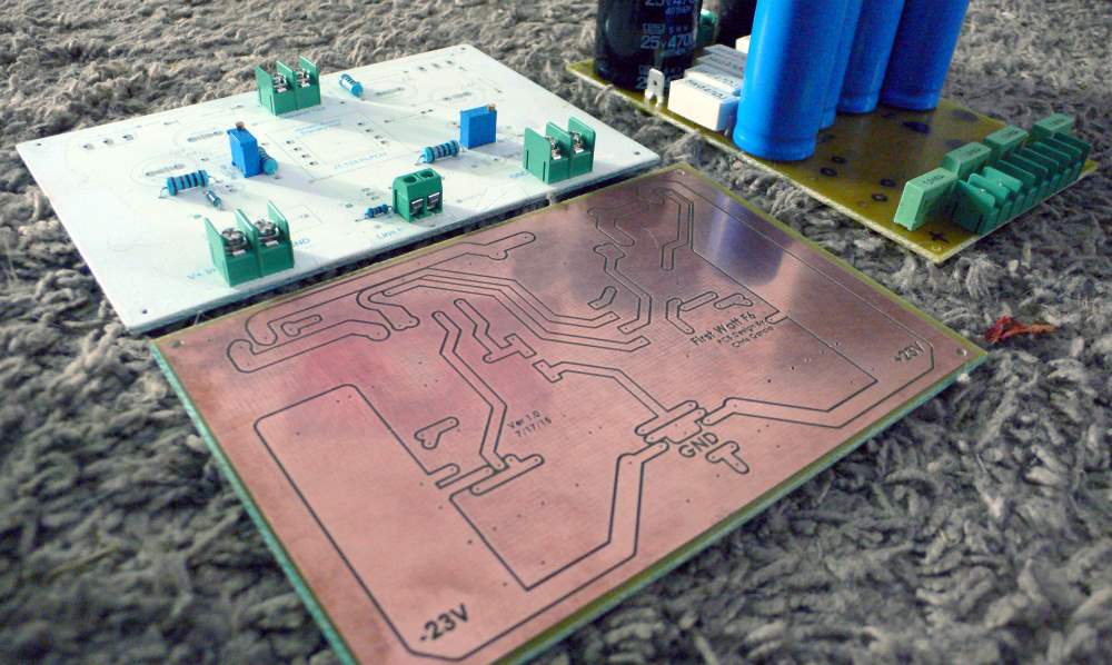

Hi guys, I recently started building an F6 pretty much from scratch. I made my own PCBs and stuff rather than using the ones in the DIY store. I just have a couple questions before proceeding with placing the parts:
In the (incomplete) F6 build guide a 9.1V zener diode and 110Ohm resistors in place of the 47Ohm R11/R12 from the schematic. Would you recommend that i proceed with the values used in the guide or the schematic? Does it matter?
Also, when I first apply power does the pot need to be set to a certain position to avoid damage to components?
Considering I built the PCB myself I want to be very careful not to damage any components if there is a problem..
This is the first time I've built an amp like this so i am kinda new to this.. If you have any other recommendations I would really appreciate it.

Here's a picture of the board I made..
Does anyone happen to understand why R11, 12 are 110ohm in the build guide while the original schematic uses 47ohm (I think he used a 9.1V zener instead of the 5.1V in schematic, as well?)
I've read through quite a bit of this thread and I can't seem to find an explanation so if there already is one I apologize, just please point me in the right direction. I am actually placing the components right now so I need to make a decision before I proceed.
The original F6 had those Semisouth power Jfets. Those did not require much voltage to get going. This diy version uses the good ol' IRFP240 mosfets which requires more oomph. Bigger gatestoppers just make for a better behaved amp, less likely to suffer parasitic oscillation.
Thanks for the response, however I am a little confused now. Is the schematic at the beginning of the thread
up to date and made for the IRFP240 or is there another?
It says mosfet, so it's for the IRFP240.
Those look like nice, heavy-duty boards.
How did you make them?
