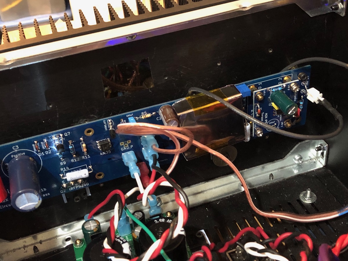

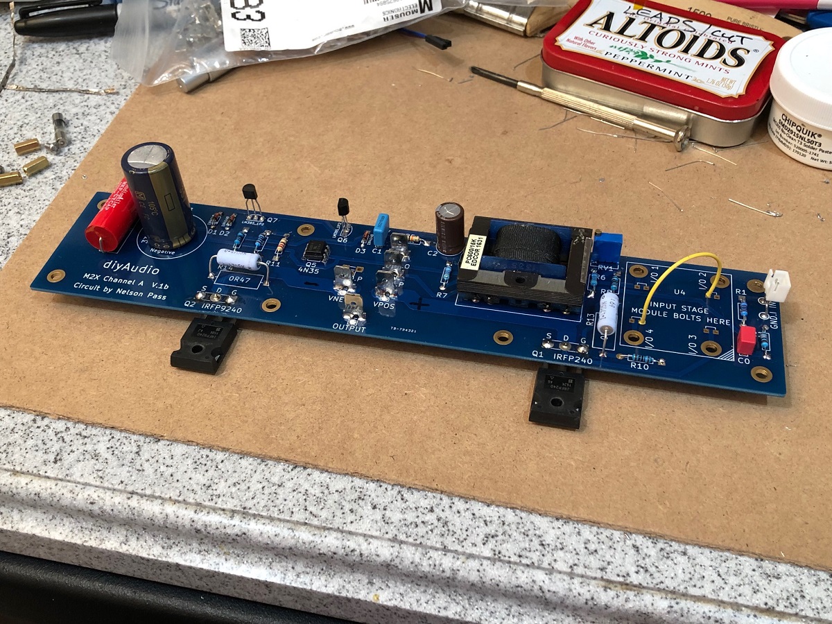

In preparation for testing the Melbourne daughterboards when they come in, I got an M2X board-set and built up the main board. Since I don't have any daughterboards yet, I just put a jumper from pin 2 to 4 and then will drive it with an external Aksa Lender preamp. I put the Edcor in though.
The DC offset is rather high and I could not get it any closer to zero than -0.187V. I seem to recall having to make R7 equal to about 56k on my previous Teabag M2 in order to get the offset to zero out - is that right? I am testing it out with a speaker and it plays music.
The 4N35, LM385, and MOSFETs are lifted from the Teabag M2.

Regarding offset-
The heretical modification you speak of is note# 3 on post #3:
The diyAudio First Watt M2x
and some discussion on offset adjustment beginning here:
Thanks, it looks like it recommends leaving R7 alone and changing ratio of R6 and pot. That’s more work but ok.

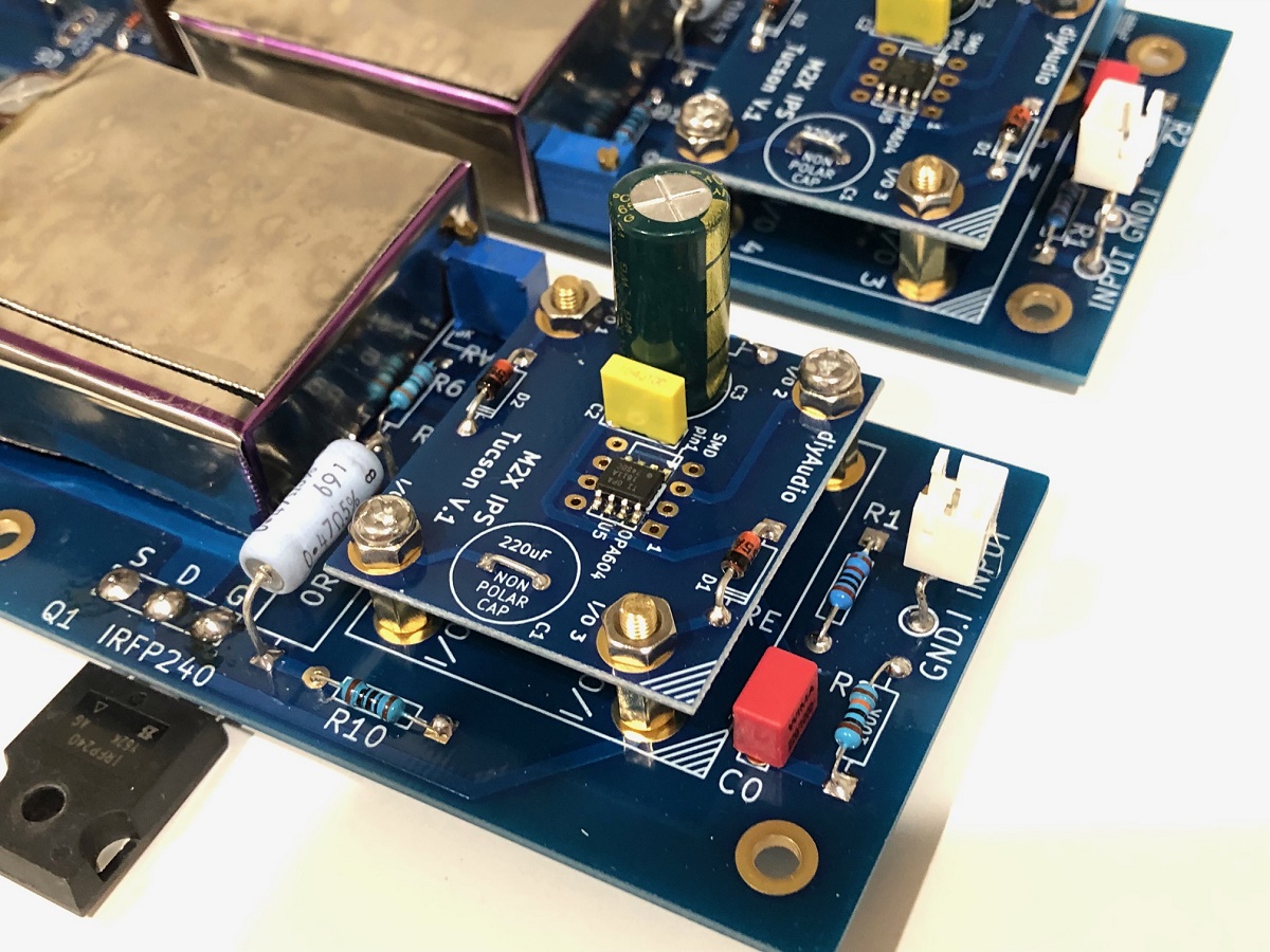

I have a question about Tucson bird for Mark Johnson:
Consider building two sets of Tucson boards. I don’t see any good reason why you shouldn’t build two Tucson boards with OPA604 thru‐hole opamps, and then build two more Tucson boards with OPA1611 SMD opamps. Listen to both in your M2X; which opamp sounds best to you? Check the diyAudio “Swap Meet” forums, there is probably a thriving aftermarket for individual M2X daughter boards. People buy a full set of ten daughter boards, use four of them, and then decide to sell or trade the others.
The spec sheet for opa1611 says +/-18v max supplies. Isn’t the power rail for the M2X DB’s +/-24v?
http://www.ti.com/lit/ds/sbos450c/sbos450c.pdf
I have a bunch of them and could try it out but for fear of blowing them out.

There's nothing heretical about it... :) I've found over the years and through building many of these amps (*) that Papa must have a full drawer of some pretty darn centered transistors, who's operating points are usually right down the middle of the specification.
Because of that, his amps don't need a ton of adjustment to get the offset and balance set and nulled.
But since everybody else building them isn't a jolly old elf with a direct line to Santa for parts, having a bit longer/wider resistance range for adjustment is very helpful for all builders.
(*) Thinking about it, my first F5 needed a ton more resistance to bias properly, the BA-3 needed an adjustment like this to give more range to the pot on the output stage, in addition to using a bigger pot on the input stage. The F6 needed a higher value zener than the original spec, etc... The reason for this has to do with the majority of these amps being direct coupled and the Idss of the input stage transistors in turn effects the voltages to get the Vgs of the next stage mosfets to turn on. This is neither bad nor good, merely the effect and interplay of your amp's particular transistors, and completely normal.
I.E., more adjustment range only helps the amp operate properly.

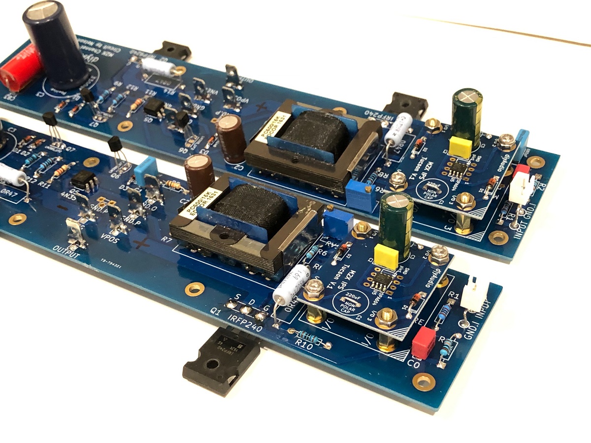

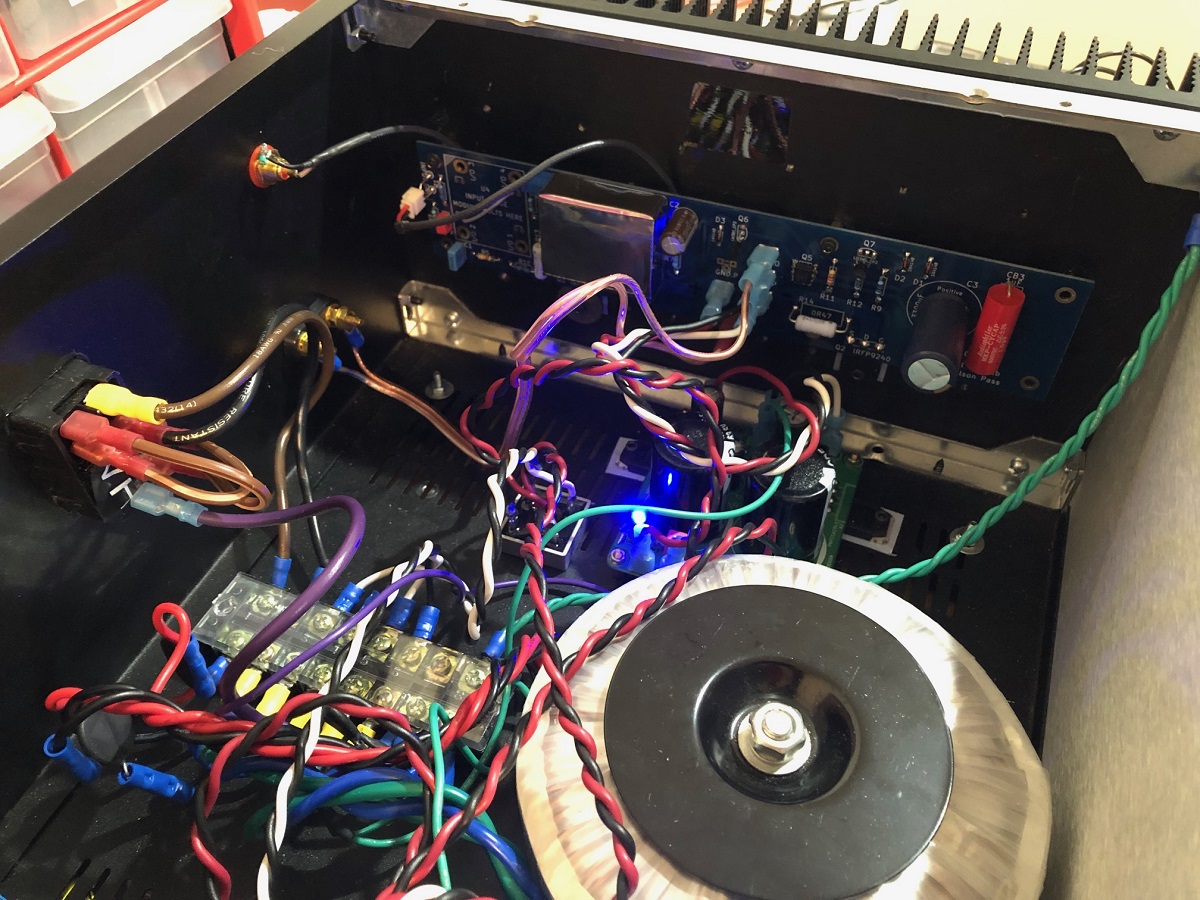

I went in and modified the DC offset trim setup with a 39k pot on R6 and 10k pot on VR1. I did not have any 20k pots left so hopefully this gets close enough.
I also wanted to try out one of Mark Johnson's DB's and decided on the Tucson since it looked easiest and I have OPA1611's on hand already. A tiny dab of solder paste and hot air gun and 6 other parts and they were done. I am DC coupling this opamp to the Edcor, hopefully DC offset should not be a problem. Now need to install back on amp. My voltage rails are only about 20.2v (due to sag and also 2v drop from cap multiplier supply), so I am using 4.3v Zeners. Should give me circa +/-16v rails for OPA1611, well within +/-18v limit.

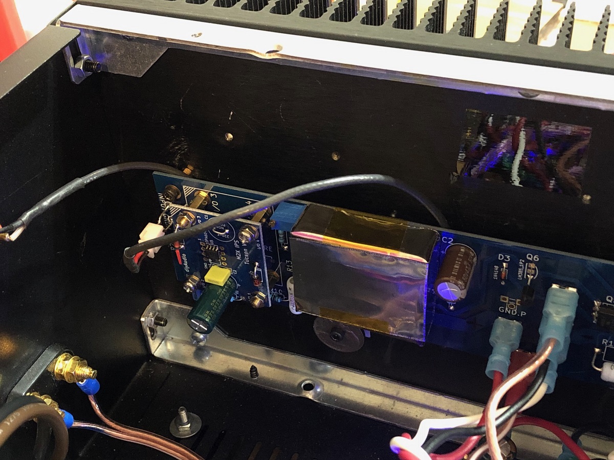

Did you post any info on the transformer shields? I like the look of them.
Yes, here:
https://www.diyaudio.com/forums/pass-labs/281520-official-m2-schematic-311.html#post5569239
Nitto No. 597B Mu-Metal (Ultraperm 80) sheeting formed into a 44mm L x 35mm W x 16mm deep rectangular cover, Self stick foil metal. Since I removed the Edcors from Teabag to this board, I had chance to add a mini belly-band across the bottom in addition to the box over the top. I put some polyimide tape (Kapton) on edges of foil band to prevent possibility of shorting with pins on Edcor.

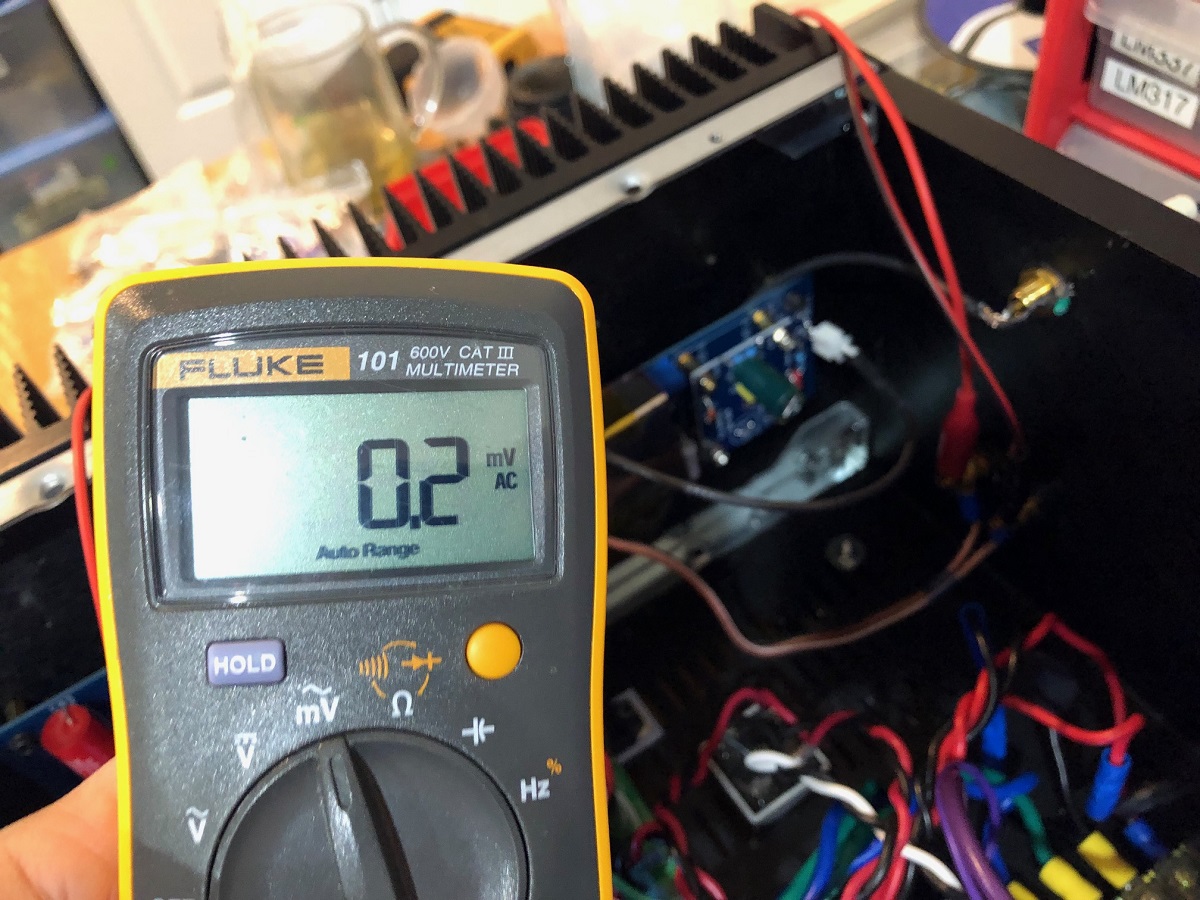

Testing the Tucson (with OPA1611 at +/-15.7v rails). It worked just fine the first time and it sounds very good. A nice ultralow THD and noise front-end reference based on the specs of the OAP1611, I am not sure something in a small low price opamp exists that is lower noise and lower THD. The noise measured at the amp output with source volume turned to off shows 0.2mV rms (on Fluke101). I do not hear any hum with one RCA connected but have hum with both RCA inputs connected. I suspect it is the single power trafo with dual cap multipliers for each channel is causing a 2mV at the output ground loop.
So I have verified that my M2X setup works with a DB, and ready to build and test Melbourne as soon as boards arrive tomorrow.

Noise measurment with FLuke 101:
attachment.php

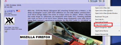

Hi 6L6: the dark art of including a link to a diyAudio post, which works for ALL members, even those who view 50 posts/screen or 100 posts/screen, is challenging and obscure. But I lay claim to having grasped it, at least this once, and here you go. It is a link to post # 3110 from 09 October 2018:
Mu Metal Boxes
Notice the insulator which prevents box-on-TeaBag-Board from shorting to rear panel.
Joined 2011
(Right click the post number in the upper right corner, open post in new tab, copy that new URL, right...?)
Almost!
The trick is NOT to open the post in a new tab.
The trick is to select a different option when you right click the post number in the upper right corner.
Select the option which tells your browser "Yeah, it'd be great if you'd copy this web address into the paste buffer". Four different browser examples are attached below.
Then use the contents of your paste buffer to make a link on diyAudio.
