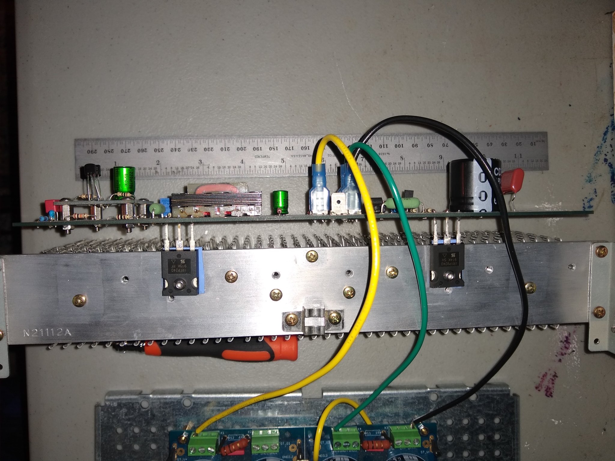

I've finally tried one channel of my M2X with an Ishikawa attached and no speaker load.
On the plus side, I was able to get the output offeset to <10mV.
However, the lovely salvaged, skived heatsinks (from a Carver 900 "The Receiver") don't appear up to the task.
Specs:
* 47V rail-to-rail
* Id appears to be 1.32A
* Thus the two IRFP(9)240's are emitting ~60W. Or I don't remember well enough from EE 101.
* Power transistor temperatures measured with the thermocouple that came with my "Neoteck" DMM. It registered ambient temperature as 20C
* Temperature at the top of the heat sink is 52C
* Temperature at the base of the Drain pins is about 190C
Is this too much to ask from these Vishay IRFP(9)240 transistors?

dliscomb,
By 47V rail to rail, you mean +23.5V DC on the positive rail and -23.5V DC on the negative rail?
With +/- 23.5V DC rails and 1.32A bias, you should be getting around 62 watts of dissipation - so you are close enough with your calculation.

uh... yes?190c on the drain pins??
I mean; I'll check again today, but that's what I wrote down yesterday.
Holy crap.
I was hoping that was a typo from 90c, which is already much too hot and not good. But 190c? (375F) Wow. Have never heard of one running that hot.
The heat isn’t getting out of the device. So you’ll need a fan in the interim, and bigger heatsinks in the long term. This is at least half again the heat of mofo, so depending on how hot your mofo gets, you’ll need to determine what additional size you need.
Out of curiosity, what are you using for thermal interface on the mosfets?

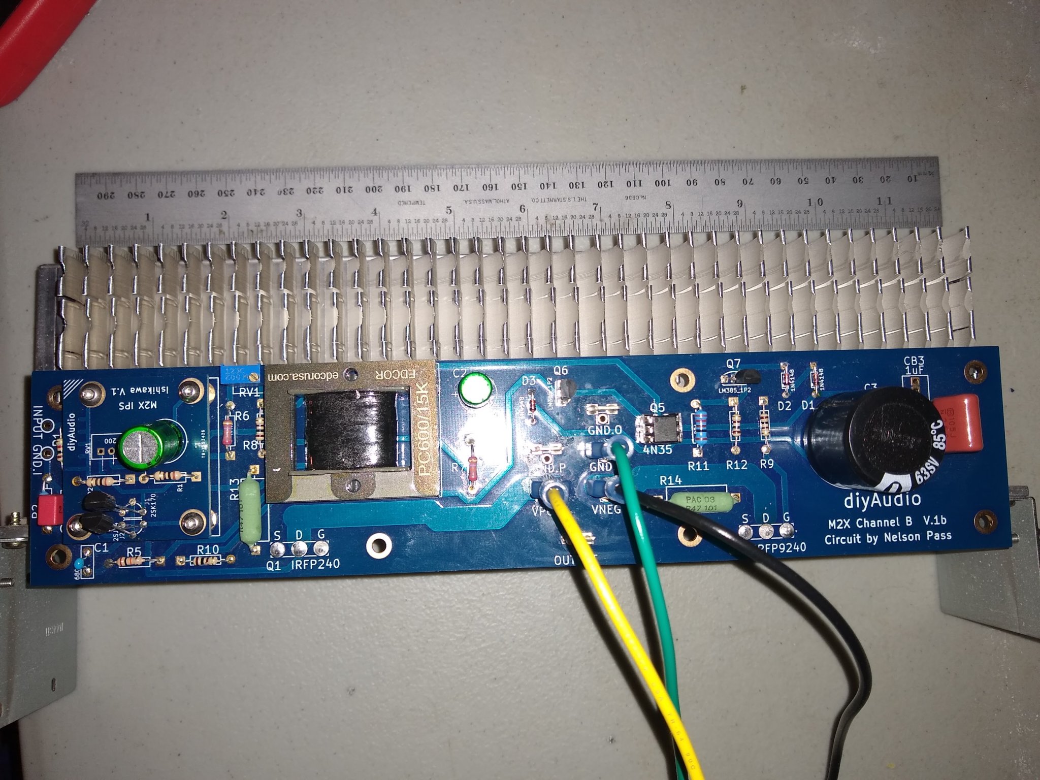

That board looks quite nice, btw. Good soldering.
You really need the lock washers on the daughterboard hardware. It will loosen without them. (Thermal cycles are strong)
The heatsink is teeny and the blue pads are not very good (obviously) at moving the heat. I’ll send you some keratherm, check PM.

Thanks very much; I enjoy the process so I don't try to rush.That board looks quite nice, btw. Good soldering.
Yes re: lock washers; this is only a testbed setup, not intended as the final product.
Luckily, it seems the pads do the job of "electrical insulation", but apparently not up to the M2X requirements for "thermal conduction".
Many thanks for the kind offer!
Kind regards,
Drew

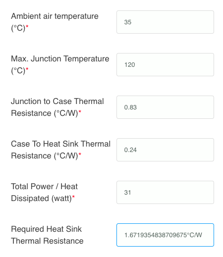

Luckily, someone else on the Internet helped out with a heat sink calculator.
If the worst case is that it's 35°C (I don't have A/C) and the "Max. Junction Temperature" parameter below is allowed to get to 120°C (specified maximum is 150°C), then I'll need a sink for each MOSFET with thermal resistance 1.672°C/W.
Other resistance parameters taken from the Vishay specification sheet for the IRFP240.
