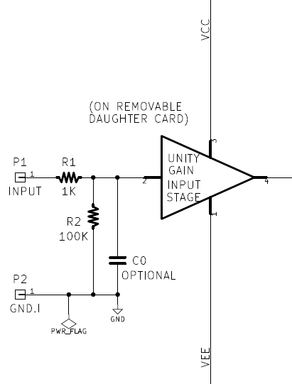

Can all these daughter cards be used as a stand alone buffer preamp? I kind of like the sound of Mountain views.

Maybe a buffer preamp might need an Input Stage daughter card and also components R1, R2, C0 from the M2x main amplifier board. This would depend upon the implementation details of the rest of the preamp, such as input selection, volume control, stereo/mono switching, muting to prevent turn on/off thumps, and so forth.
Please feel free to select component values and/or part types however you wish. The hobby is, after all, Do It Yourself audio. Want to change the low frequency roll-off? Do it! Want to get rid of the MV5075C red LED in Mountain View with its super annoying "Do Not Substitute!" directive? Redesign it! Do it! Do you prefer a TI video speed buffer chip for Norwood, rather than the Harris HA5002? Change it! Experiment and have fun.

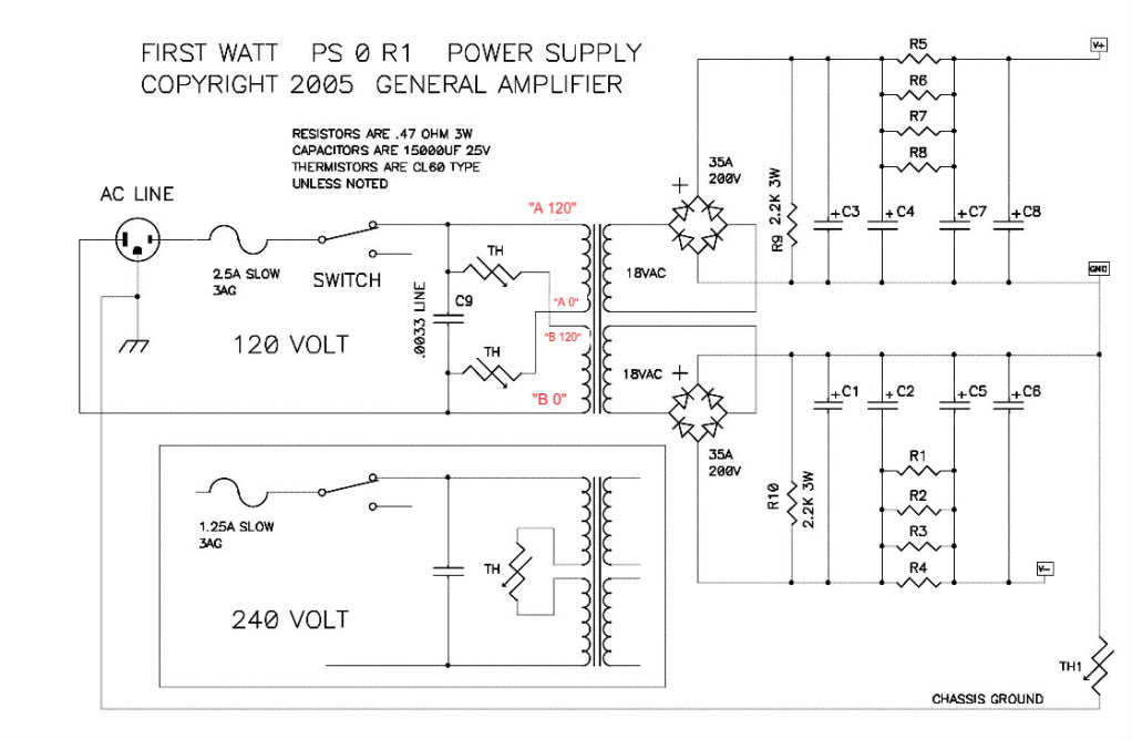

as this would be my first firstwatt amp i have a few questions regarding the power supply. how much power do i need for each channel? would it be appropriate to follow one of 6L6's build guides (f5 for example) and build the supply accordingly?
i noticed that in the build guides often diyAudio Psu boards are used without the discrete diode bridge. instead bridge rectifiers are used. whats the reason to choose one over the other?
To build a suitable power supply for two channels of M2x amplifier you need
The schematic of the power supply that Nelson Pass / First Watt installed in the M2 amplifiers he sold to paying customers, is attached below. It specifies electrolytic capacitors rated 25VDC but I admit, the ones I bought for my M2x build are rated 35 volts. I like a big safety margin, myself.
I use GBPC3510 bridge rectifier blocks in my M2x build, because I like bolting them to the chassis floor for heat dissipation. I also like the safety margin of using 35A rectifiers when 8A would have been enough. I happen to approve of transformer snubbers* and use them {2C,1R topology} in my M2x supply, but others feel transformer snubbers are a waste of time. To each his own.
Good old 6L6 enthusiastically recommends the Universal PSU boards sold by the diyAudio store, and in fact that's what HE used to build HIS M2x. You can view post #2 of this thread to see nice photos of his M2x amp. If you look closely you can spot the bridge rectifier assemblies in his M2x, bolted to the chassis floor, partly obscured by the orange wires and the yellow wires.

- A 300VA mains transformer with dual 18VAC secondaries (Antek AS-3218 (link))
- Rectifiers rated 8 amperes or more, continuous forward current
- Suitable electrolytic capacitors

Thank you very much for your time to explain!
Could one also use the rectifier part of the diyAudio PSU board instead of the bridge blocks you recommend? In fact the bridge blocks seem to be more *plug and play* and thus more appealing to me - just curious why one would choose them instead of the other option.
Regarding snubbers i yet have to research what they actually do before i can decide whether or not i need them . i'll search quasimodo.
nelson pass seems to specify 15000uF caps, seems like a lot of people use 22000uF - a matter of more is better?
