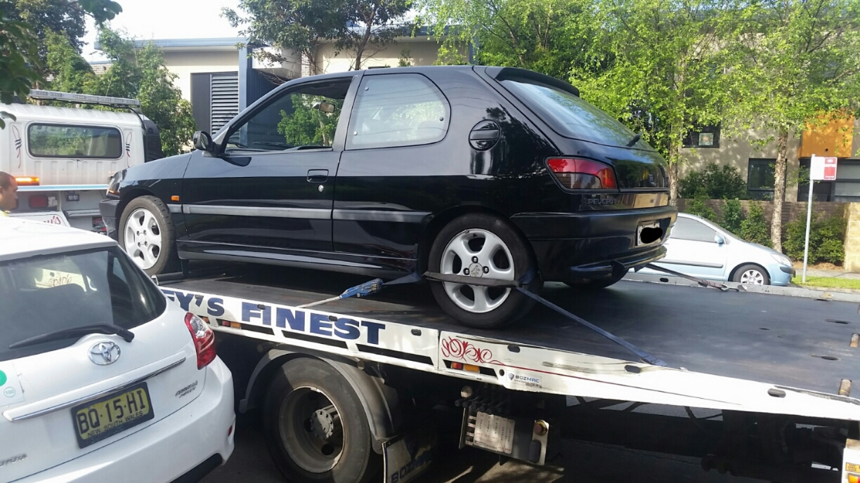

The second car is a 1995 Peugeot 306 S16 which I got in 1996. It is currently in the doghouse, and I'm not driving it again till I get a new ignition barrel (spring failed and I was driving it (returning to ignition position after starting manually) however on Thursday the key went to the start position whilst I was driving and I didn't notice, burned out the wiring to the brush on the starter motor, car stalled and I couldn't restart so had to be towed home. I'd just put a new alternator in at $550 and had spent a small fortune at the mechanics getting some oil leaks fixed as well as other overdue items attended too.

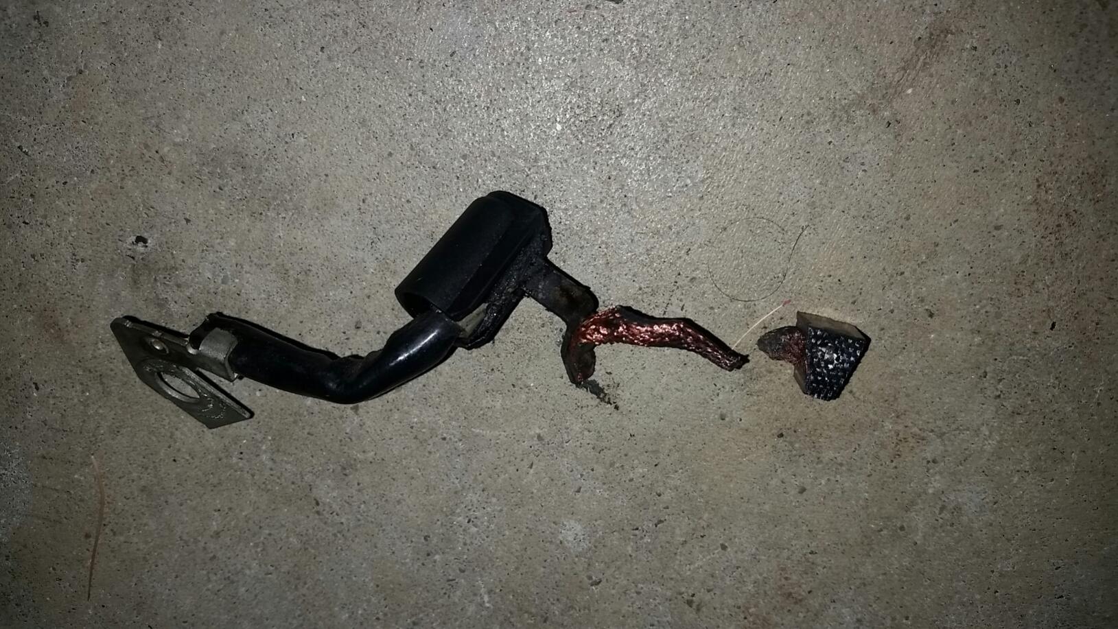

This one actually burnt through the brush wire on the positive brush. but before it managed to do that it pretty much toasted all of the insulation on the windings!
Luckily I had kept the old starter motor which failed because the magnets unbonded and collapsed onto the armature. I swapped the armature over and one quite worn positive brush and it lives (note that I initially only changed the brush, until some good advice to check the armature!!)
edit: attached pic of the amatures, original 23yo one on the left. The one the magic smoke was let out of on Thursday on the right.
Edit 2: added pic of brush and the car on the tow truck. Note that the fibreglass on the end of the brush should be white. The ones in the 23yo starter still were. I think it got pretty damn hot. I also suspect that the black ring at the top of the armature on the right should be the same colour as the one on the left....
