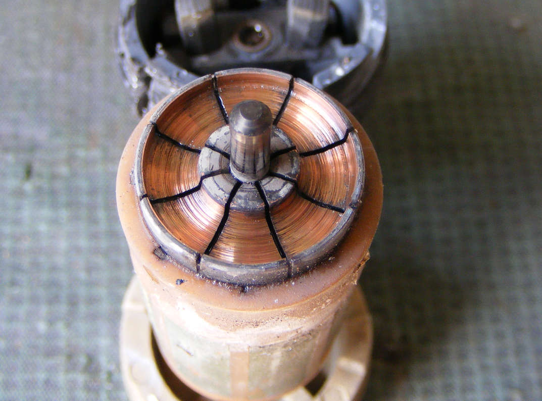

Not if the commutator is clogged up with old brush material.If the conductive path is through the carbon brush, doesn't it suggest that the brush is not worn down or the high resistance is elsewhere? i.e. short brush should be less resistance, since there is less material to resist?
I trusted it to measure other devices on the car and it measured accurately down to 0.3 ohms on the ignition coil.Assuming a DMM is trustworthy at measuring these very low resistances. I don't know the answer to that.

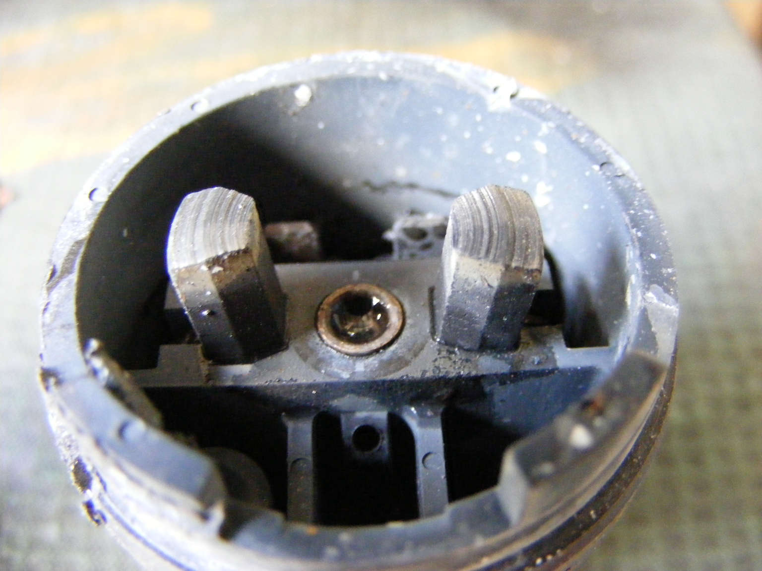

Insufficient contact pressure (due to old age/wear) on the commutator from the brush springs being worn out and excessive communtator/brushes wear is my diagnosis.
I cut apart the fuel pump and destroyed it in the process (RIP) however it revealed that insufficient pressure on the commutator/brushes assembly could be what is causing my intermittent misfire/stall problem. When I had the commutator and brush assembly apart in my hands I could vary the resistance measured on my DMM from 1.4 to 2.9 ohms by simply varying the height at which the brushes sit on top of the commutator. If the factory specifications state that the lowest reading on the fuel pump is 0.2 ohms and the lowest reading that I can get when pushing down on the brushes is 1.4 ohms then we more than likely have a problem.
Are you using a "Low Ohms meter"?
I'm using an Autool DM202 multimeter which is very accurate. Measures down to 0.1 ohms with accuracy, that is without jumping about.
