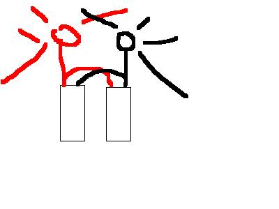

Here's a picture of how I intend to connect it all (I'm certain that I've connected the speakers right):
Questions:
1. Does everything look right?
2. Is it needed to cut off both wires to the solar panels when I want to charge using a normal charger? My switch is a 2 way switch so it can turn on/off on 2 wires.
3. I've just connected everything except the solar panels to one battery (the battery that is not directly connected to the amp) - is it safe?
Thanks Saturnus or anyone else who might want to answer. I don't want to screw anything up this close to the festival.
EDIT: I'm using the same 8V open voltage 5 W panels as Phaedras.
Questions:
1. Technically yes but with one caveat which I'll get back to under 3
2. You only need to cut the wire in 1 place to cut the circuit, I'd recommend a diode to ensure your batteries don't discharge into the panels though if it's not included in the panels but I think it is.
3. Not really. You connect all pluses to the plus on one battery and all the minuses to the minus on the other battery and then have thick cables connecting the batteries.

How do you intend to mount that many wires onto a single battery? I'm looking for a solution to doing that :)

So this is how I should connect everything? I hope I'm not being silly here.
Jep, thats correct. atleast for the batteries, i'm not sure how the on/off switches will work when set up like this, but i guess since there wont be flowing current when a switch is off anyways, it should work? :D
Actually, also when charging two batteries in parallel, you should put + on one battery and - on the other. I guess this is the same for when using the batteries. Thanks for the insight saturnes, seems like I will have to redo my power cables a little bit. I thought it only was when you charged the batteries.
Jep, thats correct.
The point is to get the batteries to act as one instead of 2 separate ones, and that must be done both while charging and discharging.
You can also do what I do and have a central connection point for all pluses and minuses.

I was thinking something along these lines aswell.. I was just wondering how to do it in practice.. how did you make it?

Soldering is the best wait to connect directly to the battery. You could always have a terminal of some kind soldered to the battery and then you just tighten some screws to secure other cables to the terminal.
I'd go with Saturnus's "common point" method. Using butt splices would work, or what I've done sometimes is crimp-on ring terminals held together with a bolt/nut/lockwasher and wrapped well in electrical tape.
For connecting to SLA batteries themselves, I use proper .187" or .250" quick-disconnect connectors. Around here, you can get a box with a crimper, wire stripper and a bunch of quick connectors / butt splices / etc for about $10 CAD at a hardware store.
Another thing I HIGHLY suggest - hit up an auto parts store and get an inline fuseholder, and fuse the + side of each of your batteries before bringing them to a common point. SLA batteries can output a LOT of current if they're shorted, creating a lot of smoke, fire, flying acid or worse. Something like this:

Here's what I just did:
Now I just connect the farthest one on the picture to everything that's minus and the closest one to everything that's plus, yes? Also: I soldered some shoes with branching ("forgrener" in danish I think) on the wires and put them on the batteries. They are pretty tight on. Now I can solder every other wire directly onto the branching.
So basically, just take all wires that go to plus and cramp them into a single butt splice and then do the same with minus? Or did I misunderstand something :)

Yes. I forgot that part. Fusing is vital. It could save your health or life.
