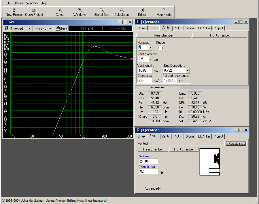

Does this look right? Is a vent length at 10,62cm feasible?
attachment.php
