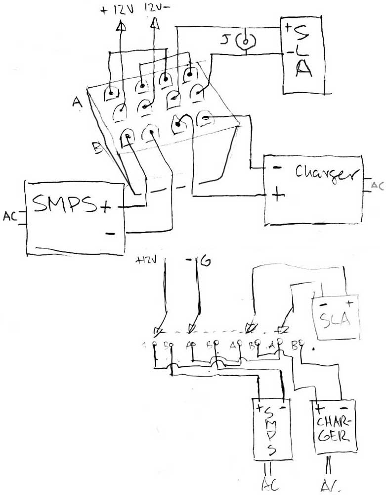

Running the battery charger while you are drawing power from the battery is not a good idea for a number of reasons. Wire a switch that when in one position charges the battery and runs the boombox off a mains-powered regulated supply, and when in the other position, the mains power is off and the amp draws power from the battery.
Wiring diagram is attached. Four-pole, dual-throw switch is required, at least the way I did it.

Oh that seems complicated... I think I will just discard the idea. However what solution do you have for switching between charging the battery and running the system? Seems complicated to open up the whole top everytime you want to change, or connect a mp3 for example.
Still wondering what kind of cable is used between amp and battery :S

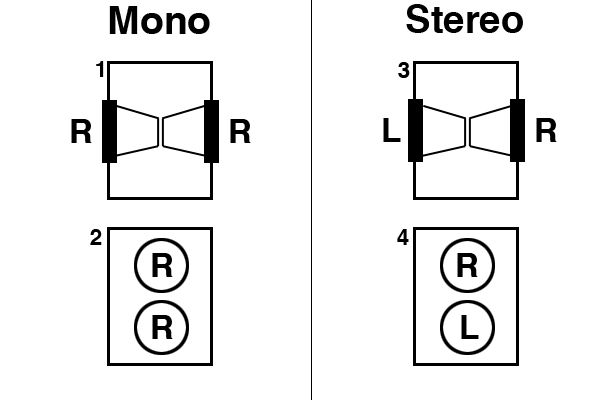

I'm planning on making half a boominator, mostly because I want to be able to wear it like a backpack and be really portable. And of course I want to use the HP-10W but since I'm only gonna use two drivers I have to make some decisions.
Either parallel the drivers making them 4ohm and mono or using them in 8ohm and having stereo. What do u guys think is the best choice?
The second choice I have to make is wether I want to have them bi-polar/magnet-to-magnet as Saturnus design, or both drivers at the same side. Won't the stereo be really messed up if I go for #3 in the picture below since I won't hear the L and R side at the same time?

Complicated? Complicated? This is DIY Audio. Everything is complicated! That's why we're here. Every time you figure out something "complicated," you learn something, which I feel is a lot of the appeal of this hobby. People who want it simple, just buy stuff.
If you hook it up as I describe, all you have to do is flip a switch to go between battery and wall power. Or, as Saturnus suggests, you may be able to find a battery charger that can do both.
As far as wire, it's really not critical. Maybe 14-18 gauge stranded wire. You can use really heavy gauge wire, but it would only be for macho pride or something like that, as no matter what, that amp is not going to draw a lot of power, so it won't need a big manly wire.
--Buckapound

Hey, I was looking to do something similar a while back, but I didn't manage to get beyond the ideas stage.
I quite like the look of number 3 myself.
If you go for the amp 6, then I guess you could parallel the HP-10w's, and use a single channel to power the HP-10w's, and use a separate channel for the tweeters also in parallel. THis may get a little complex however, as you would need an active crossover, but you could also combine/sum the L&R channels also if you did go for an op-amp based active XO. :)
Going active should give better sound quality however, and greater efficiency also, as passive filter components reduce efficiency in most cases.

Let's hope I make it this time ;)
Yeah, if I went with the drivers paralleled I was thinking about summing the L&R. Could you clarify what "op-amp based active XO" means? When using the HP10W and piezos I won't really need a crossover right? Or do you mean when I sum the L&R? Something like this maybe?
