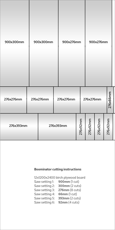

I made these cutting instructions for my local hardware store to minimize the risk of something going wrong due to a missunderstanding.
Maybe someone else will find it useful.
In total there are 19 cuts, some stores in Sweden charge by the cut (instead of for time). This means that the cuts would be 190:- at some places (10:-/cut) and 380:- at others (20:-/cut). Some cash to be saved for us cost aware builders ; )

Neat. Though you should note that it's not the most effective cutting you have described. Generally vertical cuts are done first (on a vertical saw). So you should change cutting 2 and 3 around so that no resetting is needed as some places charge but for cuts and saw resettings.
Also a board is 1220x2440mm.
I used to work as a CNC programmer in the woodworking industry btw.

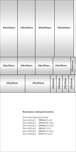

Updated the order of the cuts and removed the size of the board, Ive seen different sizes from different stores, 1200x2400, 1200x2500, 1220x2440. It really doesnt matter which size, the cuts will work on any of these sizes.
Suitable scale when printing on a A4 is 30%.
