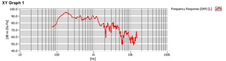

I have a question regarding the Zomax HP100. I've just finished building a Boominator clone and tested it outside this past weekend. I actually don't think the Zomax piezos sound very good. The sound is quite "dull", so to speak: there is not very much to give around 8-10kHz and there is some really nasty sounds around 4kHz.
Now, Saturnus, you say that these piezos sound much better than anything else you've tried, so I'm beginning to think I've done something wrong. The polarity is correct, and I'm using carbon resistors in series. Any suggestions on what might be wrong? Or maybe I'm just being picky =)

The answer is simple. It needs about 100 hours of playing time to "burn in" before the HP100s "open up". And I'd not call it "dull" to start with, just "unengaged". But that change completely after about 100 hours.
On another note though. The HP100s with the correct resistor as listed here will never sound like another piezo, simply because they are much better than any other piezo. When you really listen to them (after burn-in), you'll notice they play everything, even the highest notes without making them sharp or noticable in any way but simply be there, playing effortlessly, to be noticed or not.
And yes, definitely in-phase, otherwise there's no bass at all.

Ok, that might explain it. I've actually never heard of burn-in for piezos: I know it makes a huge difference for speakers in general but it didn't cross my mind that it's important for piezos aswell =) Guess I'll just leave them with some noise on for a while then =)
But still I'm a bit concerned about the HF-response... but you're saying that it will improve drastically after the burn in period? Because right now it's quite depressing. We did some measurements in a professional echo-free chamber using Brüel & Kjær mic @1m and the result is attached in this post.
As you see there are quite severe variations in the HF-response. Also there is some heavy distortion (3rd-5th) around 6kHz (not visible here though). Based on this maybe you understand my EQ cravings =)
