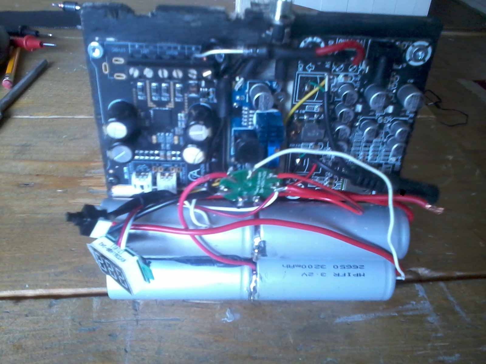

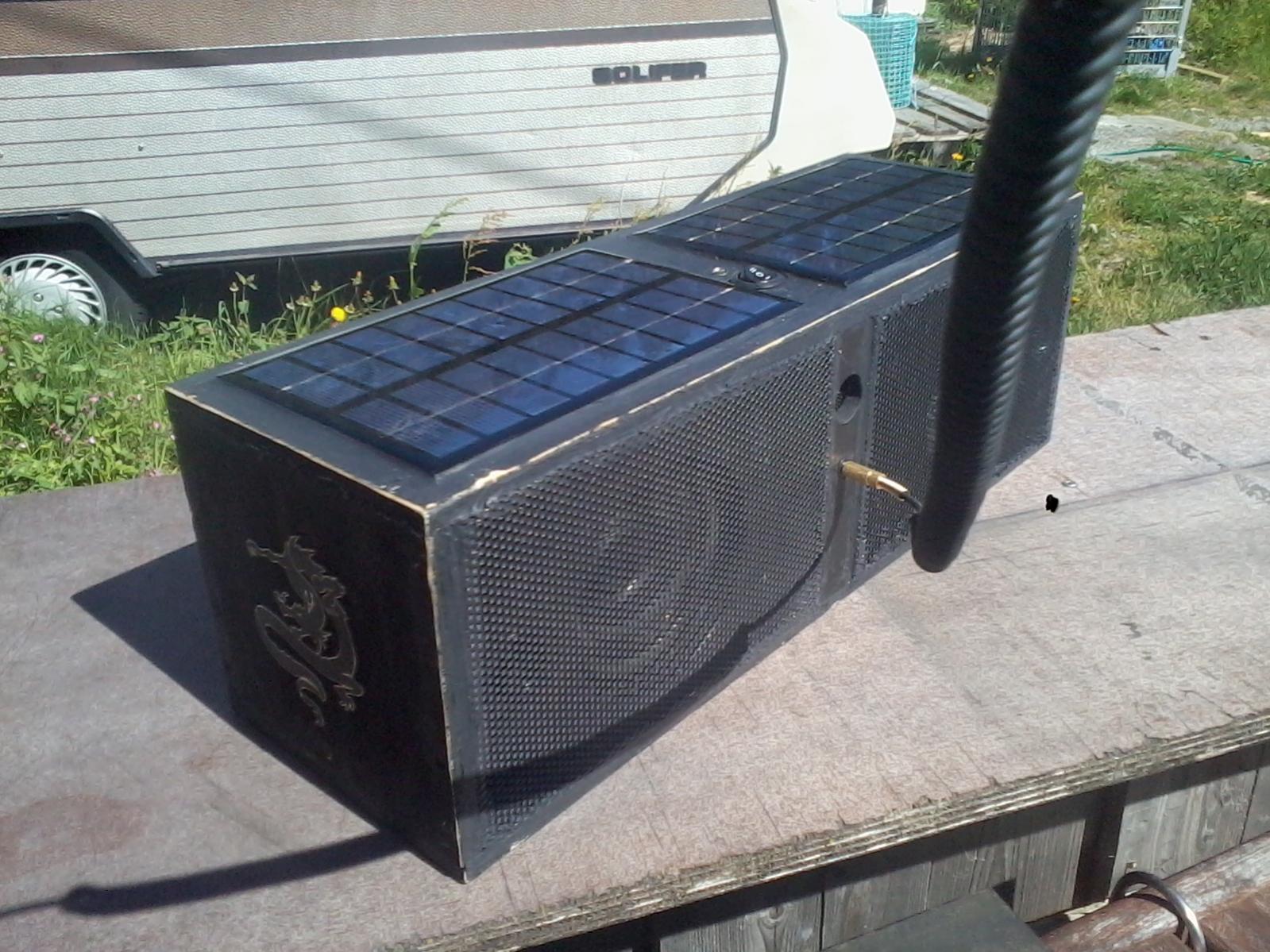

Boominator mini v2
Yeahae Yippi i just assembled a mini v2 for my brother, and of course Saturnus birthday. Wooow nice sounding and ******* loud!
I put it together with 9mm shitty pine ply i had lying around (not recommended) and adjusted the dimensions to ceep the speaker compartment and overall measurements as close as possible to the original design. Seems to work all well though :)
The Sure 4.0 bluetooth module gives a lot of extra gain, but also a noticeable noise floor (its dead quiet with cable). I did not lower the gain on the maxamp which maybe preferable when used with the Sure 4.0 bluetooth module. But since i also fitted a 3.5mm input for use with mobile headphone jack i needed the gain on the maxamp set on hi. Next time i will install a switch to lower the maxamp gain when bluetooth is connected.
However its a truly remarkable little machine and the noise floor from bluetooth is not noticeable outside when in use. I finished late last night and did some flickering on the leftover Tec 7 in the sun today before final clear painting. We had a beautyful sunny day and it was playing for more or less 6 hours. The voltmeter went from 13.1v this morning to 13.2 v when i got home, Perfect!
The electronics was a challenge, its not much space but i pulled it together:) I used an adjustable DC/DC step down converter set to 14,6v as solar and charge regulator. Lifepo4 and a small PCM module. I used two 3watt 9v 333 mah solar panels. They only work well in direct sun but thats ok they fit and work great:)
So thanks Saturnus i am getting addicted to these builds! The mini is amazing but a little tricky and time-consuming to assemble, so yes maybe not for anyones first build;) I am very happy to successfully pulled this build together!!!

Woah, nice! That's an amazing little electronics compartment :D!

Did you make the battery compartment smaller on purpose just to make it a little less wide ?
On the mini v2 no, i just needed to fit the cables on the side of the batteries and ceep the speaker compartment the right internal size. 9mm ply and all, i think i have 32 mm for the batteries and 2,7 for the electronics above. Overall outside measurements is still 15x15x45.
