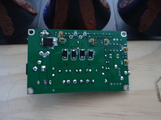

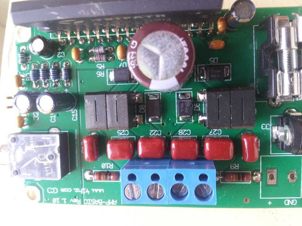

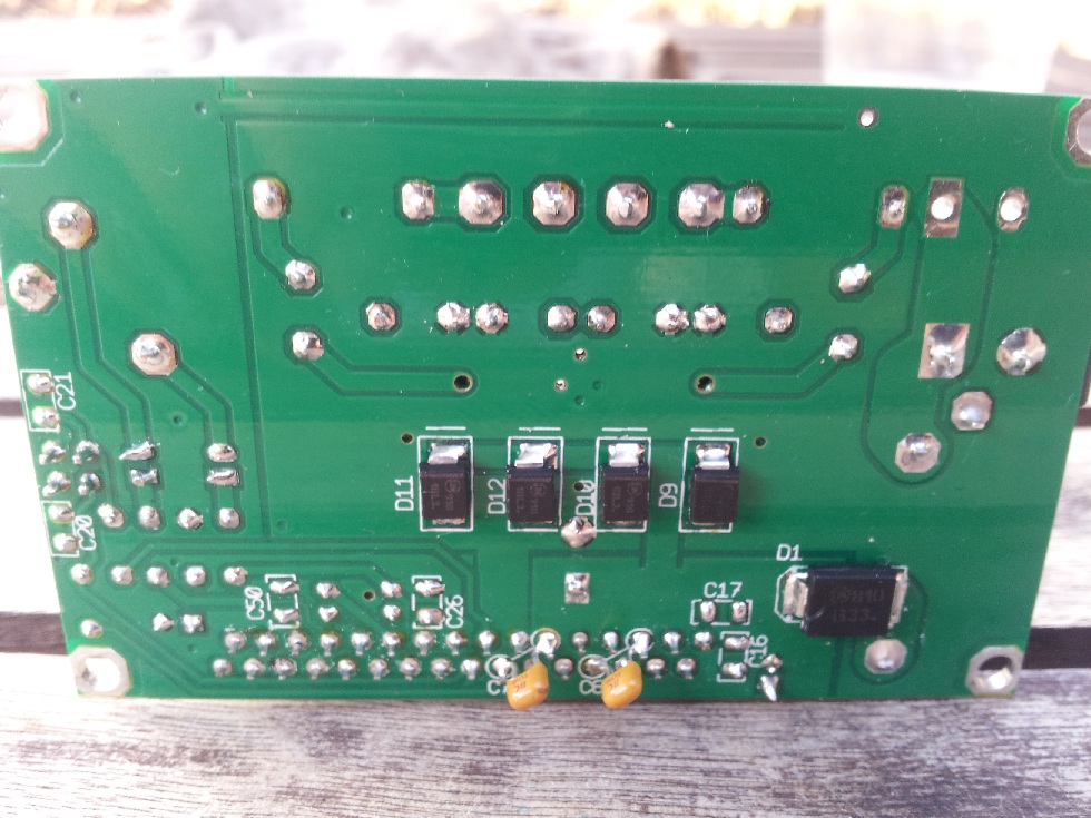

For the caps, yes i know , i am waiting for the wima's ones and i got some problems with C2, it fell down and i walked on it ... Don't work too late
My first DIY amp, i did not realized there were some CMS component, but okay by now, i found the good technic for this kind of component.
Thank you for remarks.

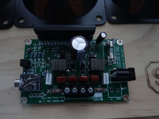

I'm at roughly the same stage as you nusma. Build pics coming soon.
Yesterday I was testing out my hardware with the amp6. All the speakers are working fine but im having trouble with the amp. The left channel only produces a very tiny volume. The right channel is loud and clear. After reading some posts on 41Hz, I have come to the conclusion that the tripath chip is fine and the other electrical components are very hard to damage. So there is simply a bad solder somewhere. I bought the amp pre assembled so I cant even blame in on my soldering skills.... I cant see any bad connections so my next move is to reheat all of the connections... Anyone have any better ideas?

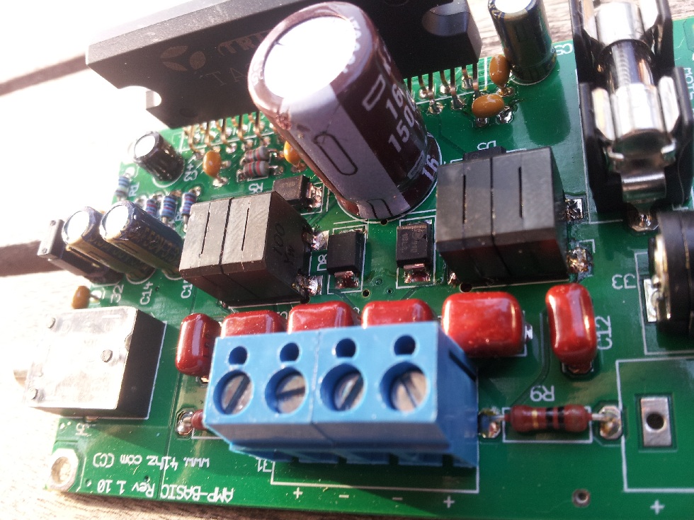

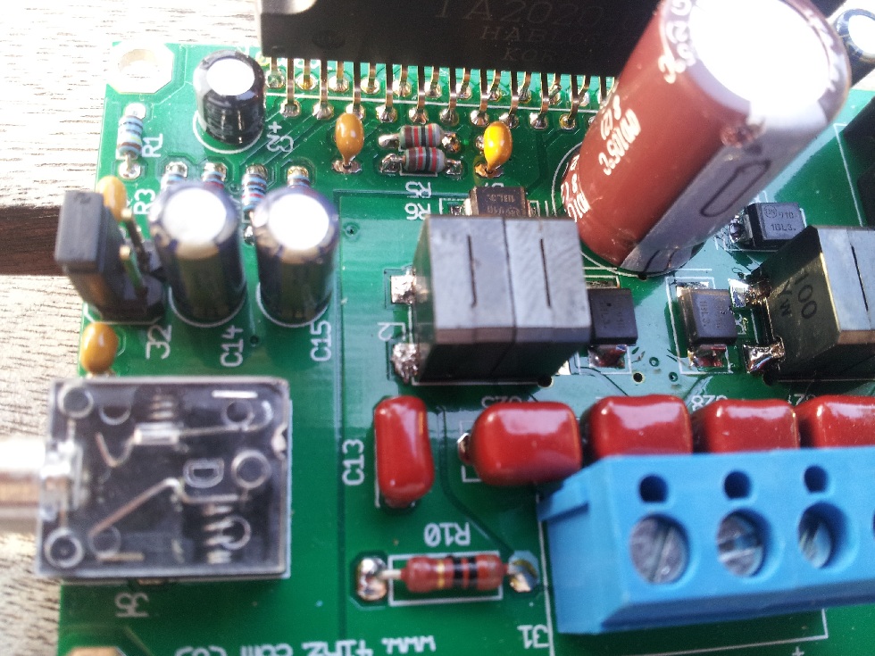

I'm not understanding how you can get output for it at all when the jumpers are not inserted correctly. Both jumpers should be in, and orientated the same way as the pin header, ie. turned 90 degrees from what it is in your pictures.
If there's still problems I'd advise going over the inductor solders as a few of them look a little suspect. Not bad but not perfect either.

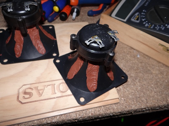

I receive the last parts for my amp6 and the resistors for the tweeters. But i have been reading more (and more) of this thread, and i have doubt for the ones i choose. Are these resistors okay for the tweeters:
RESIS.METAL 3 W PR03 47 OHMS - Elecdif.com
Thes are metal film resistors, not carbon composition... Does it matter?
Not much. As long as it's not wire-wound resistors it's fine.

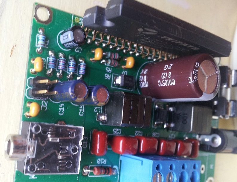

Hi!
I've been working on a boominator of my own and it's almost finished. Just gotta paint it etc.
Because i wanted to save some money i first went for the Lepai amp (Black LP-2020A+ Lepai Tripath Class-T Hi-Fi Audio Car Amplifier & Power Supply | eBay) but i found that it distorted well before it reaches the max volume, the bass in particular. I have also tried with one of these: Class T Amp 25Wx2 Amplifier Tripath TA2021 SMSL S | eBay and one of these:
Assembled TA2020Class T Power amplifier board 25W+25W | eBay
I have the same distortion problem on these two amps.
Does the problem occur because of cheap amps and can it be fixed by purchasing the amp-6?

Most likely cause is that the power supply is insufficient. The amp draws slightly above 5A peak at maximum volume so you need to make sure the battery or power supply can supply that.
And if it's a battery, make sure it's in proper working condition, ie. haven't been man-handled by repeated very deep cycles without immediate recharging by a dedicated charger for recharging deep cycle batteries.
Also the cables must be thick enough and the connectors of sufficient quality to handle the current. If length from power source is less than 1m/3' then 1.5mm2/16awg is ok longer than 1m/3' then they should be 2.5mm2/14awg.
Having checked all those boxes and it still distorts on bass heavy music then you can look into changing input capacitors on the amp so that the amp simply doesn't waste power trying to play deeper bass than the Boominator can play.
And lastly, also realize that in a perfect world you want your amp to start clipping/distorting at roughly 90% of max level from the source because it means you are using all the available power the amp can give with a little headroom for tracks that are recorded at a lower level. Simply don't turn up the volume higher than to where it starts distorting (it's quite loud already) although I know that can be difficult because the sound quality is so good that it is deceiving you to want more and more
Some people also take the final plunge and use a 24V amp instead to get that 5-6dB extra even if that means it'll use 4-5x more power in the process.
