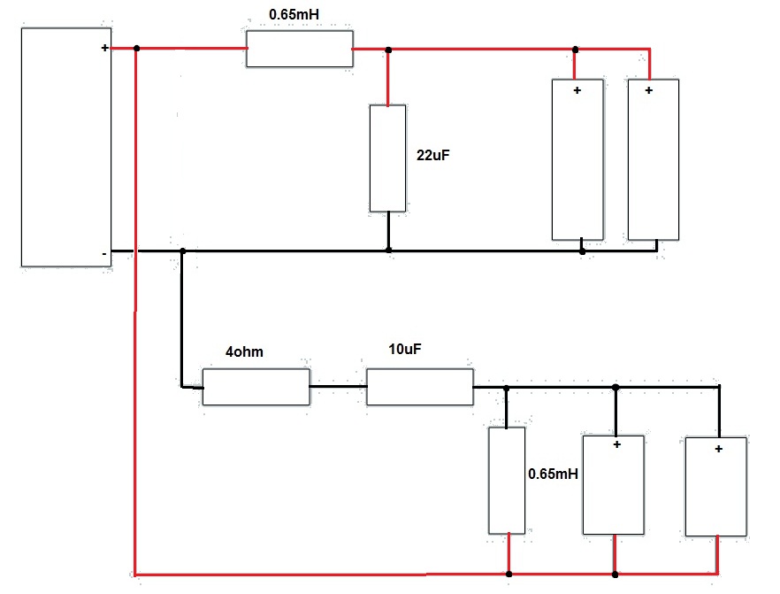

I am leaning towards using the PHT-407N tweeters with the HP-10W woofers, but I cannot find a passive crossover schematic for this combination. I gather that no crossover is required if using the Motorola KSN1001A???

If I cannot get the HP-10W woofers, and decide to go for the Eminence basslite S2010, do I need to change the filter, or cabinet volume, or port dimensions?
Yes the filter is different, I think this is the right one for that (top speakers are woofers, the ones below are the PHT's)
Cabinet size and porting exactly the same but there may be some fiddling to get the woofer magnets to touch and glue together (just pack out any gaps with ply or hardboard and glue as usual with chemical metal)
