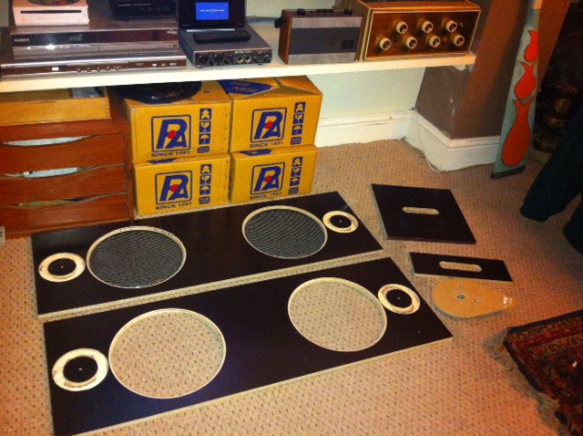

1st photos of my build - Baffles
Hi
I thought I'd post a photo of my build so far.....
Have routed holes for the HP10W's and rounded off with 6mm roundover bit... Routed the insets for the PHT-407N's so they fit flush, awaiting delivery of hole saws to finish off. I have cut the port slots with a 30mm flat wood borer and joined the holes up to form a slot with a jigsaw. I still have to glue them all together, sand and finish off with the roundover bit......
To the right of the photo you can see the circle cutter jig that I made for the hole cutting and the inset routing for the tweeters.
I shall be ordering the PHT-407N's next week and start gluing up the speaker grills and drivers to the baffle. As far as I can tell, I wont need to make any mods to the tweeters like the piezos? I shall of course use sealant when I mount them to make sure they are airtight.......

I am going to use small bolts plus silicone sealant to secure the drivers/grills to the baffle and epoxy to glue them to the center brace. My question is will epoxy itself hold the foam/grill/baffle together without the bolts if I use a good amount? I ask because I made 2 of the speaker holes like 1-2 mm too big which is not a lot and dry fitting was fine, just a tiny tiny overhang from the speaker foam. If I decide to not use bolts will the epoxy hold and will that foam stick to the driver? Those bolt holes are pretty close to that routed edge in any case! Most likely using bolts + silicone.
