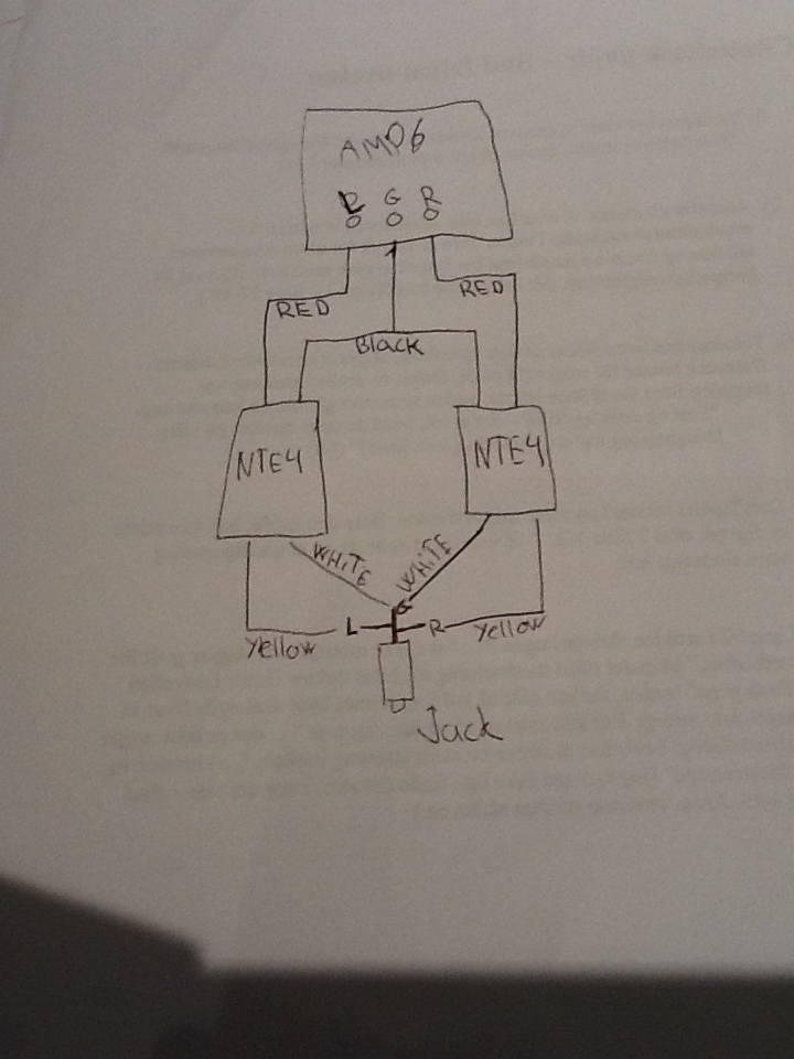

Hey guys.
I've been thinking about buying a couple of Neutrik NTE4 for my halfinator, but how do i wire them up with my AMP6?
I've attached a photo of how i think it should be wired
Correct me if im wrong.
