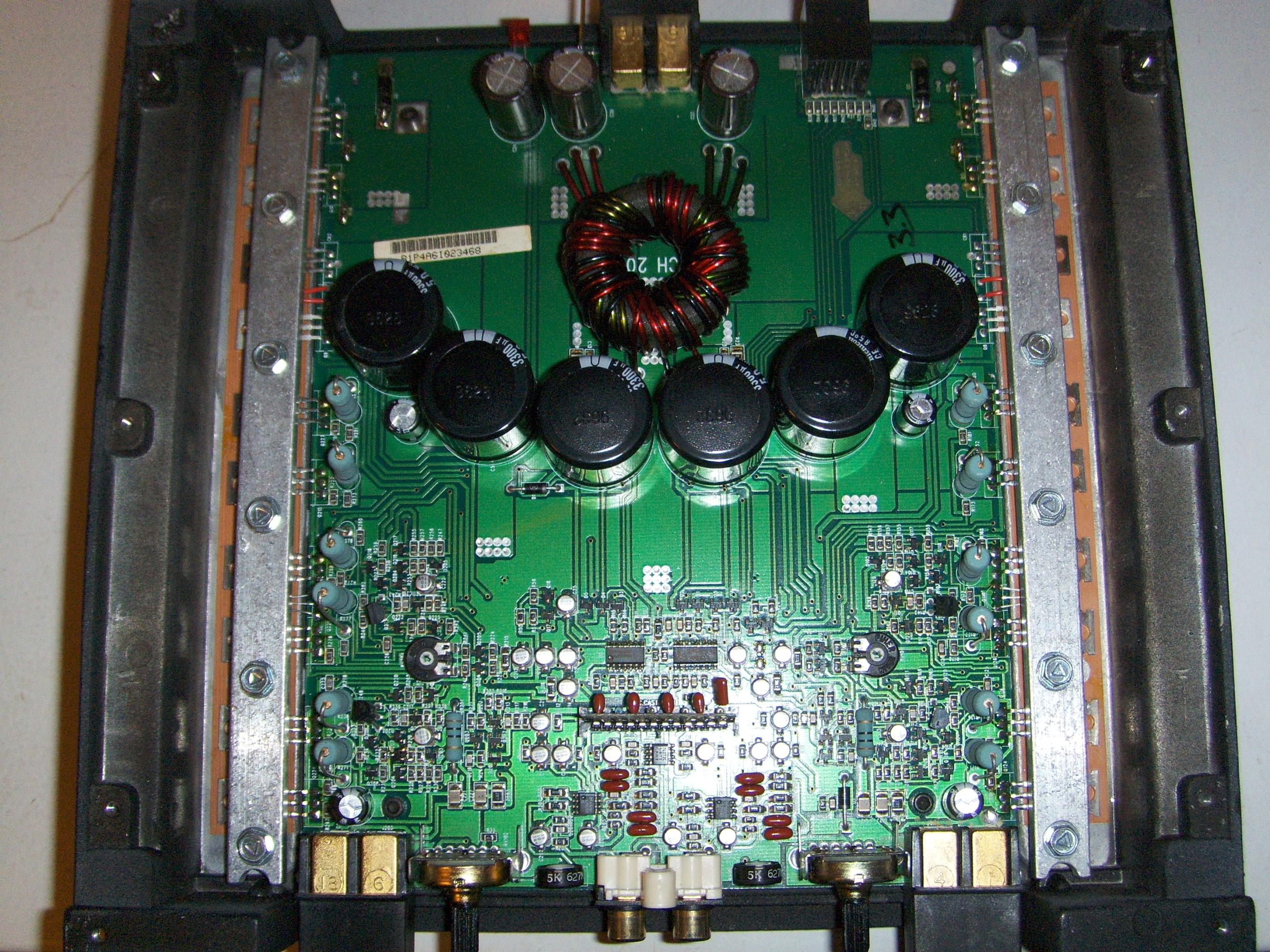

I agree with Perry on the Rockford amps. I am starting to branch out in my repairs but I mainly specialize in Rockford and stock thousands of parts for them. Rockford Fosgate has been in the game for along time and in my opinion were always ahead of the rest in technology.
Lets take the Punch DSM amps for example. They utilized many key features that others did not for that era in amp production. They used independent gain controls for each channel allowing precise level matching. They had the punch equalization circuits allowing 18db of bass boost at 45Hz, and 12 db of treble boost at 20kHz which really helped with vehicle interior interference.
Lets not forget the NOMAD (non-multiplying advanced decision) a protection circuit that used an analog computer to make decisoins regarding temperature, voltage, current and impedence. Did a good job of protecting the amp itself but not your speakers.
Lets not forget TOPAZ (tracking operational pre-amp zone) a circuit that eliminated ground loop noise by referencing signal ground from the first component in the chain.
Another advantage the mosfet circuitry in the power supply and output stage, producing high speed, thermal stability, high current capability, and very smooth accurate sound quality.
My favorite of all was the XCARD an option that could be configured for full range, high pass, low pass, and was infinitely adjustable.
More great features such as INDIGO (indexed ideal gain operation) which allowed the power supply to operate at different indexed regulation gains or power levels as needed. It optimized its performance by making better use of the power that is in the car. It tightly regulated front end (low level) components and at the same time allows output components to swing with battery voltage. That allowed the amp to deliver more power, clean sound, and tight bass.
They also utilized TRANS ana (transconductance active nodal amplifier) a circuit that simplifies the input path allowing the signal to travel through the amplifier at low voltage achieving current and voltage gain in a single stage.
Another great feature was the DSM technology they used eliminating most all the "OLD" through hole technology resulting in greater efficiency, less noise, and higher output.
The vibration theory Perry had described I agree with. I have had and do have many Rockford amps. I think it was due to their extruded aluminum heat sink and its ability to absorb vibration and had much greater cooling capabilities than the "OLD" conventional extruded sinks.
I think this is enough rambling for one post maybe I will discuss the Power series and 4 channel DSM amps in my next post. Then maybe we can also talk power cube ratings vs various amp manufacturers.

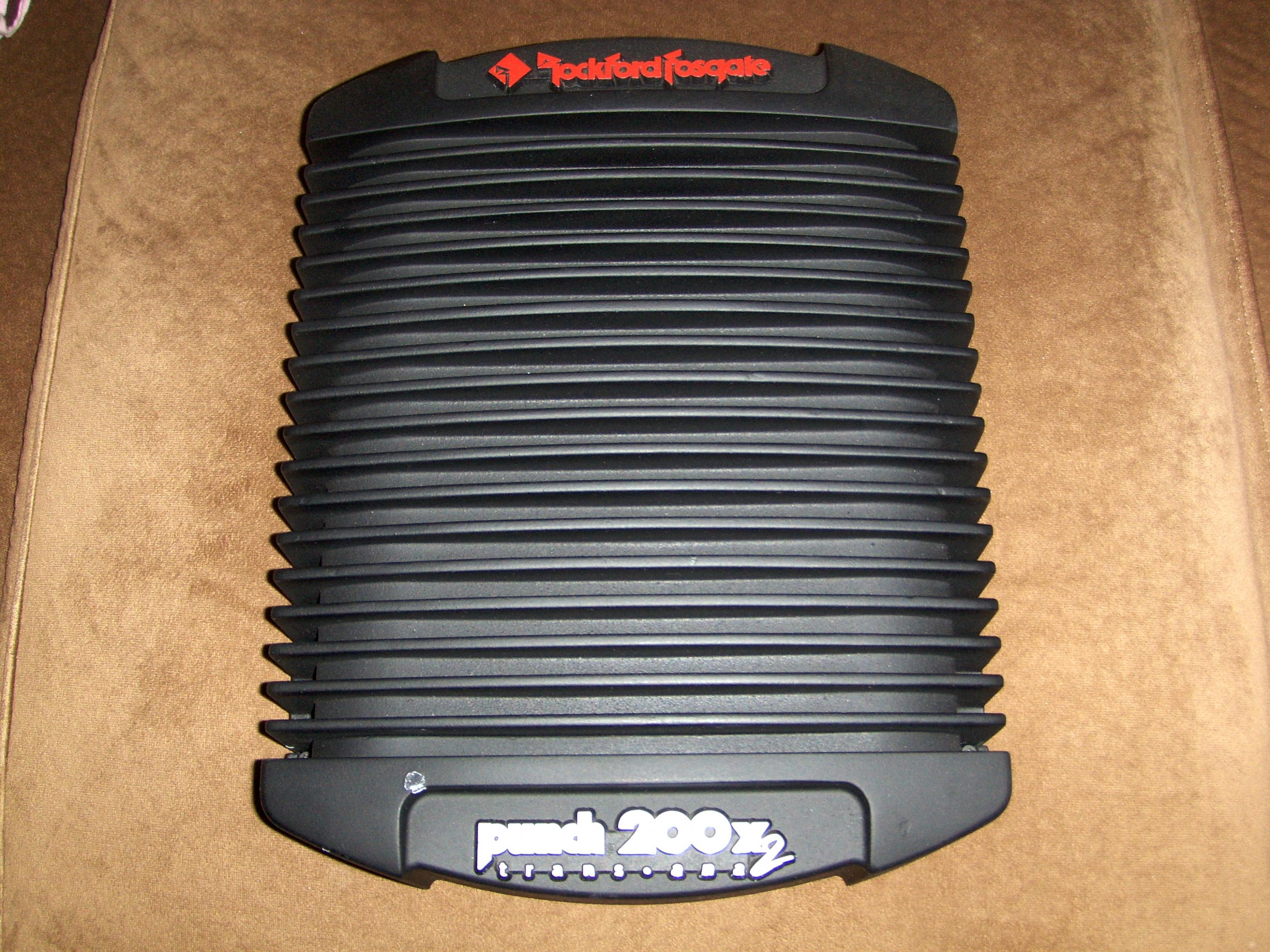

A very fine example would be this 200X2 I have posted a few pics of. The power cube test revealed that this amp performed almost a perfect cube.
8 ohm stereo 60 degrees 85W per channel
4 ohm stereo 60 degress 157w per channel
2 ohm stereo 60 degrees 254w per channel
1 ohm stereo 60 degrees 373w per channel
8 ohms bridged 60 degrees 320w
4 ohms bridged 60 degrees 528w
2 ohms bridged 60 degrees 760w
1 ohms bridged 60 degrees 673w
These tests were done at 14.4 volts not bad!! Its only a 200 watt amp right???
