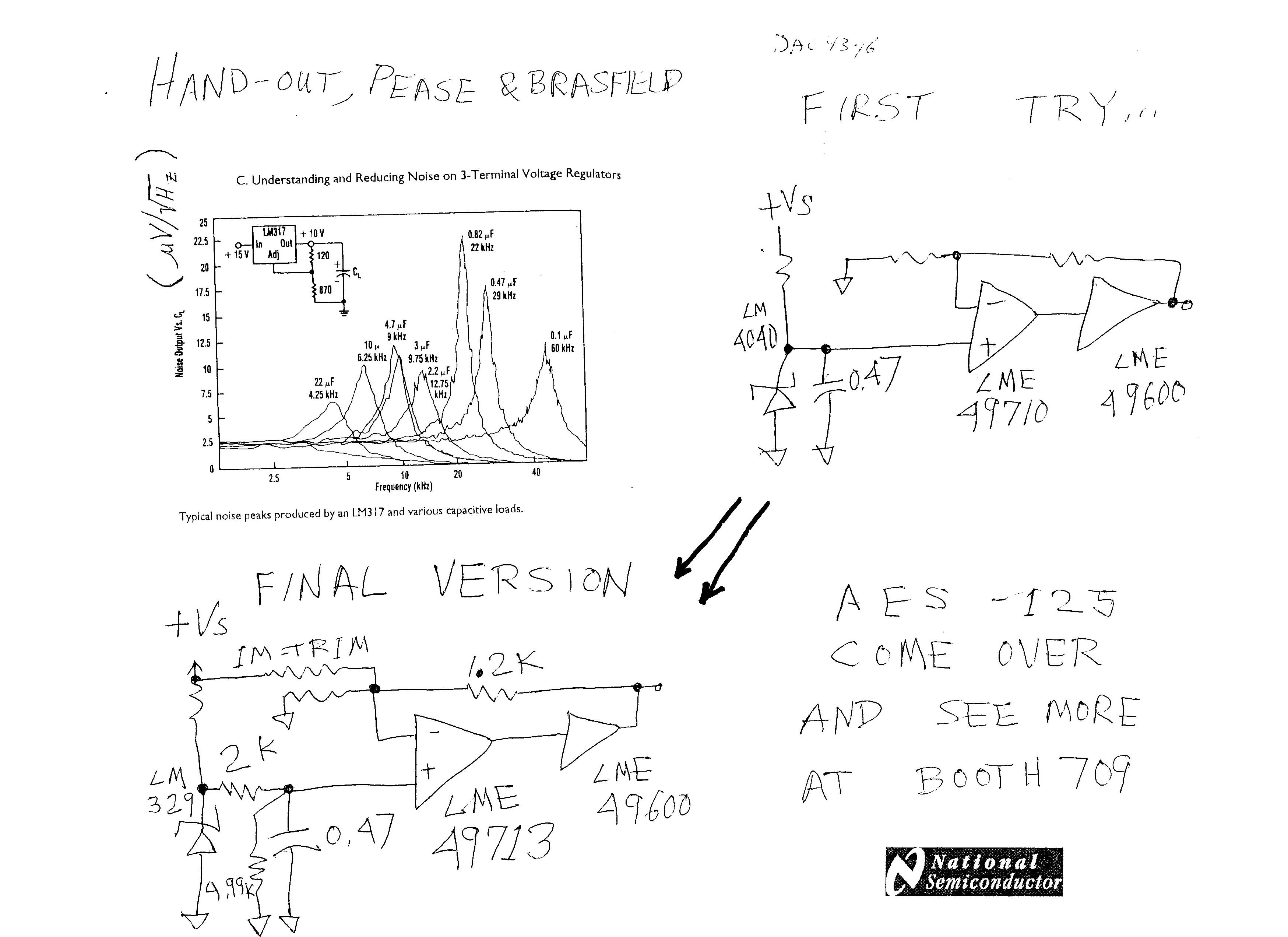

Hi Carl,
Not quite ready to publish those changes yet...but if anyone can find the video of the AES presentation in SF with Bob and I that we gave together on Sat Oct 4th 2008, that presentation has 95% of the changes in that video. Let the hunt for the video begin!
Was anyone from DIY at that presentation? I thought you were there Carl?
Audioman54 / Mark
I was there Mark; I'll look through my pics I may have a picture of (some) of the schematics.

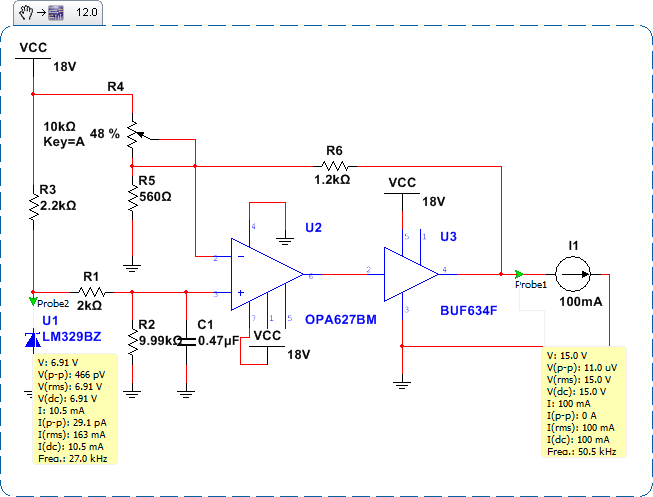

First I want to ask Mark if I have his permission to upload this, If you think I shouldn't I'll remove it.
I kept the values for the positive reference, and I played with the values and configurations for R4 and R5. First I though that it was a good idea to change R1 and R2, but then I realize that those are very important, and I shouldn't change those values.
I choose BUF634 because it was the only one that I could find on the multisim library, and I have some too.

Jan Thanks for posting that Pic of all three of us. I know you sent that pic to me and I have it somewhere...but now it will be easy to find as I saved it in my audio folder.

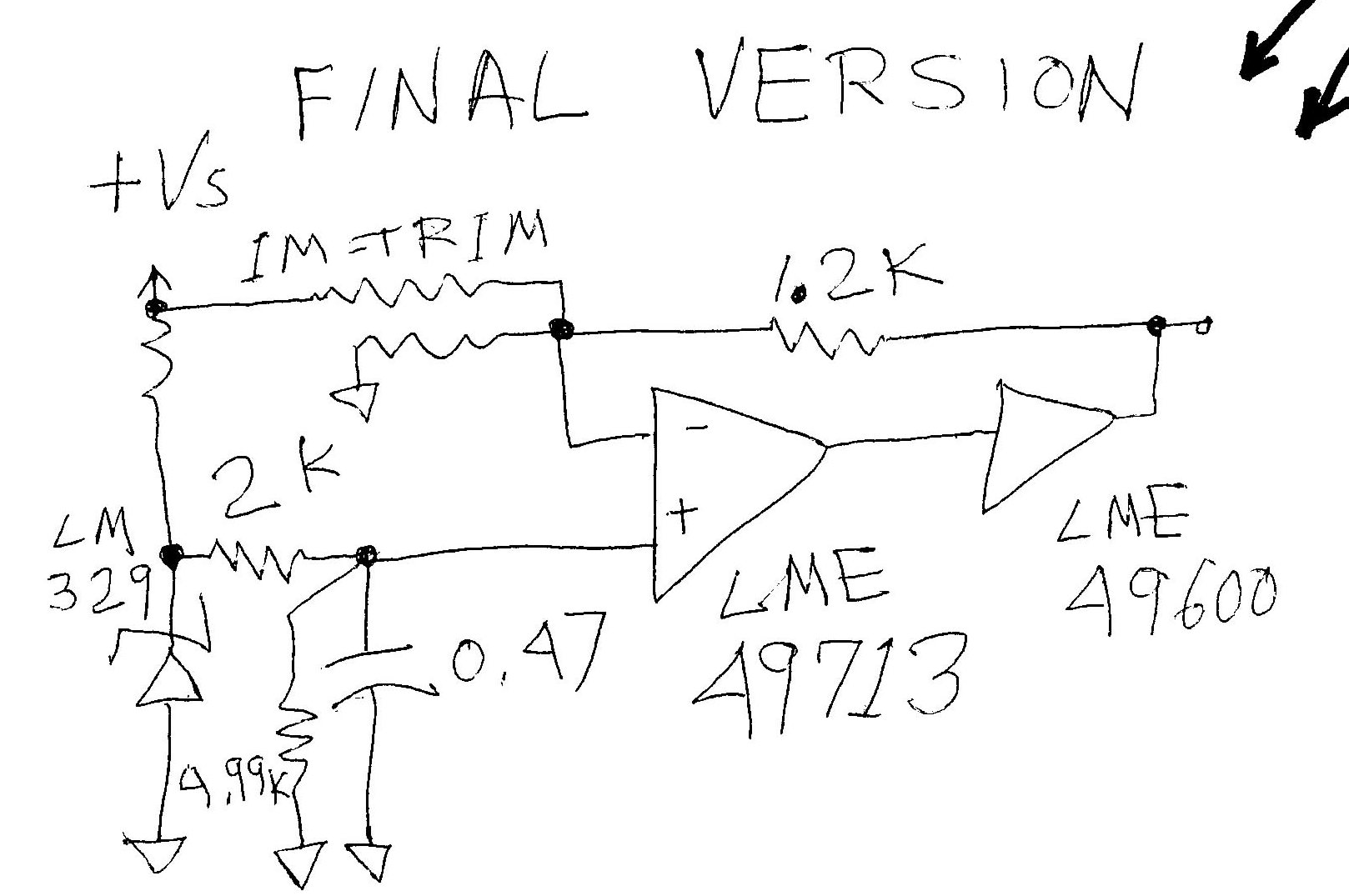

The schematic that was hand drawn by Bob is correct...however it is phase one and it does not have the changes that resulted in the 6dB or so lower THD+N graph that I posted. If somebody on this forum finds me a contact that leads to a job then I will post the final change. It was something that is not obvious but very simple and I had never seen it in an audio circuits book before. Bob had a memory like an encyclopedia but he could not remember where he saw the change...he just knew it would work...and it did!
