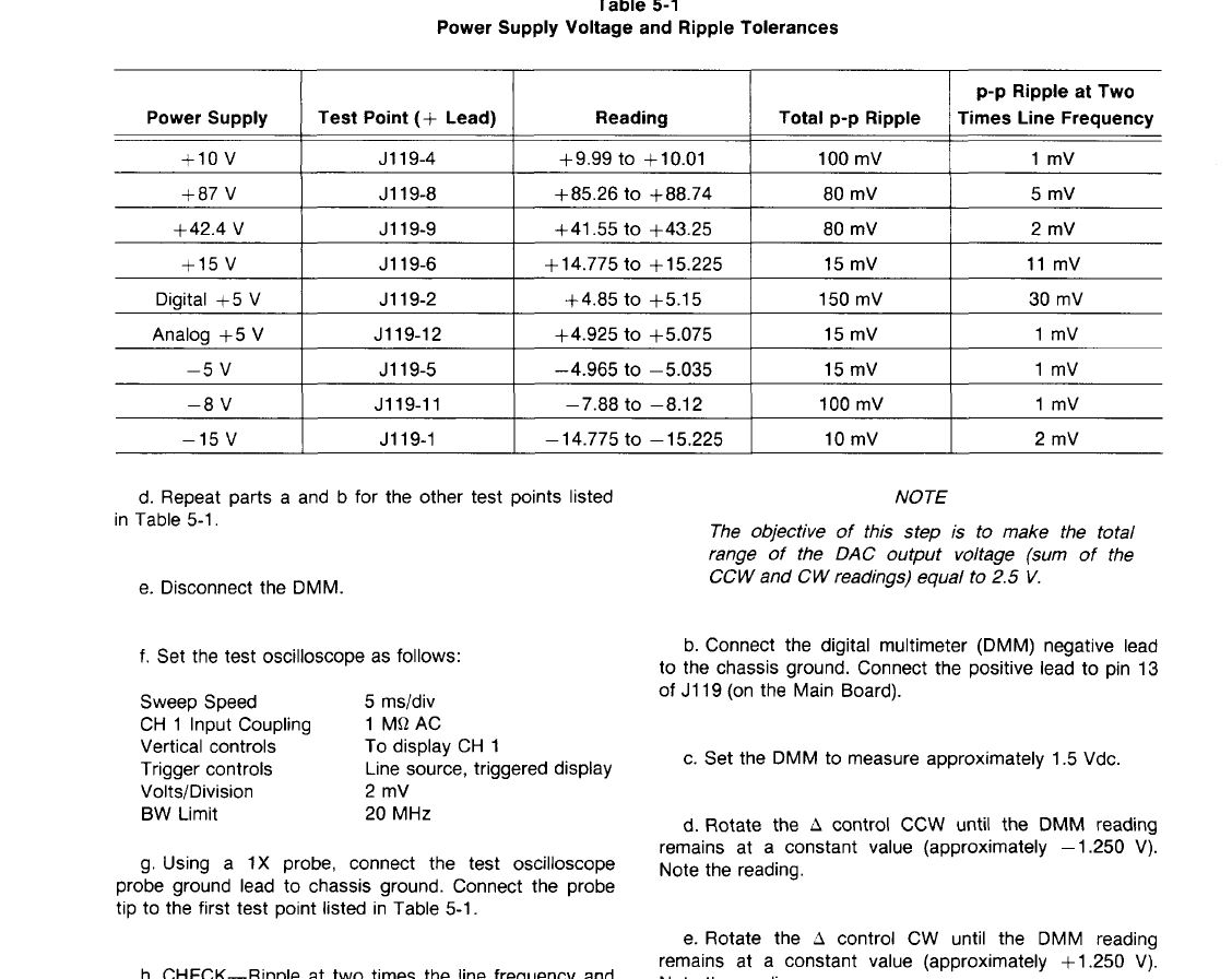

I began to calibrate the 2465
I checked all the voltage on j119
I let the scoop warm up for about 20 minutes
The 10V voltage was a small deviation of 10.2V
(J119-4)
i calibrated the 10 volts in R1292
After I adjusted
Exactly to 10 volt.
All the over Voltage Were exactly according to the requirements
+10V- J119-4
+87V - J119-8
+42.4V J119-9
+15V J119-6
+5V J119-2
+5V J119-12
-5V J119-5
-8V J119-11
-15V J119-1

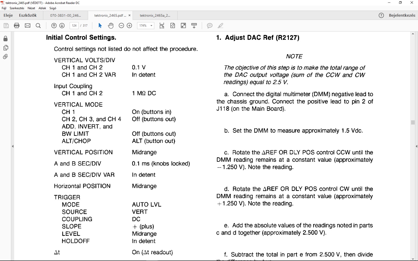

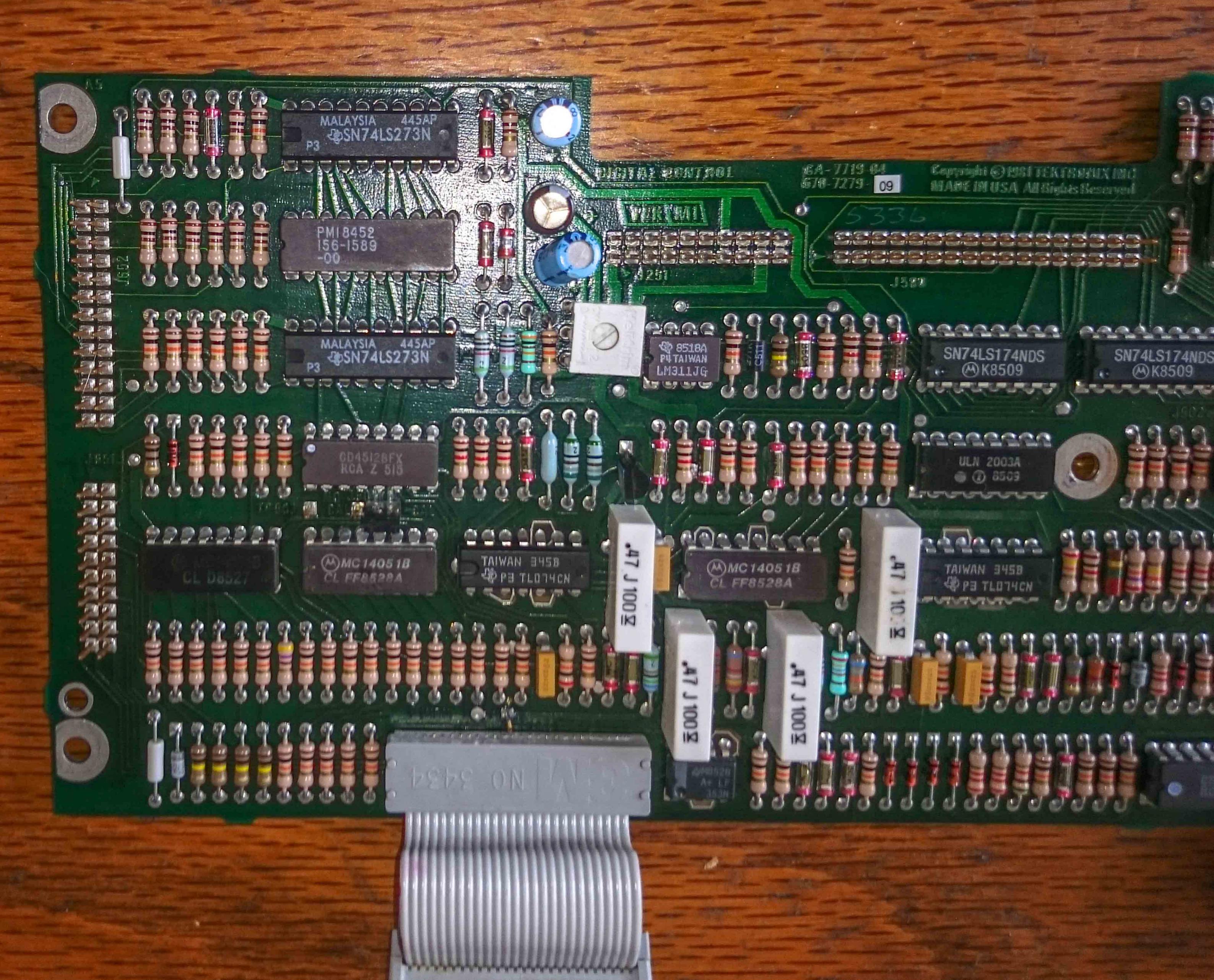

Now my problem
The only problem I'm trying to figure out is how to calibrate
the channels are not calibrated in terms of voltage measurement.
I understand what has to be done.
Correct the offset of each channel with an external frequency generator.
The question
where is the potentiometer for the Vertical gain amplifier
for each channel offset calibration ?
( the service manual for the 2465a is Very big Almost 500 pages Still trying to figure out how to do it there
So help is welcome.

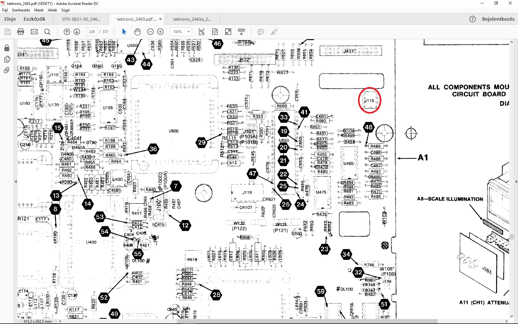

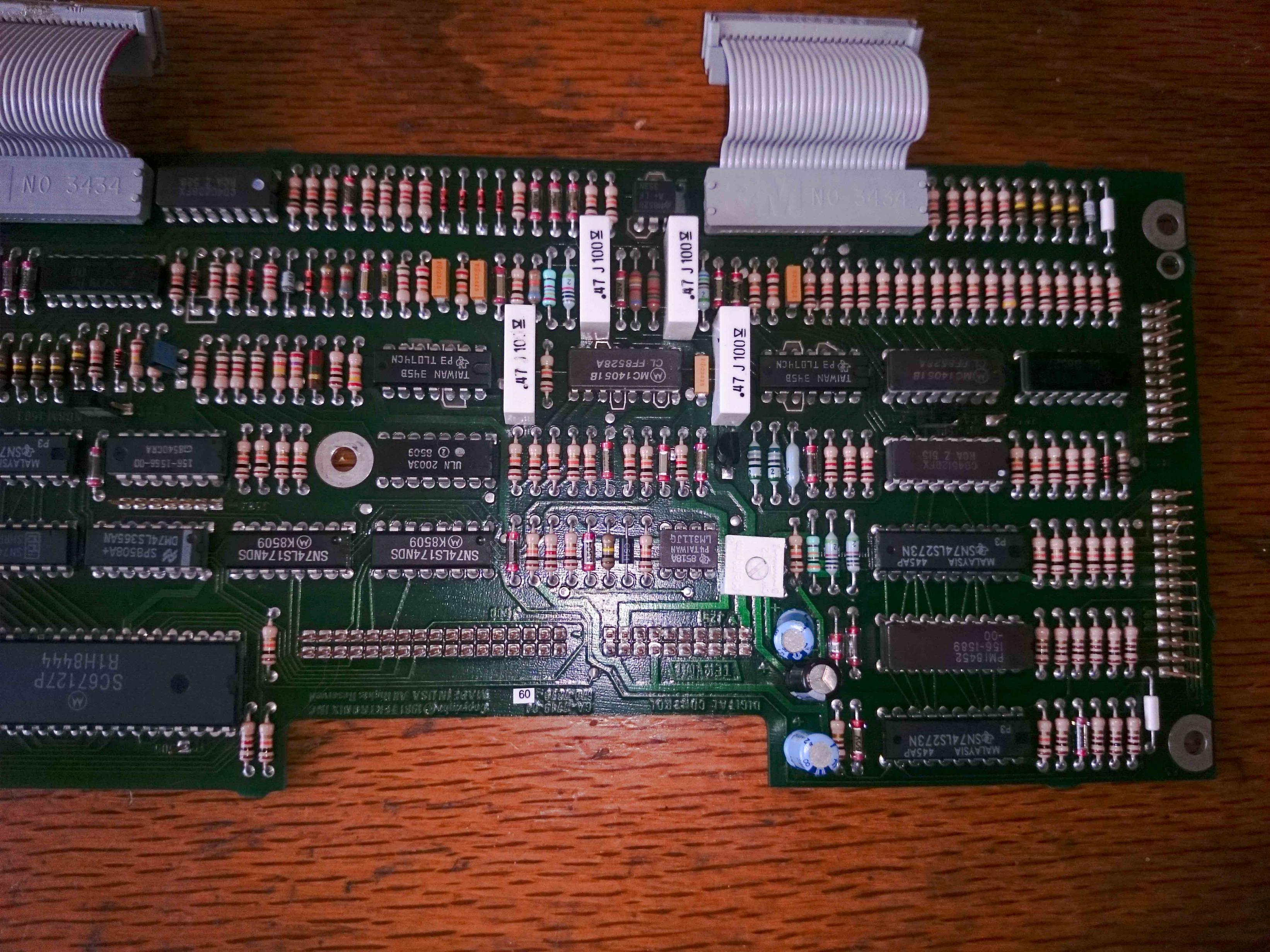

yes pin 13 on j119 is 15v fix .So you say, you try carry out 2. Adjust DAC Ref (2010) in service manual, and J119 pin13 remains meanwhile at a fixed 15V?

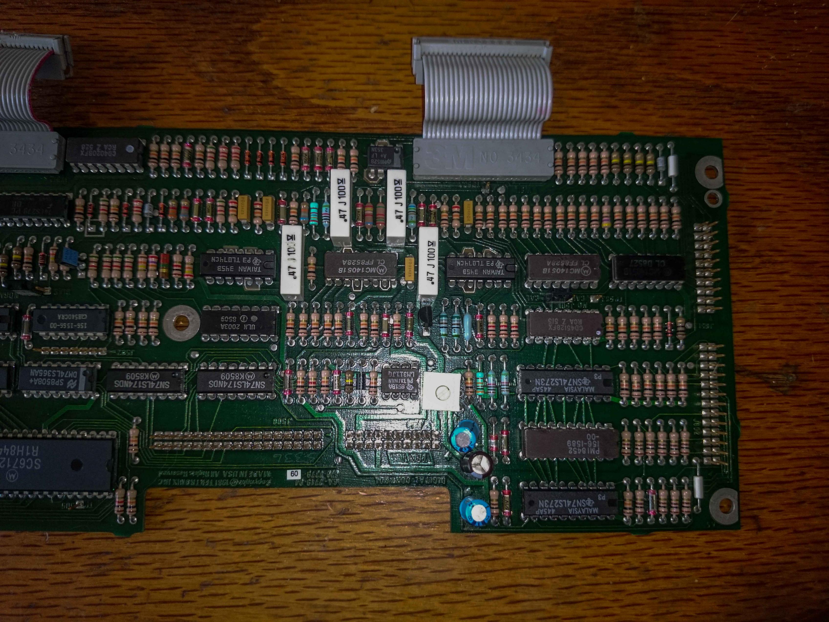

my tek 2465 is the 300Mhz not the b version
a5 borad is different

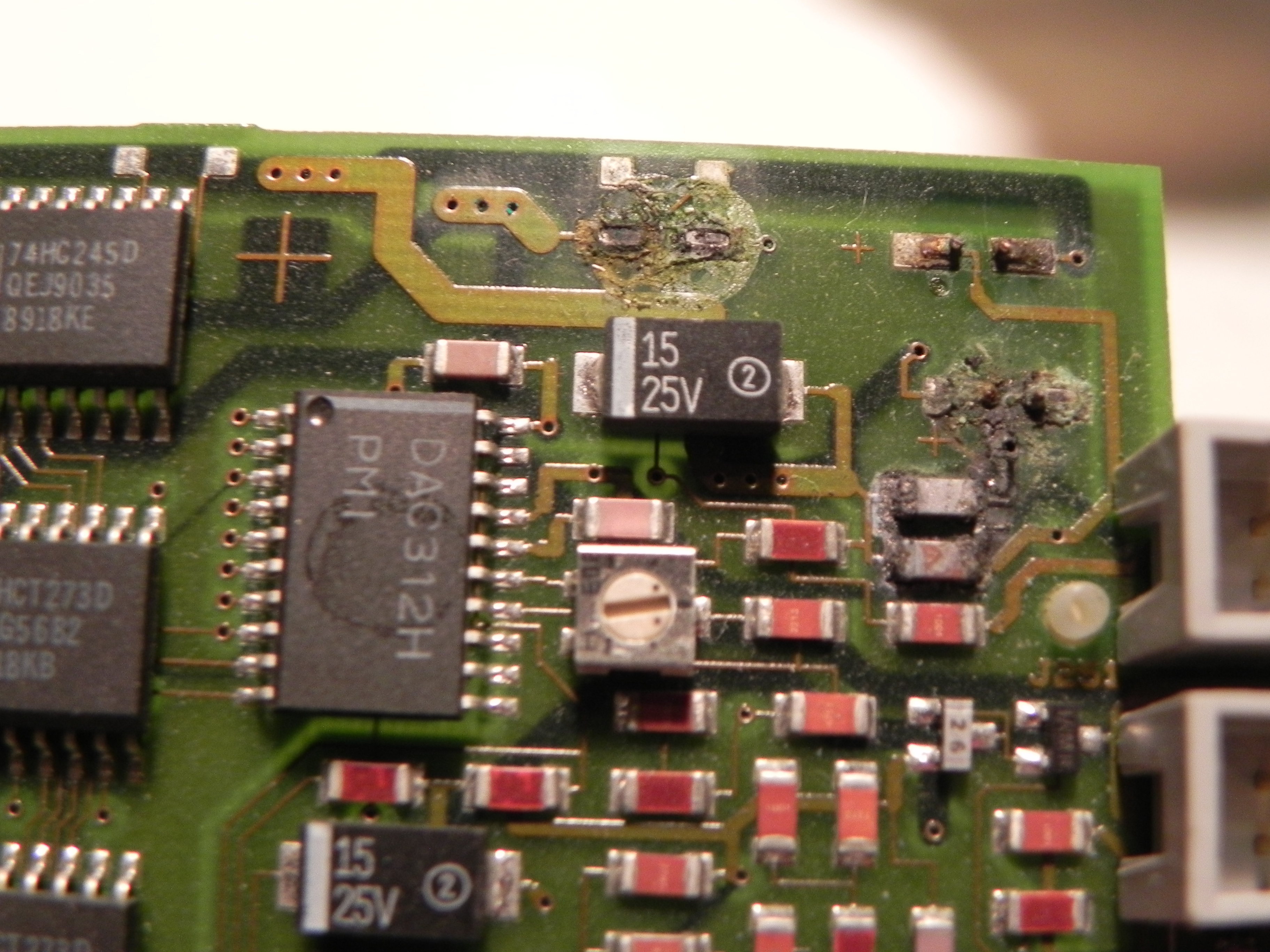

Yes, I know, probably you have something A5 like this:
https://1drv.ms/i/s!AL9ftlB9y5TohSE
But I think, worth a check around U2101.

this is my A5 boradYes, I know, probably you have something A5 like this:
I like your cat!
What I've said above, it is from 2465a manual, yours is a 2465, where it is different a little bit, have you the correct manual?
wow gyuri big big thanks you are the bestWhat I've said above, it is from 2465a manual, yours is a 2465, where it is different a little bit, have you the correct manual?
I'll try it now
