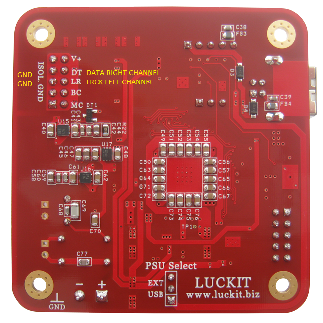

Infor for WaveIO USB-I2S owners.
I2S_BCLK = DSD_CLK only for FlipFlop users
I2S_LRCK = DSD_DAC0 =left
I2S_DATA = DSD_DAC1 =right
Attached pics WaveIO, important when using isolated I2S outputs (recommende) to power with other PSU no shared with the WaveIO power or the self powered USB.
