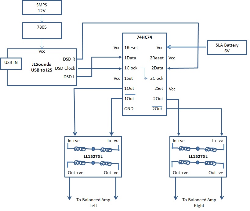

I installed a mute relay and silence - the outputs are continuously grounded. There is something very strange going on with the relay that I don't understand so if anyone can shine a light; basically, I can measure the voltage change across the relay coil and can hear the click of the relay but the contacts don't seem to change. Here's the circuit;
and I'm using one of these relays (4.5V coil, DPCO, non latching version);
http://www.farnell.com/datasheets/1683361.pdf
The pin annotations on the schematic relate to the relay pins.
With no music playing I measure 0VDC across the relay coil and 5VDC when music is playing, which is what I expect.

I don't understand in any way this schematic.
How the relay works?
Is it an high pass filter?
EDIT:
ok, from right to left, not vice-versa ;-)
Catching up on this thread... Is this still a problem? What happens if you route the signal through the relay? Ground on pins 2/9 (to ground when coil is de-energized) inputs on 3/8 and buffer outputs on 4/7? Best of luck!

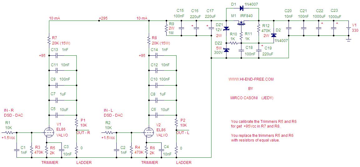

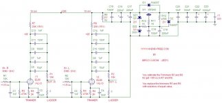

This is my Valve Preamplifier for DSD - DAC
Thanks Ray.
Dears ALL,
this is my personal version of Valve Preamplifier for DSD - DAC.
In this special Preamplifier there only a capacitor of uncoupling among input and output.
Is very important that all capacitors not polarized are of high quality.
The polarized capacitors are long life and for use to 100Khz (for DCDC converter).
Thanks and All the Best,
JEDY
