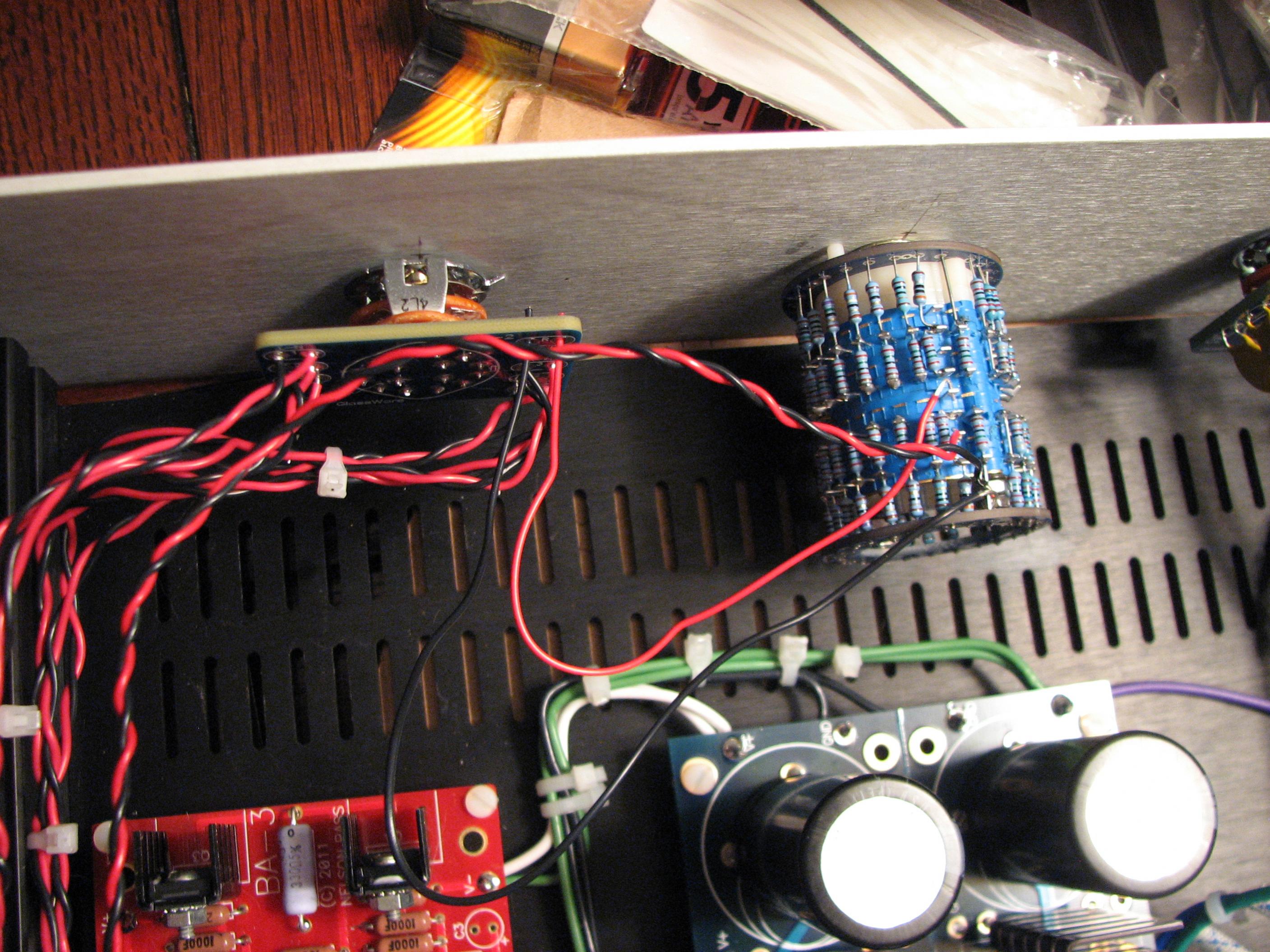

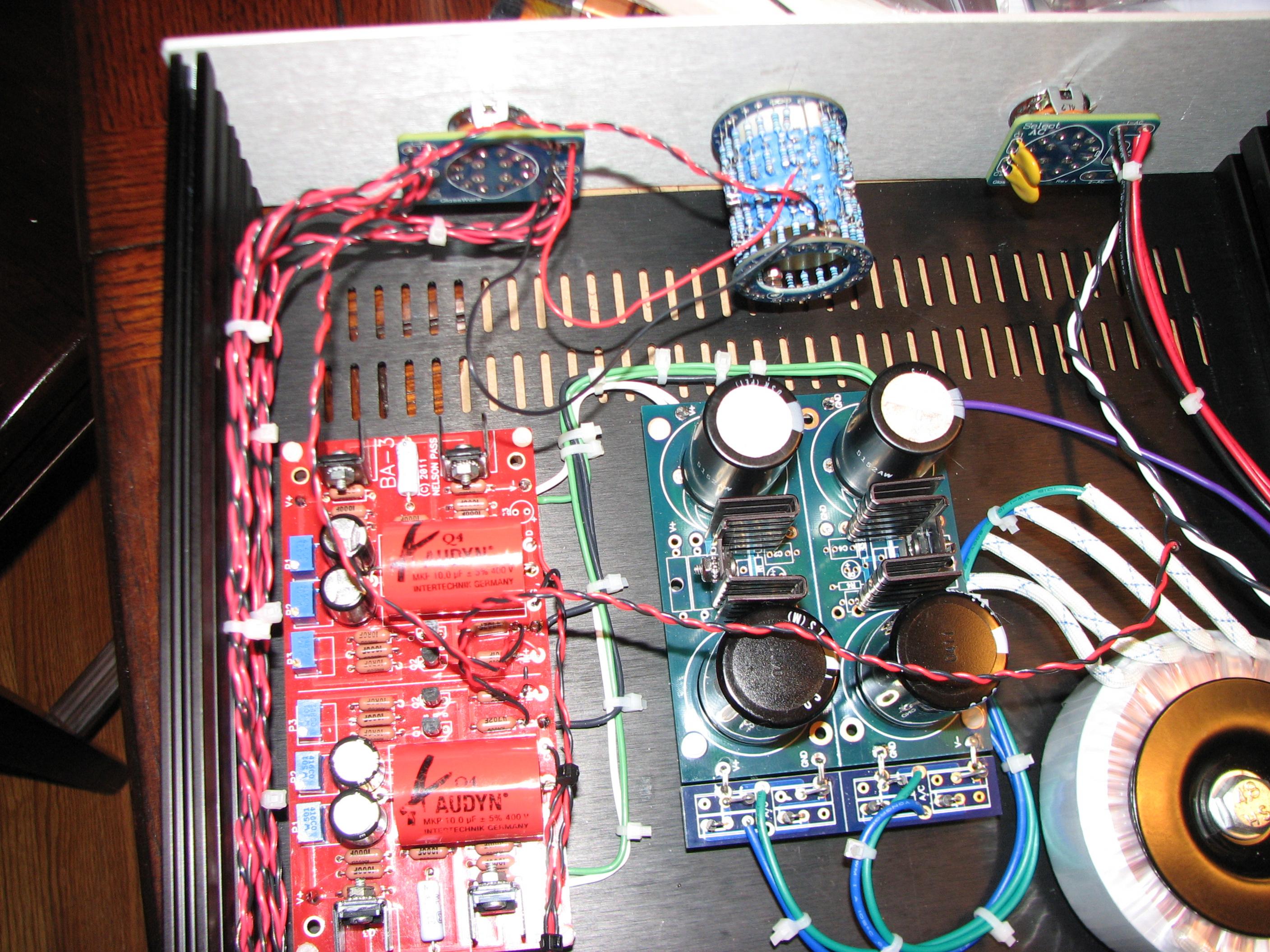

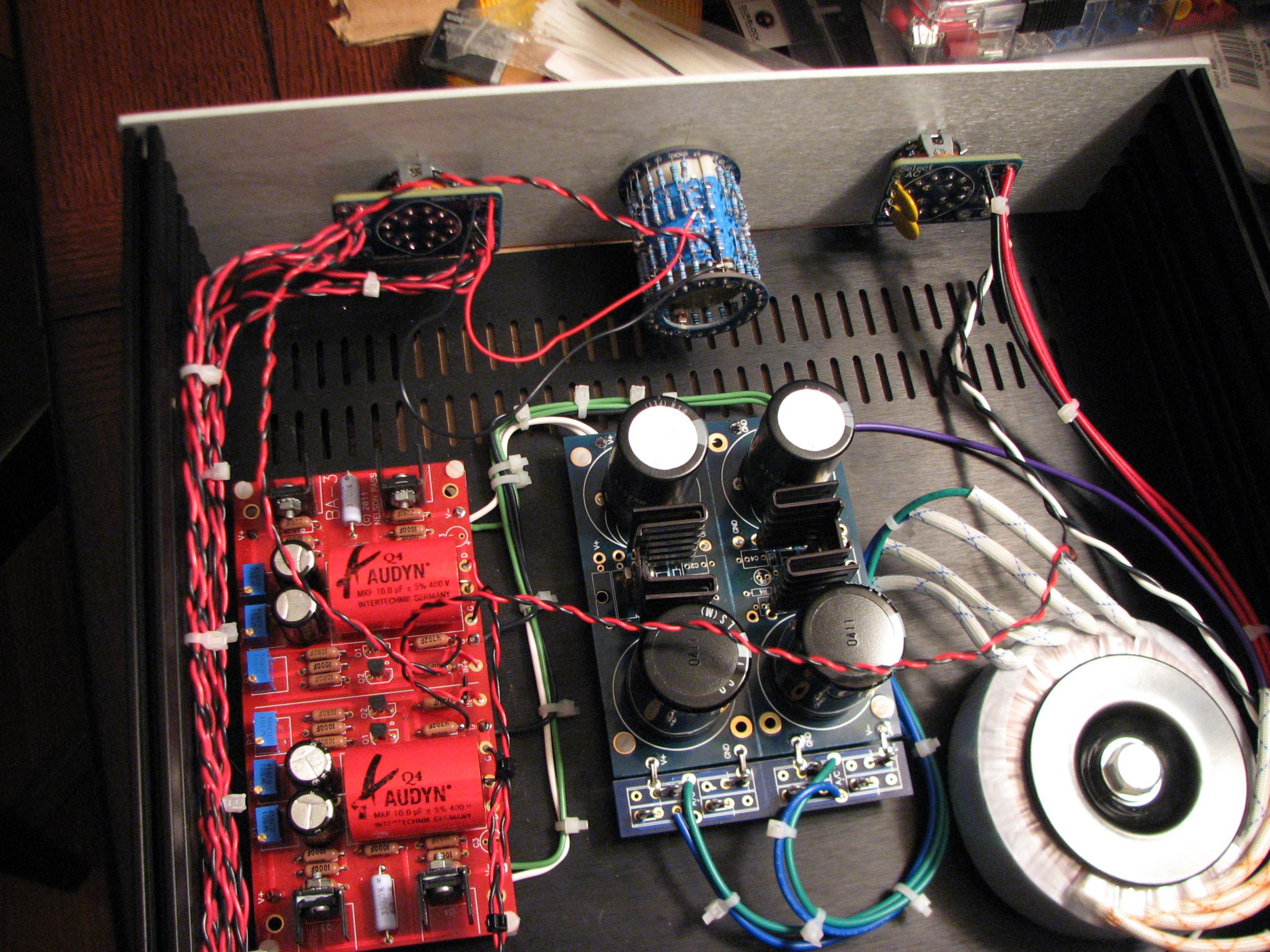

OK, got everything in the new 3mm front panel box, rear panel drilled, and of all things, the volume pot didnt arrive on Sat. as anticipated. Oh well, I am ready for it when it gets here! just need to drill 3 holes in front panel and mount the on/off, the selector (which is wired) and the volume pot. Jump the pot to the selector, solder selector wires to the 3 sets of RCA jacks and its ready to fire up.
Russellc
Joined 2003

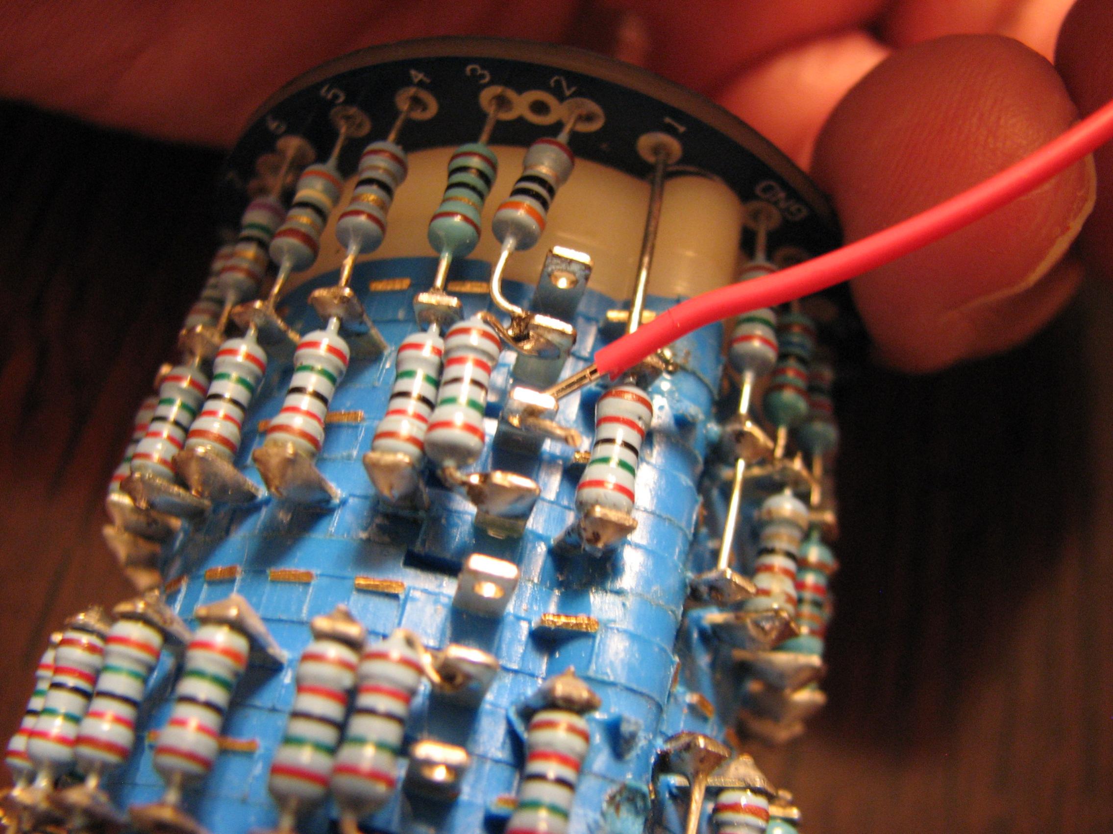

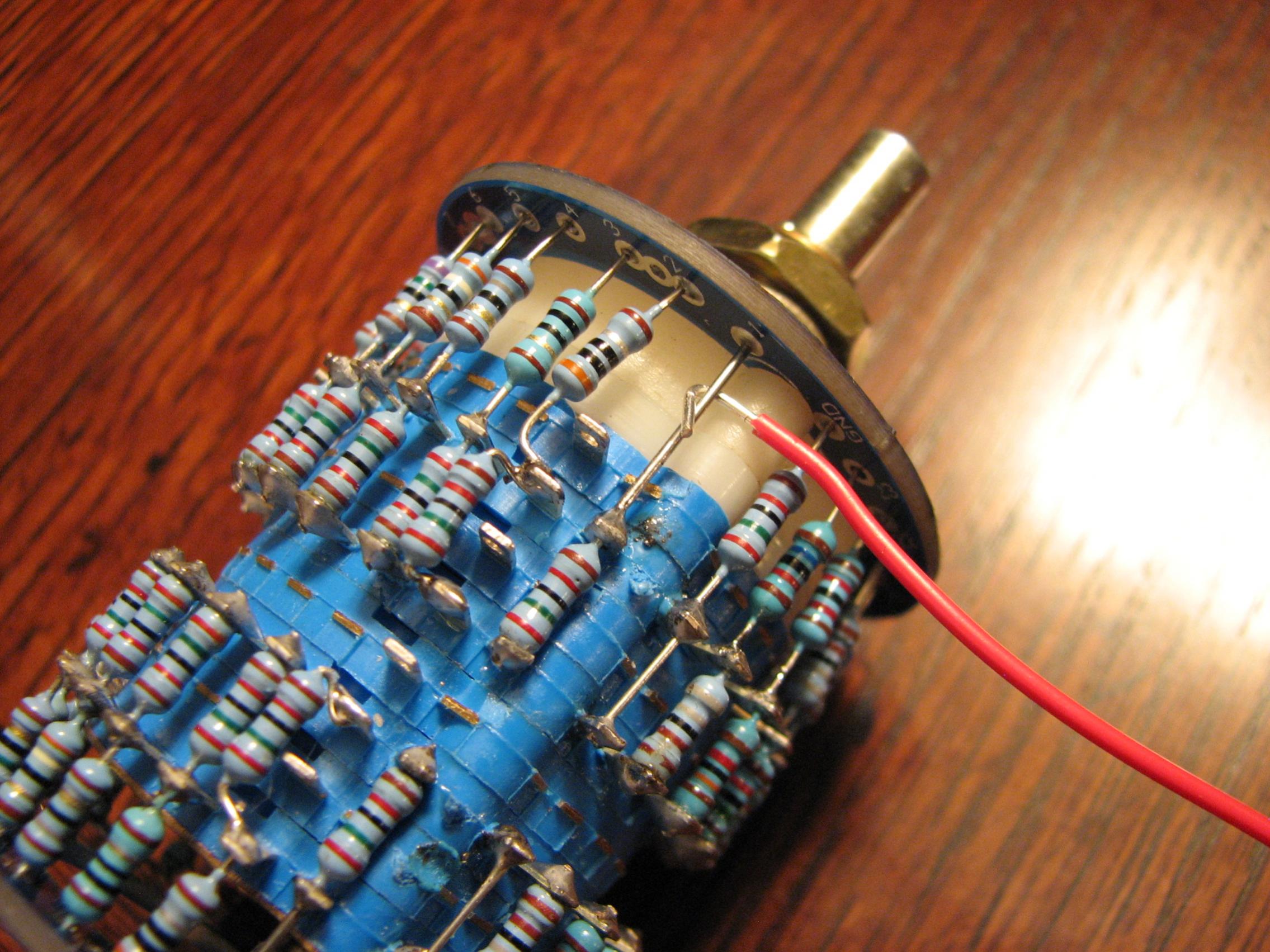

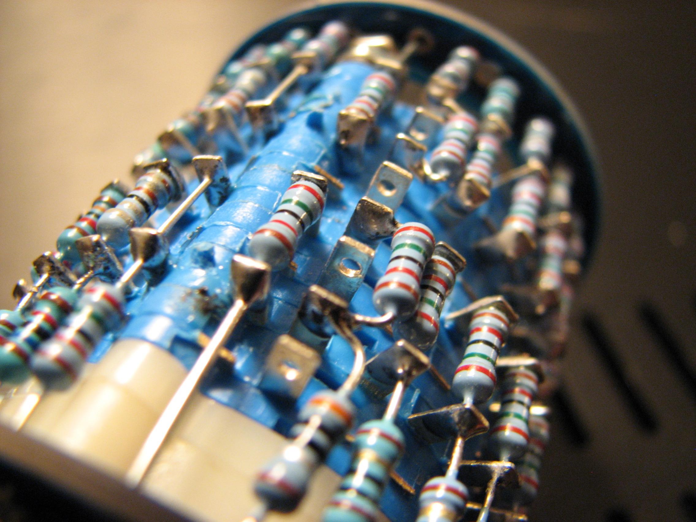

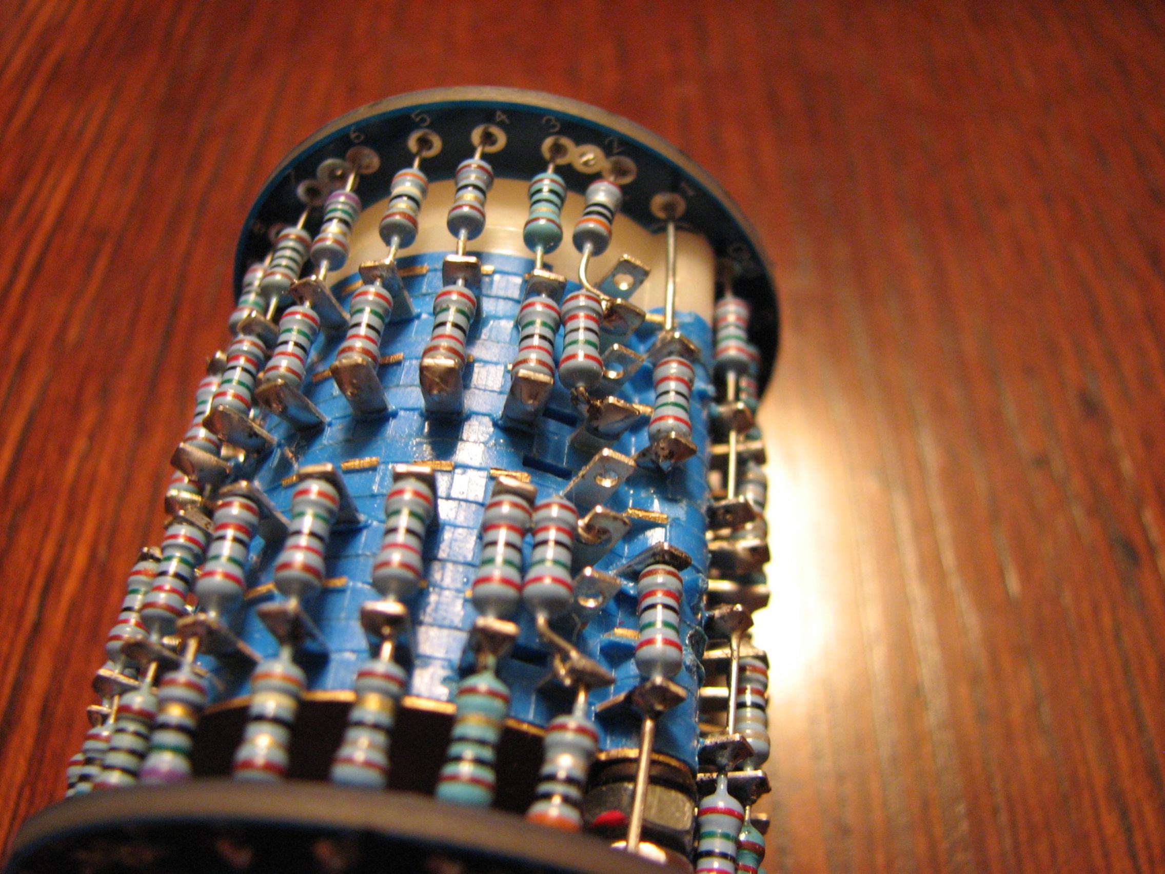

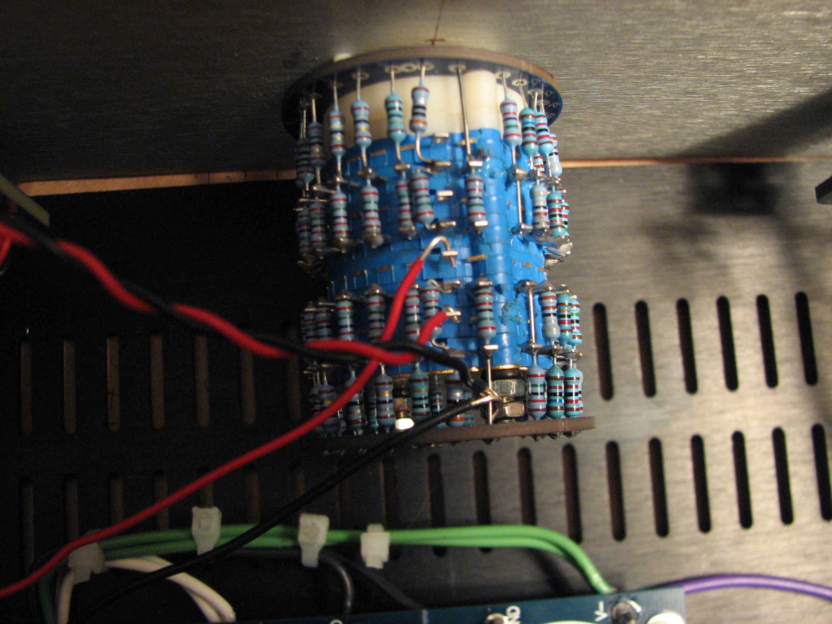

If I can figure out this volume pot, all I need to do is attach the power cord, fuse and chassis ground...and hook the shield to it. This depicts one channel,
wires not soldered, just in place how I think one channel should go from board to volume pot, and from pot to selector, obviously not soldered either.
Am I getting close? Any comment appreciated!

Very nice articles, makes understanding clear...problem is in converting words and flat pictures into use for 3 dimensional object. The picture montage actually has a picture of what appears to be my pot, except mine has a circular board on ends instead of plain wire.
Anyone have a pic of one hooked up? Hakari1 gave me this one, which from where I came up with hook ups in my pics. (scroll down)
http://forums.stevehoffman.tv/threads/tone-controls-etc-any-one-use-them-if-so-why.422911/page-4
Zen Mod, I suppose you are saying my hook up in pics isnt right yet?

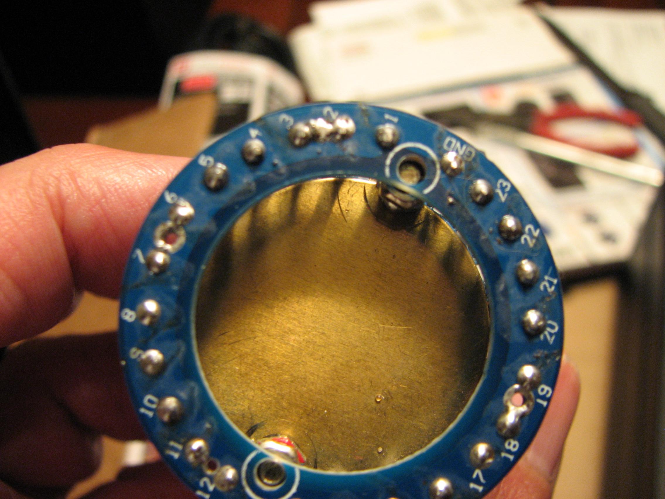

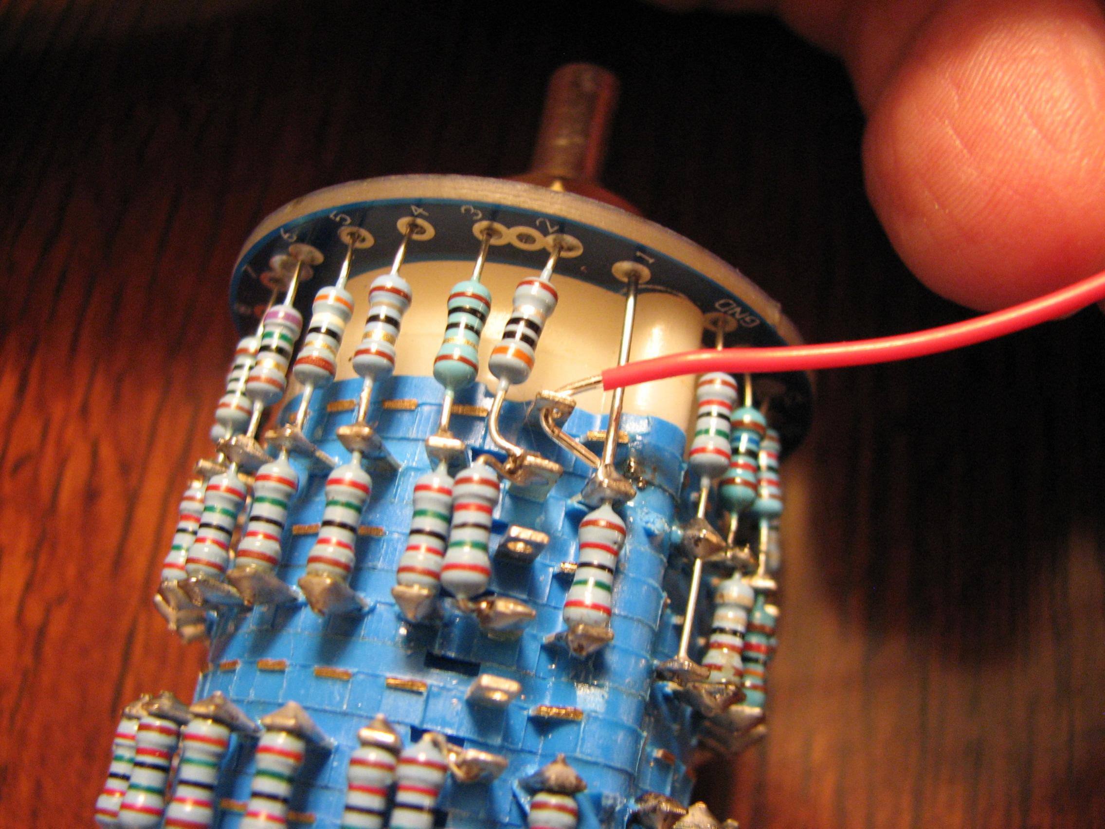

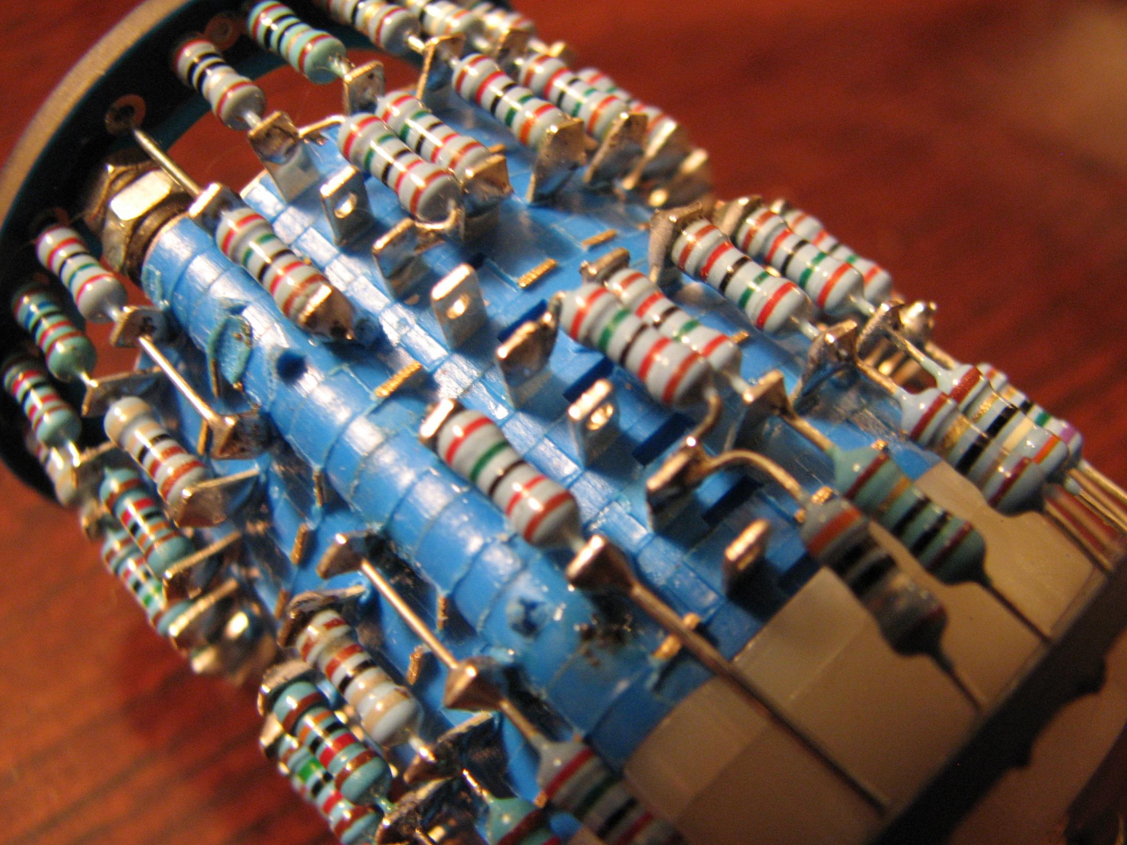

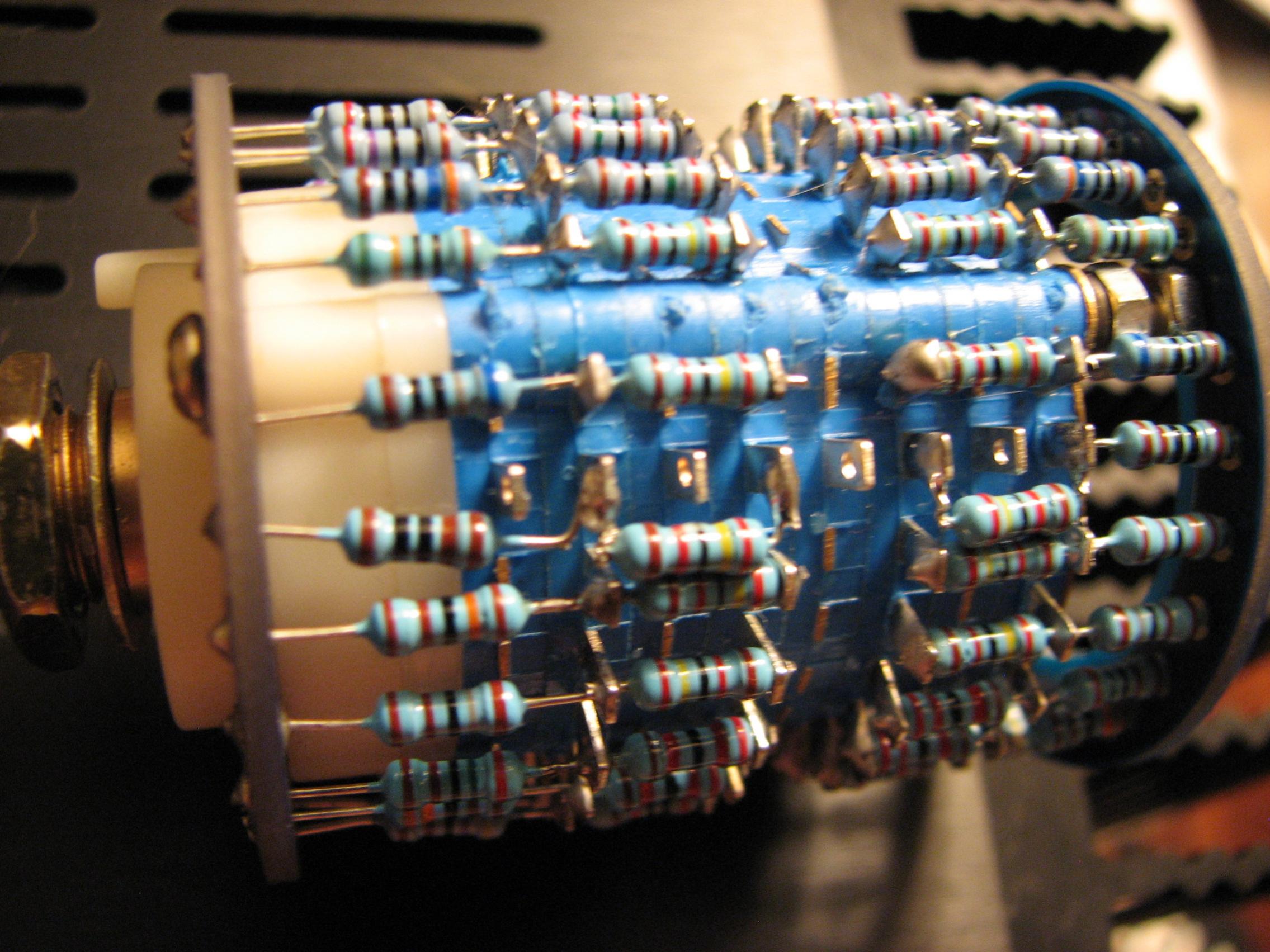

Looking at the available hookups and various tutorials I am "assuming" like this?
From left to right, first pic is one channels ground, second pic is same channels out, and third pic is same channels in?
Other channel goes to other set?
