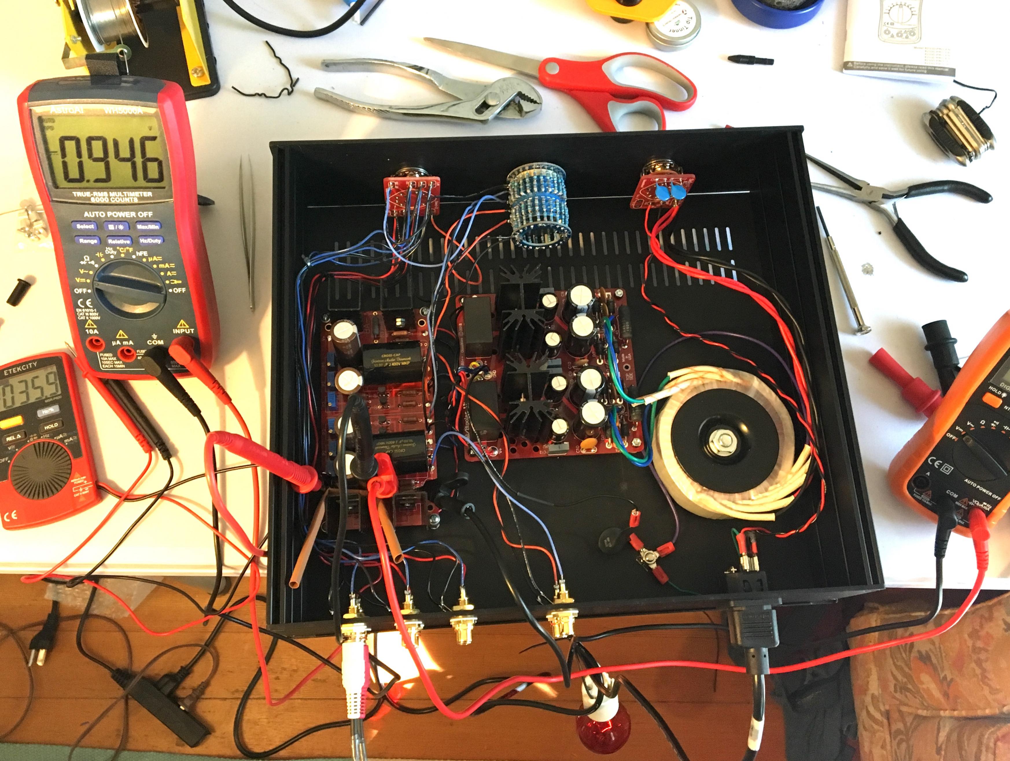

Okay, I need some help with biasing. I have P1 and P2 dialed all the way CCW until they click. P3 is set at it's midpoint (12.5 turns).
Without doing anything to P1/P2, R11 and R10 are measuring just shy of 1.1V. The lowest I've been able to get the offset with a little bit of turning P1 and P2 is 0.5V. Thoughts?
I'm getting about 23.5V from the power supply board...
You mean bias voltage? 1V across r10/11 would give you about 50ma. Which is good. How high you can bias will depend on your heat sinking. But 45-60ma is probably a good place to start.
No, I mean the voltage (+/-) rail. It says something between 20 - 30 volts in the F5, but what's the ideal as a preamp/ gainstage?
The same - something close to +/- 24vdc.

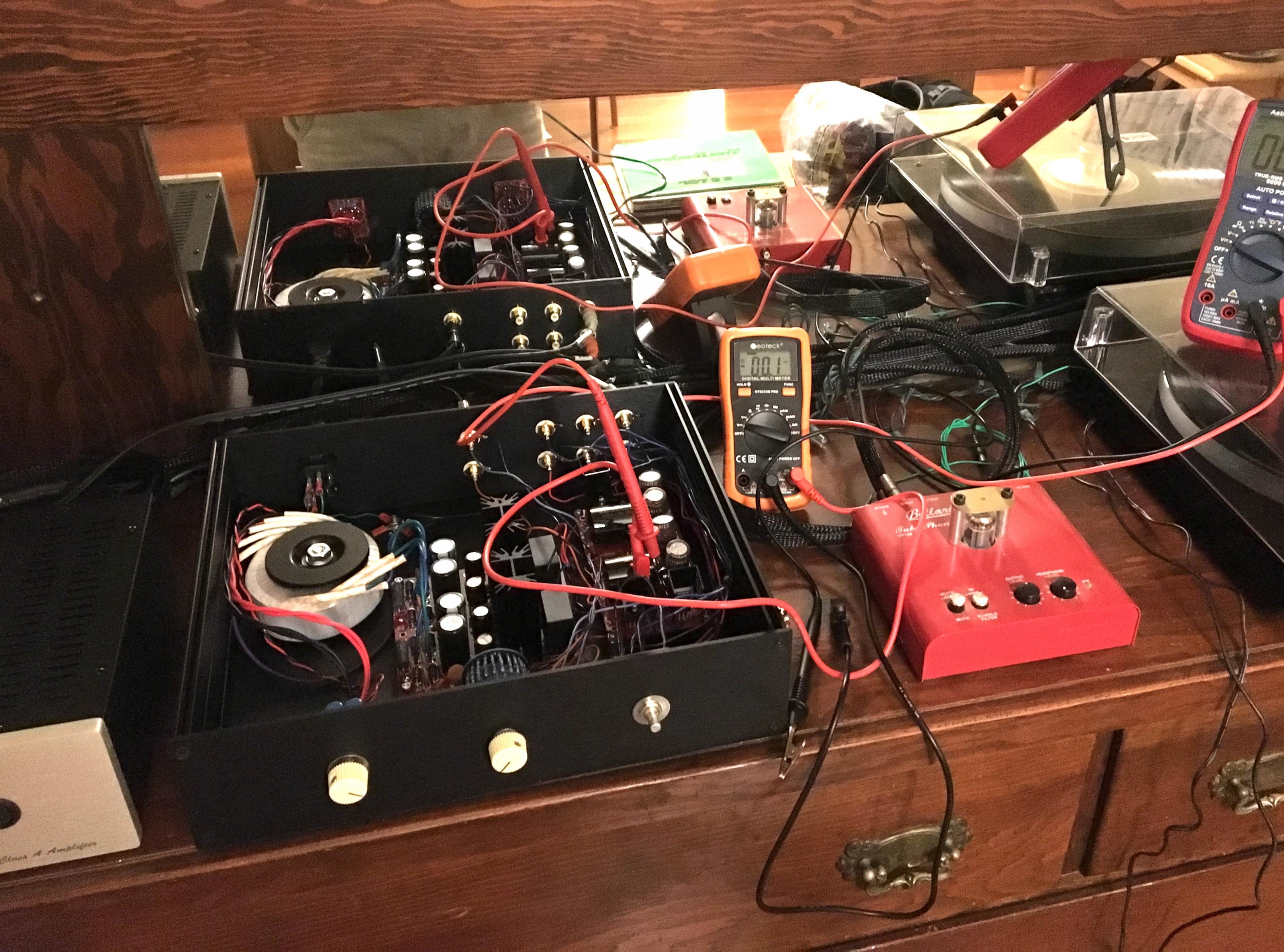

Well, I'm thrilled to report that my BA3FE is up, running, and putting out sweet, sweet, music! Thanks to the good and patient guidance from all of you here on this thread, plus a healthy dose of luck, everything went smoothly once I managed to get the wiring figured out.
I must say that turning up the volume for the first time and hearing music come through the speakers via the BA3FE and the ACAs - components I had built myself - was a really special thrill. And it continues to be as I work my way through my vinyl collection, hearing old favorites again for the first time with this new setup.
Here are a couple pics - from the work bench to the system. Next project is the power supply upgrade for the ACAs, then to work toward replacing that Bellari with the Pearl 2, and then, eventually, the Aleph J which is to say you can consider another newbie hooked!
Special thanks to 6L6 for the build guide, McQuaide for helping me figure out how to wire the volume pot, and to the rest of you for encouragement and help along the way!

Beautiful! I know what you mean, hearing great sounds through something you built with your own hands.
Outstanding! Well done!!
It's a great sounding circuit, I'm sure you'll love it for a long time.
Thanks, guys!
