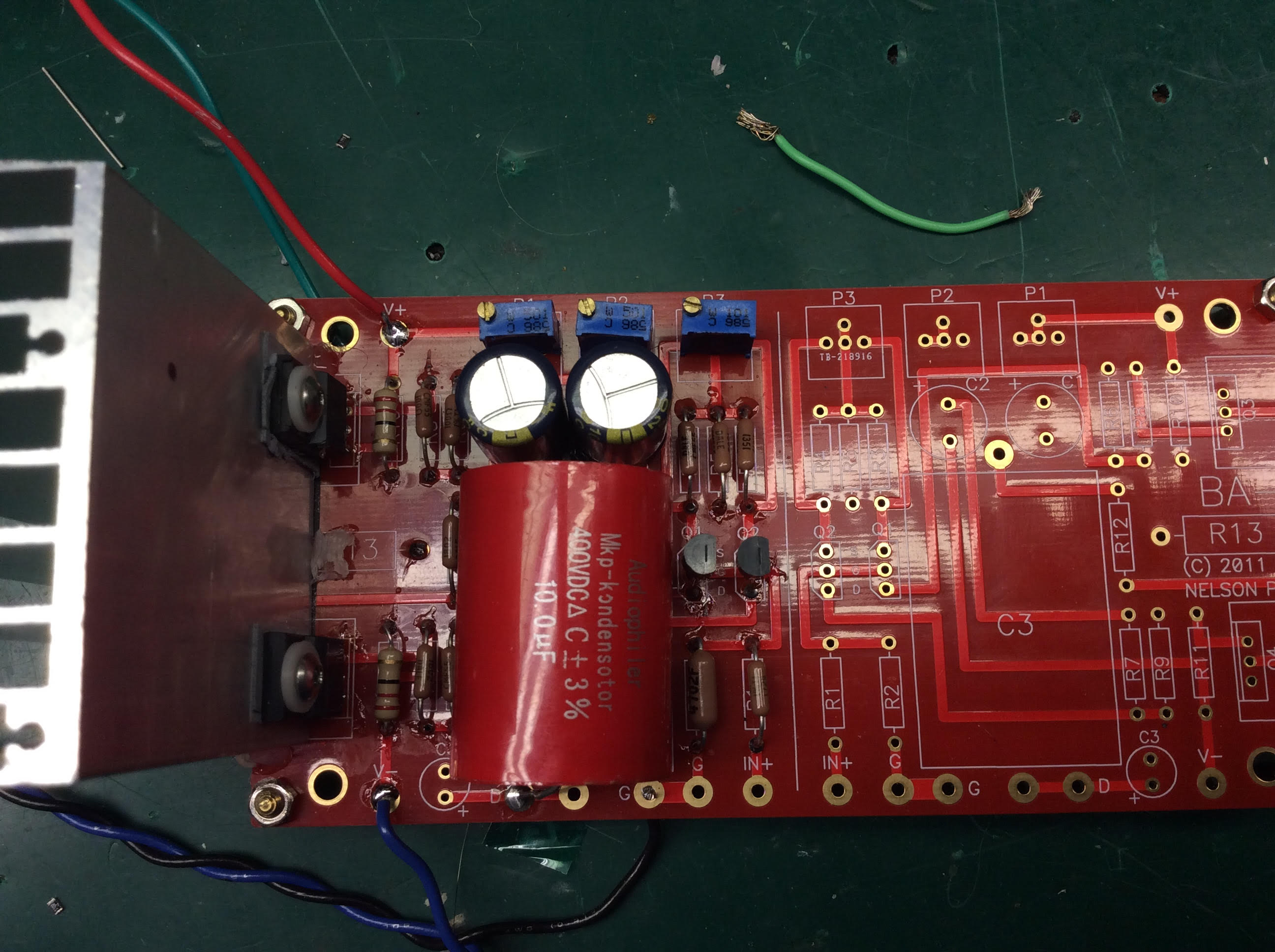

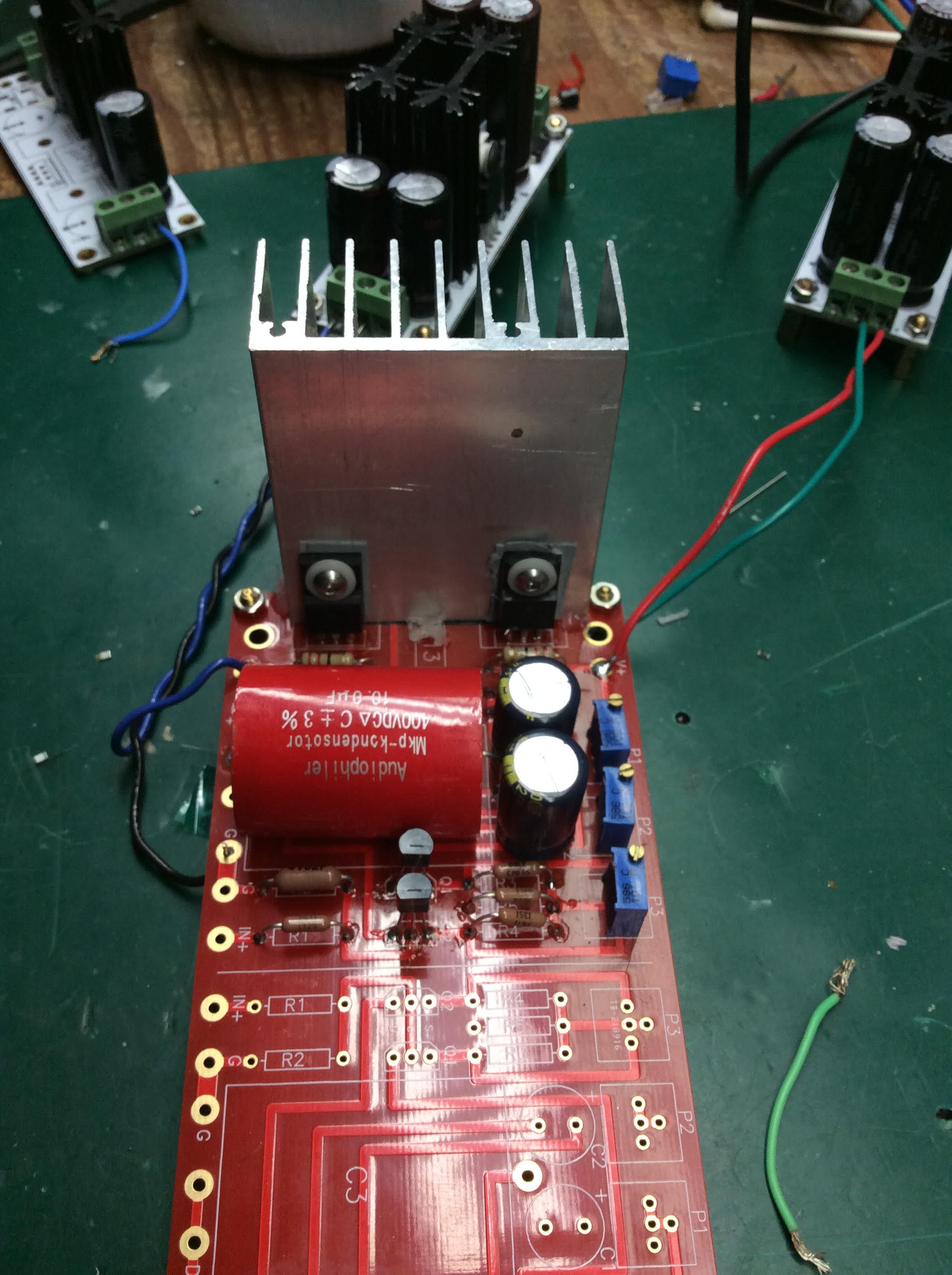

MOSFET VGS on question.
I have a question about the turn-on voltage of the MOSFETs.
My + and - voltages are at 25.2 v and I have 25.2 volts on the source of Q3 I can adjust my 500r pot to achieve 20.8 on the gate. I tested my MOSFETs and the VGS on for the 2SJ313 is 2.91 and the 2sk2013 is about 3.5v. The voltages on Q4 are almost identical, however, my MOSFETs are not turning on and I have no voltage drop across R10 or R11?
I do have the correct 8ma through the input R6 and R7 resistors.
I'm not sure why the MOSFETs are not yet turning on? Do they need more of a voltage drop? I thought the VGS on was the voltage difference it needed to turn the FETS on?
I appreciate any guidance you guys can provide.
