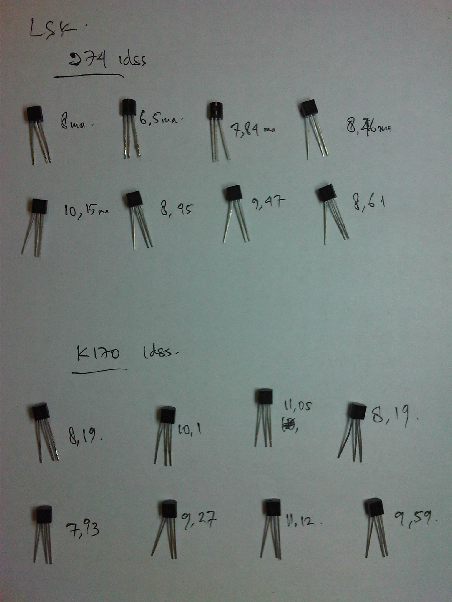

LSK Jfets Matching
hi all...
i just measured the LSK jfets purchased long time ago...
question is:
is it KK-JJ or KJ-KJ prefered match for the BA-3 preamp?
here is the result:
thanks.
6L6
Moderator
Joined 2010
K-J match. ( actually called an N-P match, but we know what you mean :) )
Match as close as you can for Idss, it doesn't matter if the Idss of one channel's pair is very different from the other channel, the bias pots will take care of that.
:Dyes 6L6
N-P-N-P or N-N-P-P match what i mean... (my mistake, sorry;))
and the answer is NPNP match, okay 6L6 very clear.
thanks.

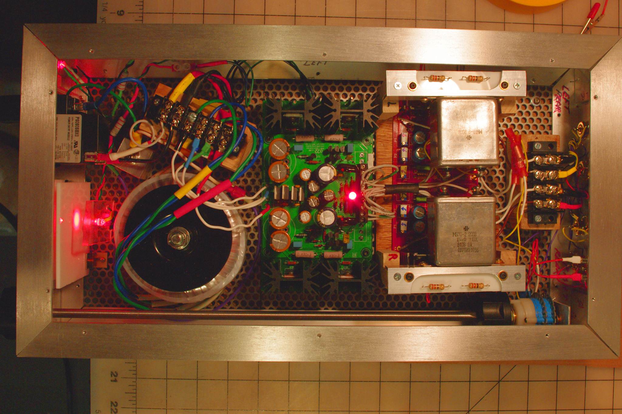

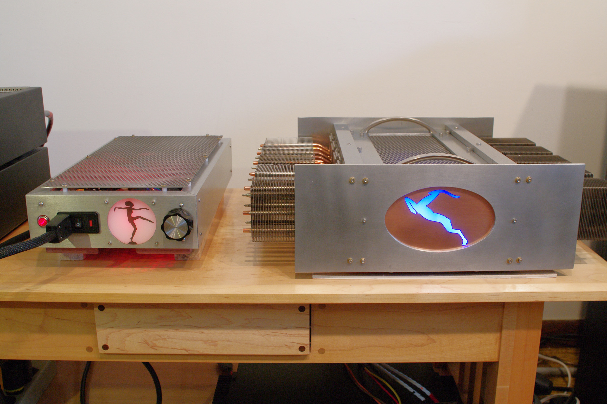

I finished up my BA3 FE as preamp today. It is paired with an F4. It is a combination truely marvelous to hear. I was pinned to my seat listening for several hours, just couldn't leave the music to do something so mundane as eat.
I used the AMB Sigma 22 regulated power supply and a 50K stepped attenuator from valab. The extension driving its knob is from a 16" x 3/8" spade drill bit :). You can just barely see it on the bottom edge of the e-nudie. Works like a charm.

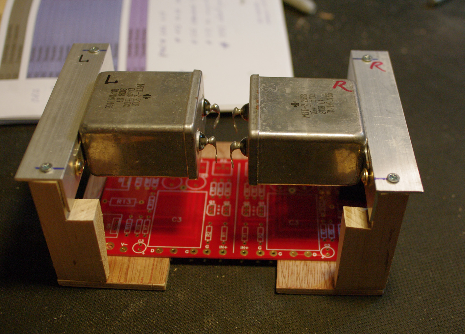

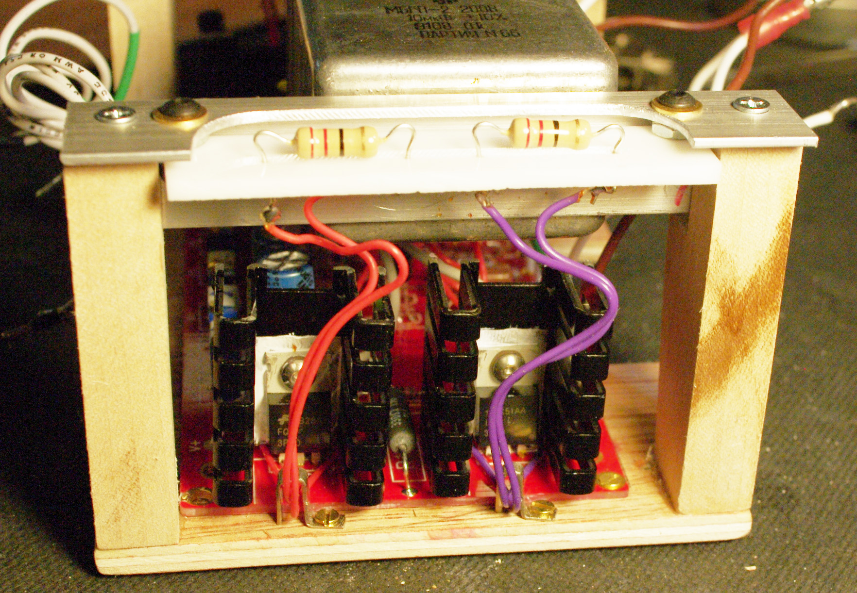

I built a little trapeze to hang those oversized PIO 10uF caps from and to run extensions for R10 and R11 so setting bias would be easier.

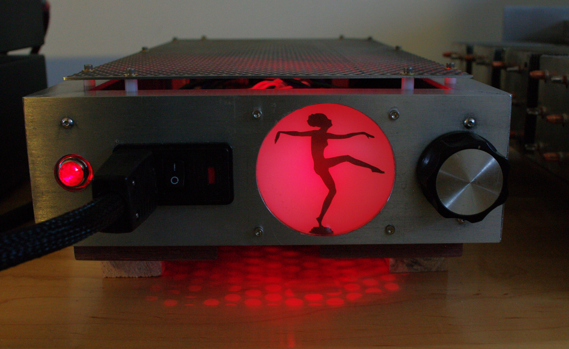

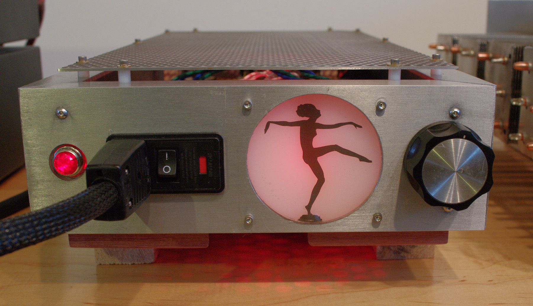

IEC is on the front so that the AC wiring is not in the cramped chassis (only 8 inches wide). The dancer (I was going for a "balance" icon) is made from window tinting film ;-)

It's better than Truly Fugly - it is well executed, well thought out, and has some creative solutions that are totally worth repeating. And that's just the insides -- the chassis is really wonderful as well.
I love the exposed bias resistors (because of the huge caps) Smart!
And don't get me started with your F4, I think it's a simply stunning chassis. :D :D :D
