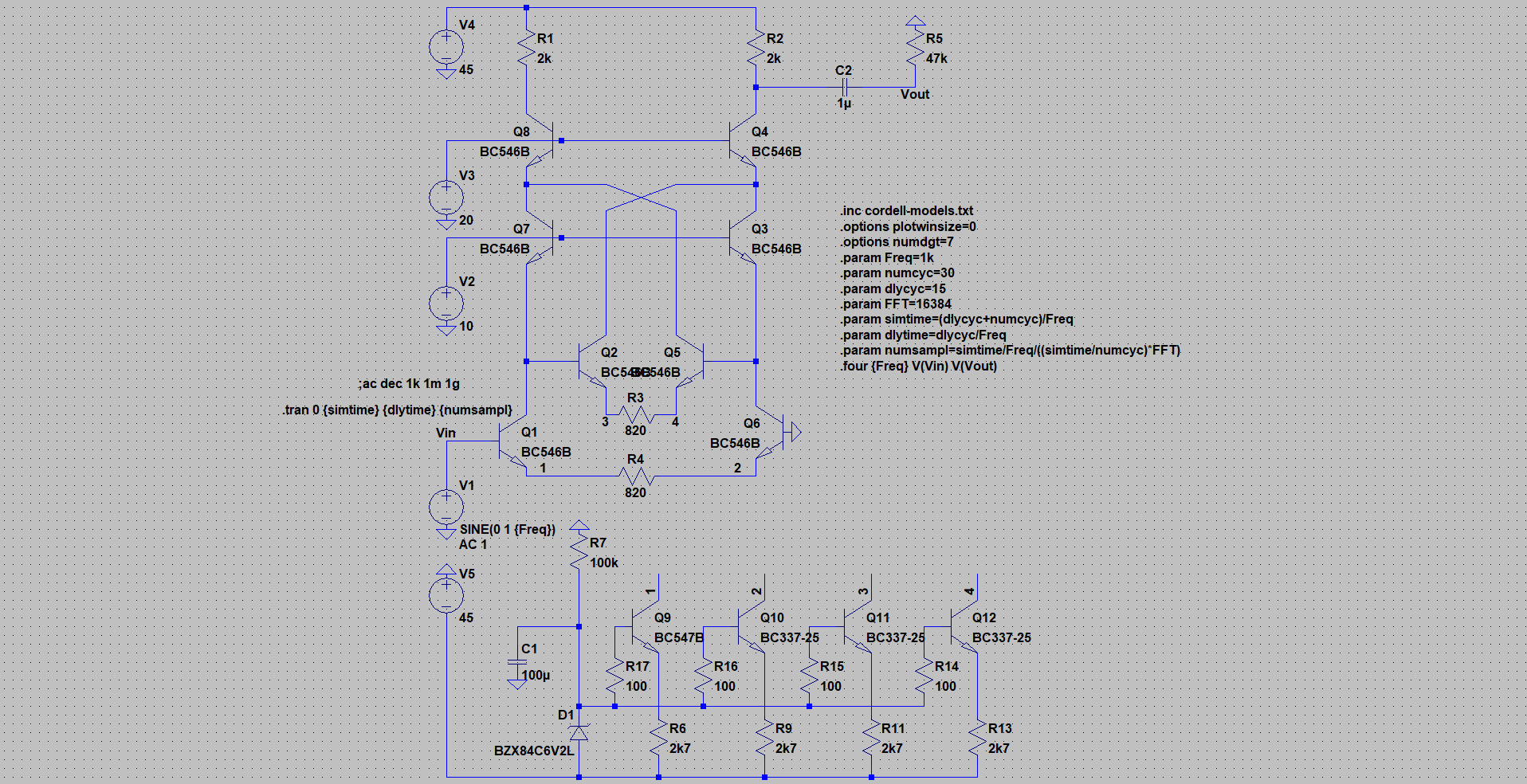

The AMNESIS amp: a good amplifier, like a gentleman, has no memory.

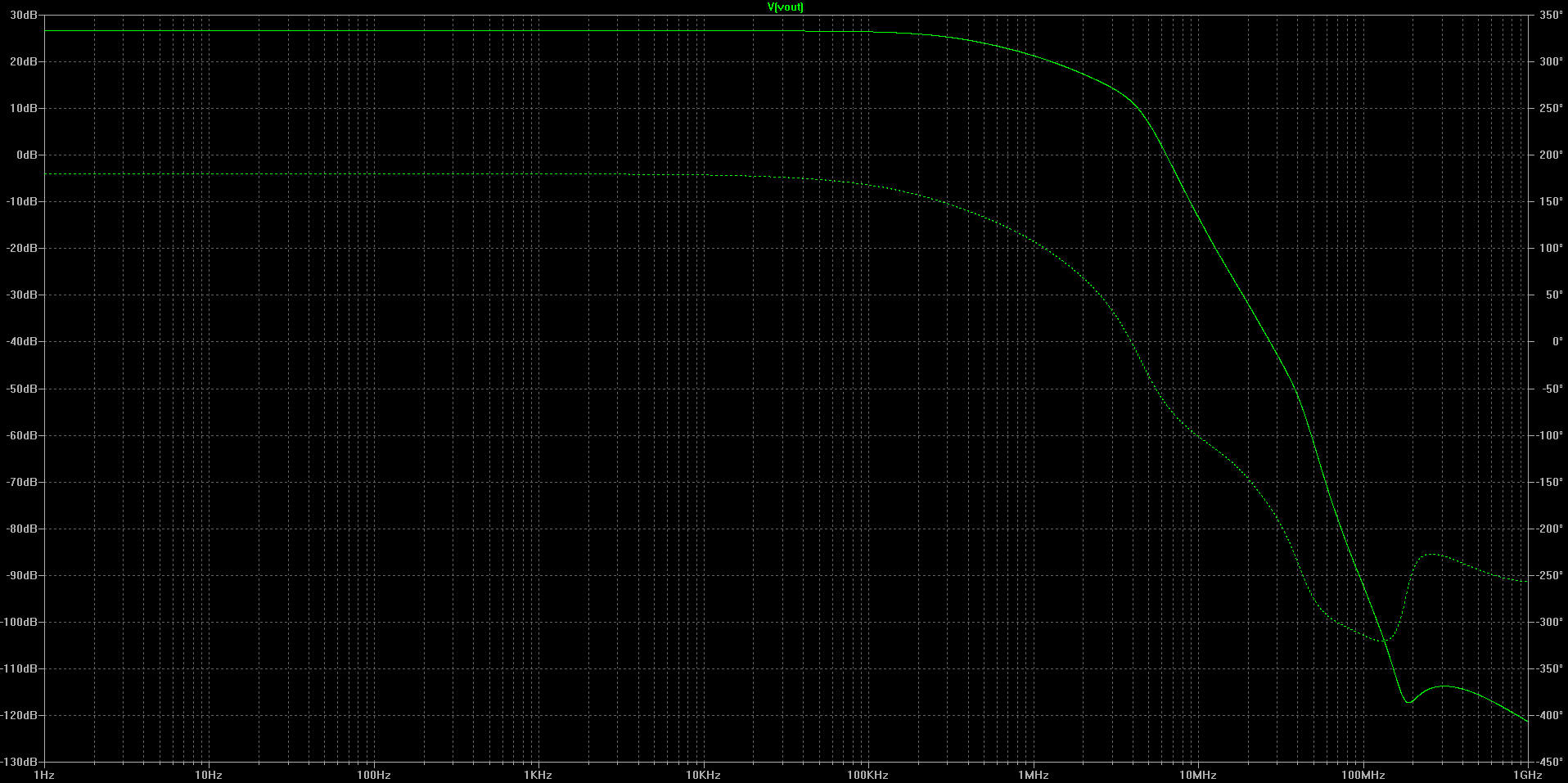

you can use it like Q9-12
btw Cascomp is twice time cascoded and has feedforward EC, so it shoud perform extremely well regarding low memory/nonlinear distortion
hi Max!

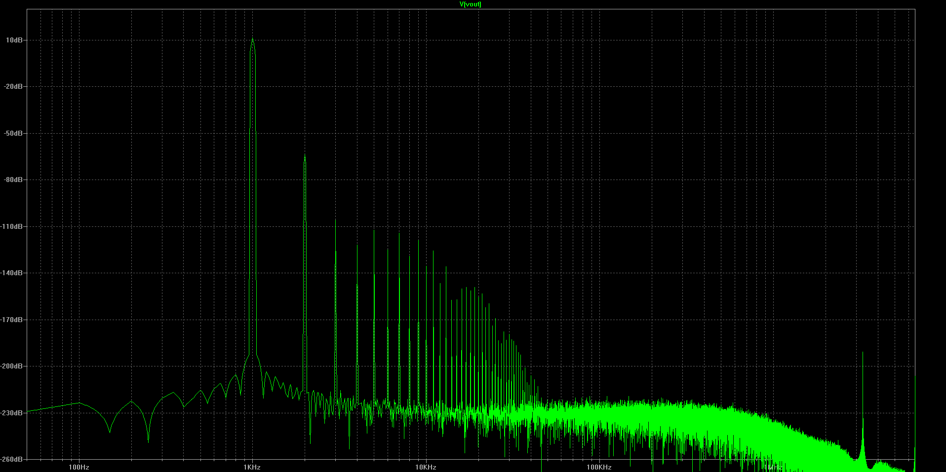

these are my old plays with Peufeu's memdist, the idle is ~90mA
cheers!

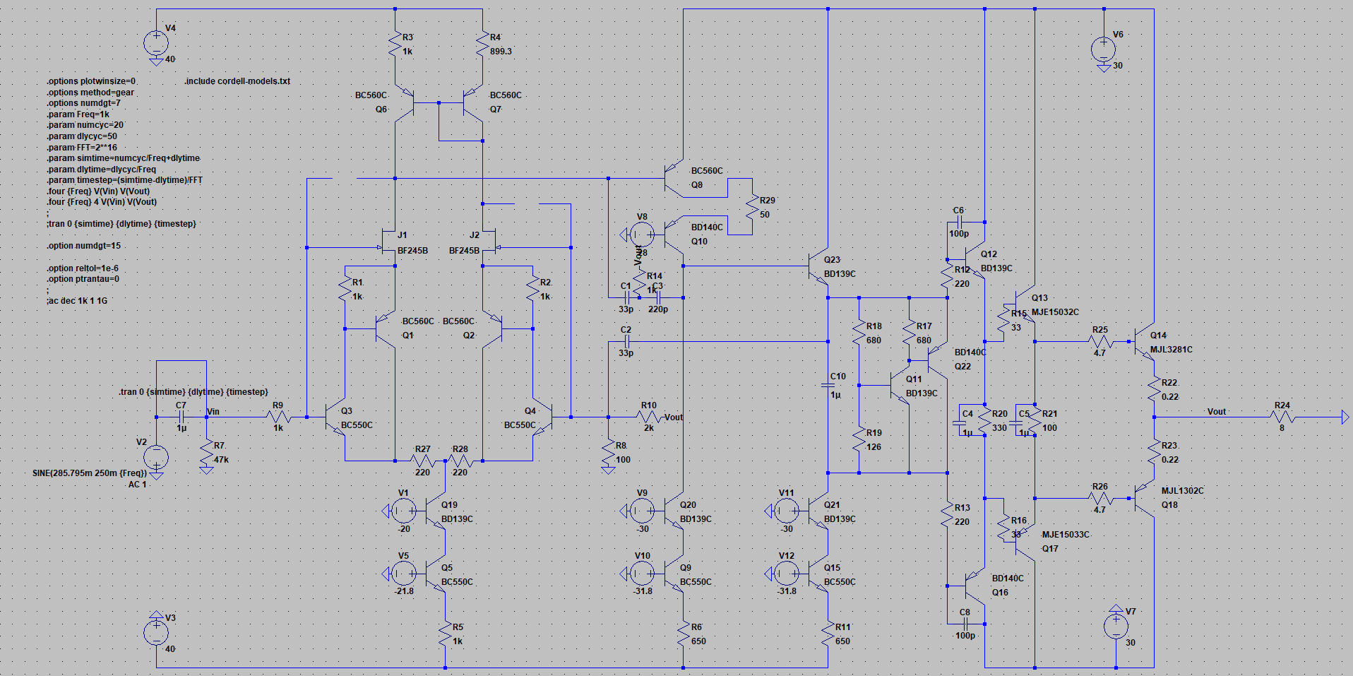

Hi Pavel. Thanks very much. I am unable to simulate. Could you please do the following to resurrect your interest:
1) 1K resistor on the emitter of the "second BJT" (PNP) from the CFP (emitter to output node of the CFP-source of the JFET), this way the gain is reduced and the offset is minimal.
2) Can you do the cascoded-cascode VAS, with a 22R to 50R between the first cascoded elements?
This is the way Peufeu planned it. Look at the schematics above.
3) I do not understand your feedback. :(
Can you do a cascoded-CFP also at the output and have a conventional feedback? When I cascoded the outputs, they became stable. :xfingers:
Edit: look at the interesting PDF attached about Bias circuit.

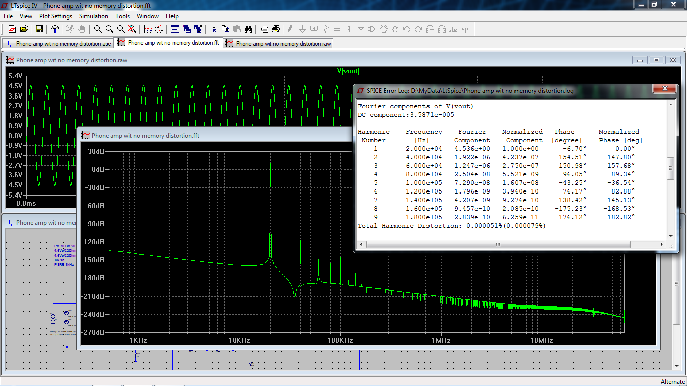

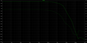

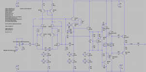

Hi Max!
do not get me wrong, I only wanted to show you a few posts before that the memdist amp is possible (in theory) to build.
The figures are not so bad but due to memdist triples at the input and cascodes it might be marginal stable.
I attached for you the results of the sims after the changes proposed by you, it looks like thd spectrum has more hf harmonics.
2k7 resistor of cfp pair is the value given from the God to get the lowest thd from cfp pair.
I attached before the asc file to tease you to get yourself ltspice, which is for free, and try your own ideas.
I will watch the thread with the interest but please do not expect me to check your ideas with the simulator,
cheers!

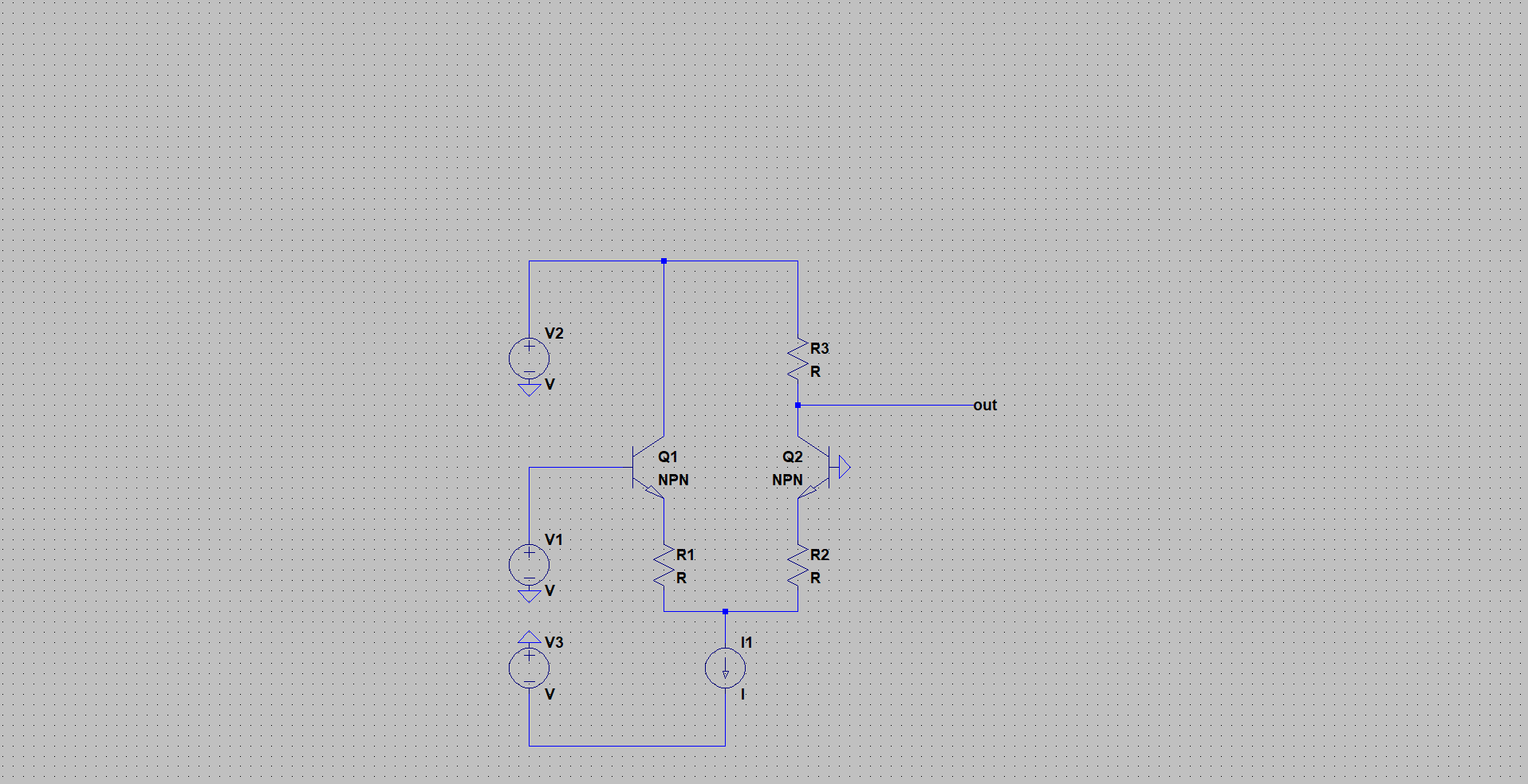

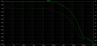

well, LTP is a kind of Rush cascode with the transistors of the same sex,
when the first is emmiter follower steering the second common base via its emmiter,
does it reduce memdist?
I would say yes!
Does it improve SQ?
I do not know!

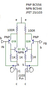

The following is the schematic of the units to replace PNP differential amplifier for the input sections of the Blame and of the Sony TA-5650 amps.
I added an extra resistor to the "follower" BJT. These resistors' position and value are not optimized for reduced THD: simply used to get negligible offset.
Feel free to comment or advice better strategies.

OK. Quick update.
(sorry guys, I can only evaluate sound by listening to music)
First, I increased current for the Blame's differential input section from 2,09 to 3,24mA, per side, after reading this interesting site:
Ovation e-Amp: A 180 Watt Class AB VFA Featuring Ultra Low Distortion
They way I did it was paralleling a 300R to R4, with minor adjustment for DC offset on one channel. :cool:
Probably more dynamic sound...
Second, I finally did the cascoded-CFP mod for the already modded cascaded/cascoded output. Since it was already modded, I just added a PNP (D45H11; different encapsulation) to the 5200 NPN, as follower of the Sziklai pair, with a 10R from 5200's C to D45H11's E. It worked flawlessly,
Guys, you really have to try these mods...
I will continue my listening session today, but so far the effect is very impressive.
I now think that transistors are gregarious animals that like to share the work we ask from them :D
Apart, I had some delay due to problems on one channel: pops and strange noises and fluctuation in DC output for several mV. I tapped on top of components and finally found the culprit: C7 from feedback resistor to "ground" was leaky. I replaced it for a good quality one (higger VDC) and everything is perfect now. I also swapped C8 for a better quality one. I now recommend myself to populate the boards (even experimental circuits) with the best quality available. Not only it will sound better but one probably will be saved from lots of troubles and headaches...
