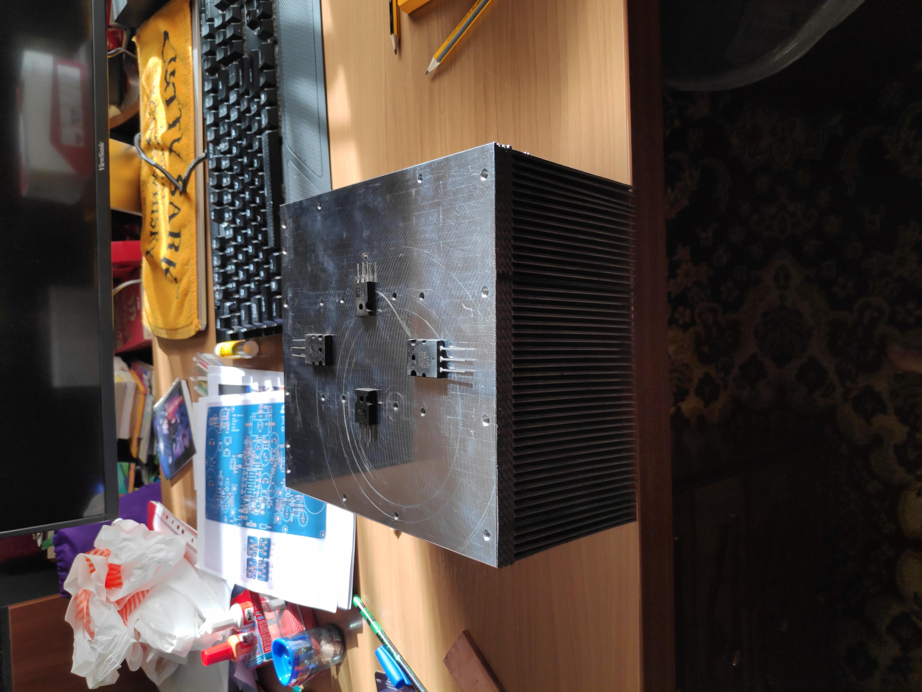

Hi Jaytor,
I missed the part of your question regarding the chassis. My answer was purely from the transformer aspect.
Your chassis probably can’t handle the power dissipated by these MOSFETs.
Your transformer will make about 35v no load. It will sag about 4v under Class A load. Then another 3v drop across the cap Mx.
So that’s 28.3v x 3A is 84w per mosfet or 170w per channel. You need a huge heatsink like 5U x 400mm maybe that isn’t enough.
CPU coolers and fan is the way to go.

Thanks for the clarification. Oh well...I really want to stick with passive cooling, so I'll have to keep looking for something that will work, at least for this build. What I'd love to find is a push-pull amp that I can bias to run 15-20W class A but with enough voltage swing to run to 40W or so in A/B. Also hoping to find something that will be a step up from my Parasound JC5 when driving efficient speakers.

My apologies, I asked in a previous post if it is possible to use a total of four power FETs instead of two to spread the heat load? (please note I am not an electronics expert.) I'm have a BJT based (MJ802) 25W Class-A amp and 4 devices are used to spread the heat load, to keep all the devices within a "comfortable" operating area. I do understand that the power FETs can take a lot of punch, but if I wanted to, would it be possible to add adiditional power FETs?

Hi Kevin,
This amp has a 3A bias current x +/-36v rails. At 4 MOSFETs that’s about 54w dissipation each. If you use IXYS high power ones that can work but your heatsink will be huge. About 8U x 300mm deep or equivalent. Maybe 5U x 400mm can work.
All those heavy aluminum fins cost a lot of money. But if you have it already, then, yes it can work. You will need to match the MOSFETs.
Note that adding MOSFETs increases capacitance of gate and the drive circuit would have to be reconfigured. I will let Hugh give the final recommendation. Also I think you are saying 4 MOSFETs total not 4 per rail for 8. That would be way too many, and going back to old way of doing things. Keeping one pair of MOSFETs gives cleaner and more articulate sound.

No I actually did mean a total of 8 (4 per channel) so that the current per device (and thus heat) could be lower per device - 1.5A quiscent current and not 3A. However I do understand your explanation re the gate capacitance and having to reconfigure the circuit accordingly. As I said I am very much a newbie, and can follow BJT circuits better than FETs. But I am slowly starting to catch on. Excuse my ignorance, but I firmly believe in asking if I don't understand, and in that way learn. I'm getting there slowly.

Gain is set by resistor R154 and R113 and equal to (18k+680R)/680R=27.5x or 28.8dB.
To get 4ohms is possible and discussed in the other Alpha 20 amp thread. Rail voltage would need to be reduced and bias current would have to be increased. The maximum thermal dissipation will be about 160w per MOSFET assuming you are using 1 CPU cooler per MOSFET. The IXYS are large power MOSFETs spec’d for this amp. They can handle up to 600w dissipation but CPU coolers typically rated 150w. Some people have used water cooling setups and I think with that, even 37v at 5A is not a problem or 185w per MOSFET.
For 8ohm bias current is 3A and rail voltage is 37v per side. If we go to 5A bias and set rail voltage at 30v that would be 150w per MOSFET or 300w per channel. It will take some resistors to be changed for setpoints but doable.
