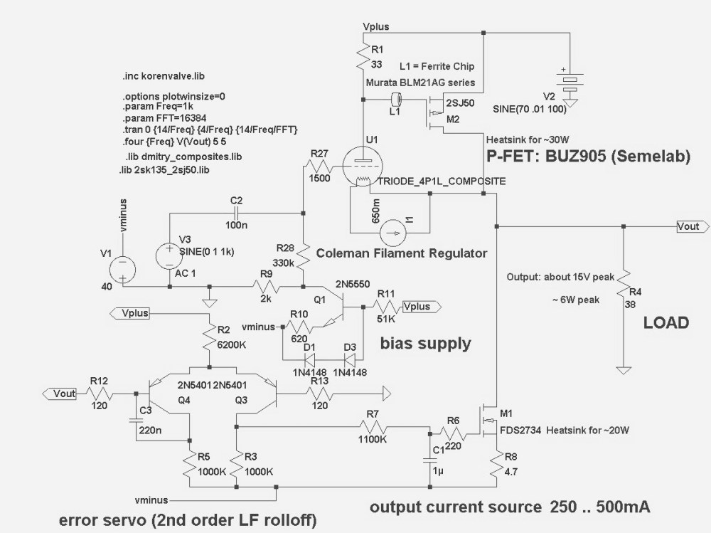

A compound triode - bipolar stage, with a 2nd-order dc bias controller, to give zero dc offset, no output capacitor at all.
I'll finish drawing it, if there's interest.
Here's my serving suggestion, for any DIYers who don't like the cost of a real transformer. The 4P1L + Sowter is very appealing, but any compromise on the transformer will bring disappointment.
Don't be put off by the transistors in this drawing.
Q1 is a little bias source.
Q3 and Q4 are an error servo, with a 2nd-order sub-audio filter. These keep the output within a few mV of ground, without interacting with the music.
M1 is a class-A current sink, set at 250-500mA, depending on the desired peak current into the headphones. Please trade off the peak current capability with the idle power burn. (15 - 30W each in M1 and M2).

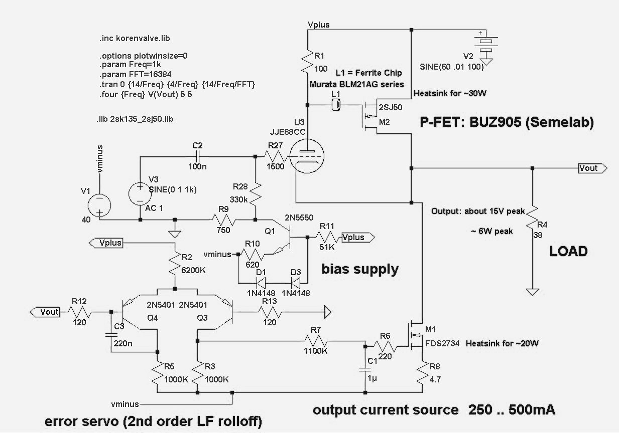

The actual output stage is a new JJ E88CC running at 60V and 10mA. It's a cathode follower - but assisted by the audio FET BUZ905, made by Semelab.
The BUZ905 is simply carrying any current demand, above the 10mA standing current in the E88CC. The linearity is much better than a normal cathode follower, because the load variation is so small.
The BUZ905 is chosen because of the high power handling of the TO3 package, and the zero-TC (temperature coefficient) which occurs at < 0,5A (rather than the whole amperes needed by the usual switching FETs). This ensures that the idle current is stable, even at intervals faster than the servo can control it.
The E88CC is chosen, because it has high gm (for good follower performance), and because it likes low voltage. I don't think the 4P1L would work well here.
The overall cost of parts is relatively low, and the performance is very high. No capacitors, chokes, or transformers are needed in the output, because the BUZ905 is performing the impedance transformation from the E88CC to 38 ohms.

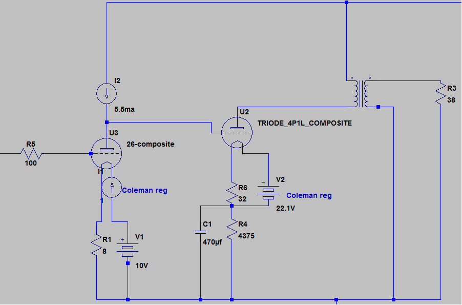

Btw I also think it is possible to DC couple #26 to 4P1l and still use filament bias, here the cap under the 4p1l is below the signal and just for noise reduction, I think it can be left out.

Well, it does actually work quite well with a 4P1L. The triode curves and Dmitry's model suggest around -3.5V bias allows operation as low as 70V, which should be fine. A little more class A power dissipation, but you have your DHT.
BTW, please don't confuse this circuit with the usual "tube hybrid" circuit. The kind where a triode stage has a source follower stuck on the output.
My circuit centres on a compound-device, with the FET acting as a current-amplifying slave for the cathode follower. The FET only pumps current, at high dynamic impedance - until the cathode follower is satisfied.
The (triode) cathode current varies by only a fraction of the load current, allowing the dynamic output impedance to remain almost constant throughout the swing. This is quite different from the usual follower circuits, where output Z has a strong dependency on load current. If you like LOW and CONSTANT output impedance, this circuit takes some beating.

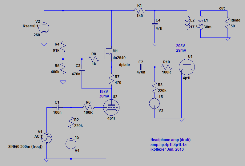

Back to the headphone amp. I really don't see the reason to a load impedances in the speaker range. There are plenty of very good power amps of low power that will cover that range. I'd say that an amp that can do 50 ohm loads and 300 ohm loads will cover lots of headphones. I'm working on a DHT amp for a 50-60 ohm load because those are the headphones that I have, and I'll post my results here. With a different output transformer a 100, 200, or 300 ohm load would be just as easy to drive.
iko
Ex-Moderator
Joined 2008

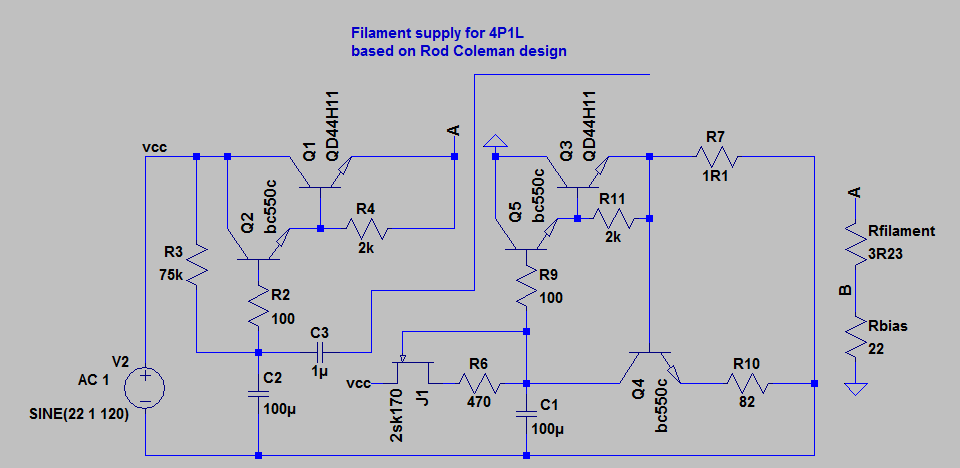

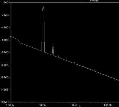

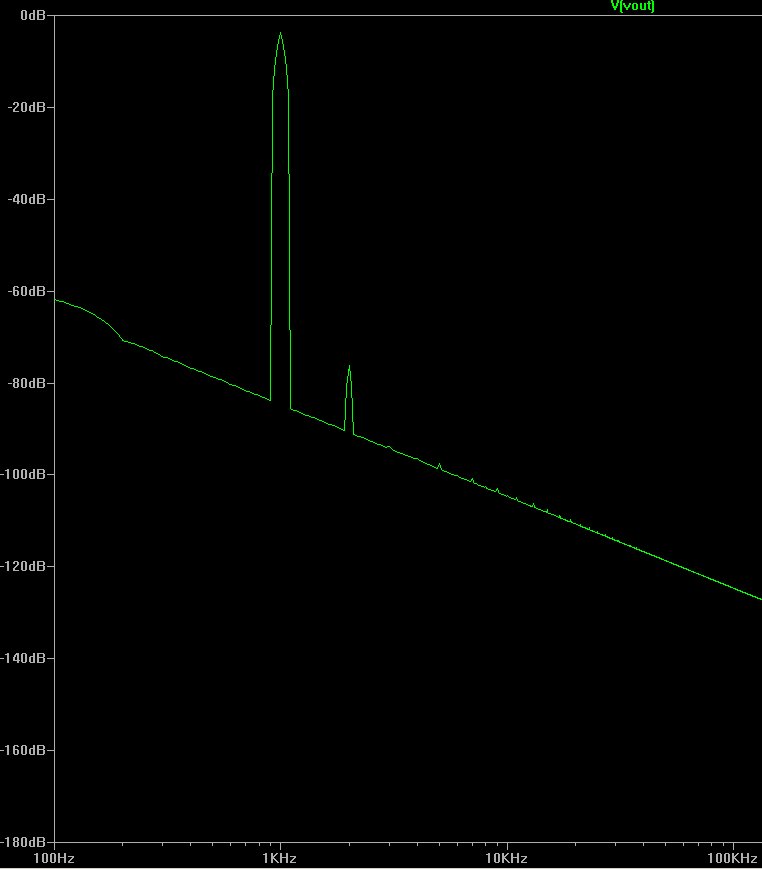

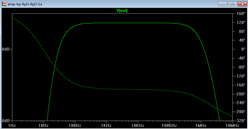

Here's my draft, using the 4P1L, since it was the topic of discussion lately. I have a good stash of 4P1L and plan to do something with it. Simpler circuits appeal to me, hence my preference for this. It's easy enough to replace the gyrator and coupling cap with an IT.

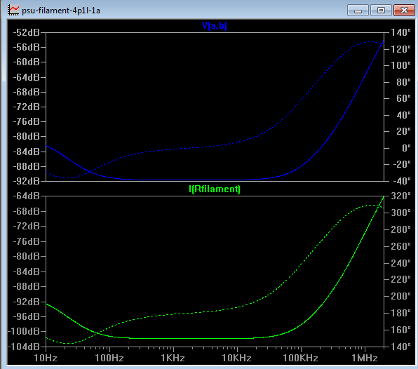

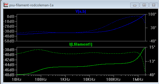

In reality I will implement filament bias via the attached circuit which worked very very well in my 26 preamp. I developed this circuit independently but it's just been pointed to me that it'is almost identical to Rod's older version that he posted in this forum, so credit deservedly belongs to Rod Coleman. Almost identical does not mean it is the same. Small changes can make a big difference in performance. In simulation Rod's older circuit can bring a 1V ripple at the input 32dB down to 25mV. Small changes in the circuit make it bring the 1V input ripple 92dB down, to 25uV. I will not belabour the point, I'm sure that his new circuit is a huge improvement over the circuit he posted in the link below. All I wanted to do is to offer an alternative which, based on my experience, is excellent in performance and simple to implement.
http://www.diyaudio.com/forums/tubes-valves/38248-new-dht-heater-7.html#post2024952 While we're at it, I want to say that Rod's kit is really good value.

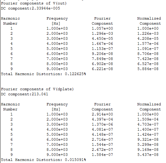

Edit: the thd results, for what it's worth, are at 1kHz, and about 2.2V p-p into the 50R load. Also, there might be better operating points for this tube, but I didn't look too hard.
