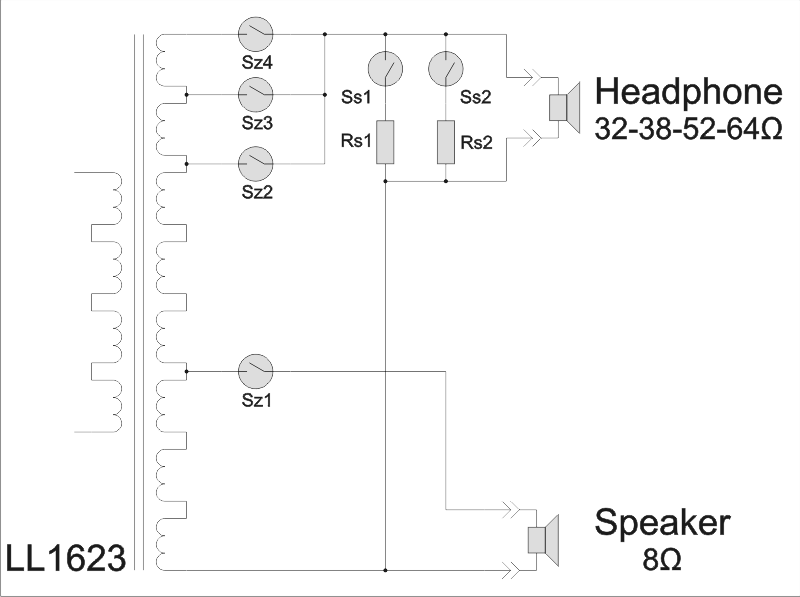

Does that apply to a parallel connection of secondaries? There are 8 of them in LL1623, and to accomodate a range of Z's I need 3, 6, 7, or 8. Loose secondaries are not recommended by the application note, parallel connection is. Will there be any negative effect in sound quality due to that? (excluding all possible issues with commutation for simplicity) Looking at commutation circuit, I think of parallelling all the unused secondaries. For example, for 38Ω six secondaries must be in series, which leaves three that must be paralleled. Any comment on that?

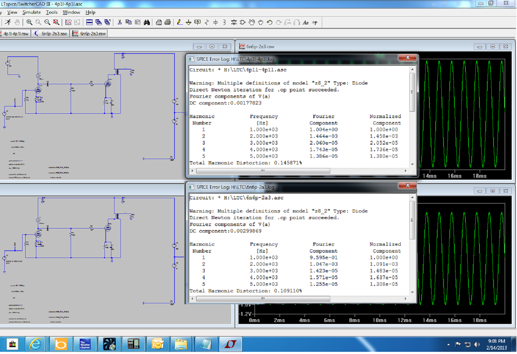

This is a simple spice comparison of a 4p1L to 4p1l 5k:40 OPT vs a 6n6p to 2A3 same OPT.
I know the concern is low level distortion and the thought that a very linear valve like the 4P1l will give better performance. Two simulations run exactly the same for a 1Vpk output. The result is that the 6n6p to 2A3 gives lower distortion at this low level (the difference is really neglible.) The point being that the distortion charateristic of a DHT output SET will be transformer dominated and selecting valves based on Moglaa's THD tested although somewhat useful doesn't really give a wholistic picture of a completed amplifier. BTW a 6C45p-2A3 had three times the distortion.

Yes this applies to the secondary too but you have to divide by a factor equal to the turn ratio. It is a much smaller effect and in practice is negligible. More importantly you have to consider that the transformer has been designed to work like that (i.e. primaries always in series and secondaries in series-parallel combinations).
I am looking at the exploding numbers of relays for secondaries' commutation. If instead of paralleling the unused ones they are simply connected in series and commutated as in a stepped volume control, there would be only 4 relays. But will that 'loose end' in the secondary affect the sound? For example, for 8Ω speaker only 3 out of 8 secondaries will be used, the other 5 connected in series would be a 'loose end'. For headphones the loose end is no more than 2 out of 8.
For uncompromising paralleling, it will require 2 SPDT relays per coil group per configuration, so 4 groups (3 + 3 + 1 + 1 secondaries) and 4 configurations (8, 7, 6 and 3 secondaries in series) requires up to 32 relays, or even 64 if SPST type is used. The incentive to use only 4 of SPST type could not be more compelling, even in a design for fanatics by fanatics. Capacitance in all this wiring would also add up.
I have never tried but I think it will cause a clearly bad effect. Using only 3 out of 8 secondaries you have a big insertion loss, in the best case. Having no feedback you can have the secondary floating. Then if the unused secondaries will have other effects I don't know. I would use an OPT which is at least optimized for loudspeakers.
Actually I often have the secondary floating because I have found that in many cases this gives an extended frequency response in comparison to a grounded secondary for certain winding geometries.
Let me clarify with a schematic. Speaker (8Ω) is switched on by relay Sz1 -- it needs 3 secondaries. Headphones with different Z (32, 38, or 64Ω) switched by relays Sz2...Sz4 (6, 7 or 8 secondaries), and odd Z's (52 or 300Ω) are additionaly shunted by Rs1 or Rs2 with relays Ss1 or Ss2. A microcontroller runs all relays, so at any time this circuit is configured for only one Z value. Commutation is done at zero input signal (shorted DAC output), so there is no current in the secondary during commutation. Where would be the loss you mentioned? The part of the secondary that is disconnected (upper loose end) has infinite load resistance and zero current through it, therefore no AC energy can be lost in there by conduction. It may have some influence via capacitance -- that I do not know how much, but a typical reed relay is designed for GHz AC commutation with appropriately low capacitances. All AC energy that goes into transformer's primary will come out of the loaded section of the secondary, with 64Ω load at most, as there is nowhere else for it to come out from. Please tell me which mechanism of losses I am missing here.
Insertion loss is a direct consequence of not using all secondaries. It has nothing to do with relays. You just have more DC resistance in comparison to the primary impedance. It just means that your OPT is less efficient and less power is transferred from the primary to the secondary. In the case of the LL1623 connected as specified for 5.6K/8R you have 26.8 turn ratio so Zp= (26.8*26.8)*8= 5746 ohm, the primary DC resistance is 164 ohm and the secondary DC resistance seen from the primary is 0.2*(26.8*26.8)= 144 ohm.

Insertion loss is a direct consequence of not using all secondaries. .
You describe much better my concerns wih the lundahl transformers much better than i was. Insertion loss with headphones is a big deal.
I can't get the simulations to prove it but I was told for example a 5k transformer with two 8 ohm secondaries in series and the center grounded hooked up in balanced config to a 32 headphone would work to give a 5k:32 ratio. The same follows that two 75 ohm secondaries would give a 5k:300 balanced output. I can't explain the math either or get simulation to prove it..
But evidently this is how some of the commercial DHT headamps are configured.
If you only use 3 secondaries in series the secondary DC resistance seen from the primary is (0.4*3)*(26.8*26.8)= 862 ohm which means an efficiency of 85% (or a power loss of 0.7 dB). This is usually the efficiency of cheap transformers.
Other non desirable effects are not easily predictable. Maybe you won't have any.
Thanks. I'll have to read it a few more times and think about it for a while, but I already see it comes down to a compromise. The 8Ω speaker is a secondary priority in a headamp, so headphones come first, and 6~8 secondaries out of 8 does not seem to be a problem. The 8Ω can be accomodated by paralleling of 3+3 secondaries -- it will add 2 SPDT relays (or 4 SPST). In that case 6 will be the least number of secondaries used with any load, and for 38Ω it will be 7. An alternative to that is 1) a maze of relays for ideal paralleling or 2) a magical custom transformer that somehow takes all loads from 8 to 64Ω or 3) hard shunting of headphones and higher distortion or 4) simplification of requirements (i.e. surrender). Out of these, I take a small extra loss of transformer efficiency if that doesn't spoil the sound. After all, design of a 4W DHT class A headamp is not oprimised for transformer efficiency at the expense of everything else in the specification. I knew the transformer will be the hardest part of this design.
