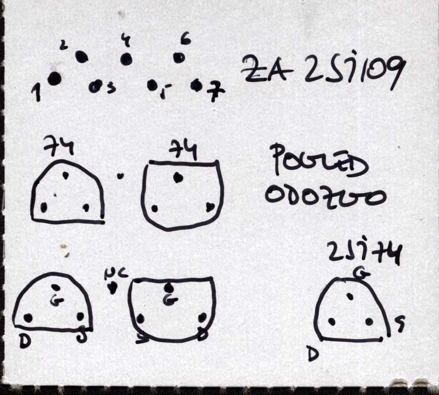

Anybody else using Peter Daniels boards. Just want to confirm J74 pinout. 98% sure, but cant really follow the trace from one of the J74 drains.
