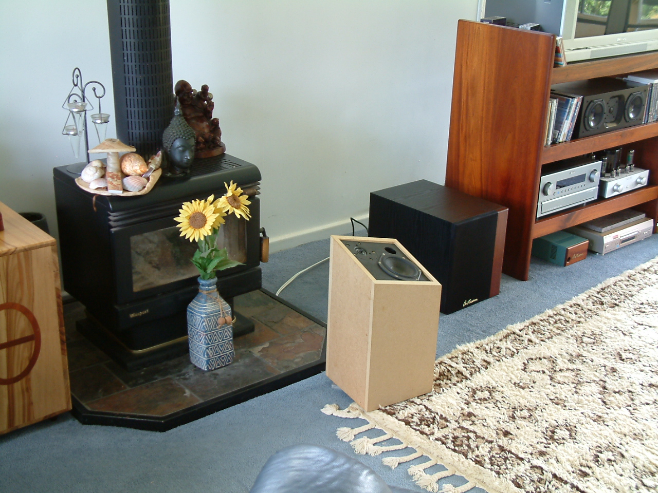

We’ve now been evaluating the prototype Omni loudspeakers for about 3 months and have tried them in the living rooms of several family members. In one case attached to a modest Sharp stereo system, in another an ME 550, and also with a T-Amp. The feedback has been consistent. Spacious, good bass, easy to listen to, no “hot spot”, very versatile as far as placement in a room is concerned, no distortion at high levels. So, they are doing exactly what they were designed to do. These are loudspeakers which won’t visually dominate a room, and produce a sound with the omnidirectional characteristics of Sonab and Bose at an affordable price.
The prototypes of the premium version of these kits arrived from Stones Sound Studios just before this newsletter was due to go out so we have had a chance to compare them. The design is exactly the same so has the same spacious characteristics, but the difference is the drivers. The Vifa drivers are more than twice the cost of the PAE drivers in the standard version, and you can hear the difference. Clearer at all levels, brilliant transients, and wonderfully clear undistorted sound at high volumes.
If you are familiar with the way a piano fills a room with sound you should hear these speakers on a piano recording. A great demonstration of the value of sound that isn’t beamed at you.
These prototypes are available for auditioning. If you are close to Brisbane you are welcome to pick them up and try them out at no charge. People further away will have to be prepared to pay the transport costs each way.
The first batch of kits has been produced and so the Decibel Omni is now ready for sale. They are in the Loud Speaker Kits category on the website.
