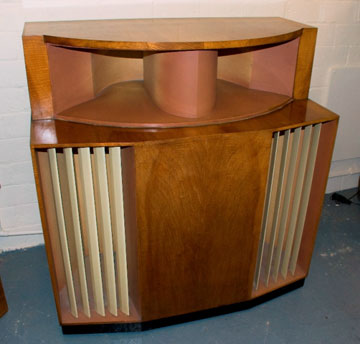

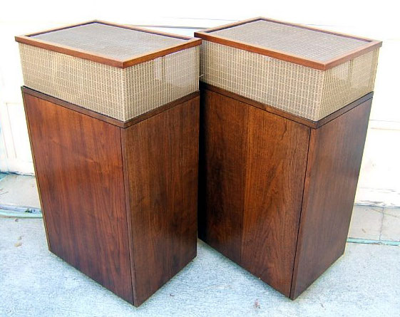

controled - if not constant - directivity
below an illustration of an evolution of thinking - from controlled to constant
or was it just another "audiophool"?
best,
graaf
