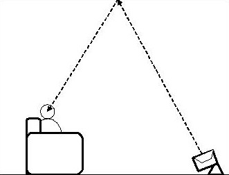

When the reflection has to have a clean response, what if one used a pair of ceiling-mounted speakers that play the delayed signal?
an alternative with full range "ceiling flooder" could be tilting it a bit to aim it in such a way so that the ceiling would reflect the purest on-axis impulse towards the listener, as on the picture
This is done by the Carlsson or the corner speaker with horn tweeter I suggested earlier in this thread. The only advantage of the pure CFS I see is the tolerance of extremely poor recordings, also compared to conventional speakers.
