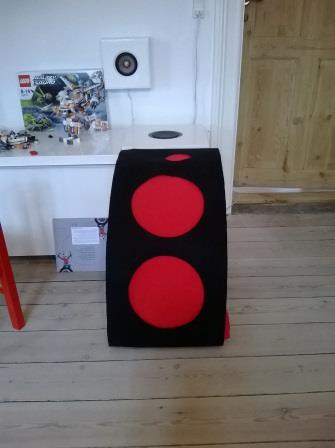

.... I will look a bit like AudioPro Qube but the top baffle will be tilted at 45 degrees and the driver will be Kef CI200QR.
The Qube sound nice. I own a pair. Currently using them as surround channels to OA-52 fronts.

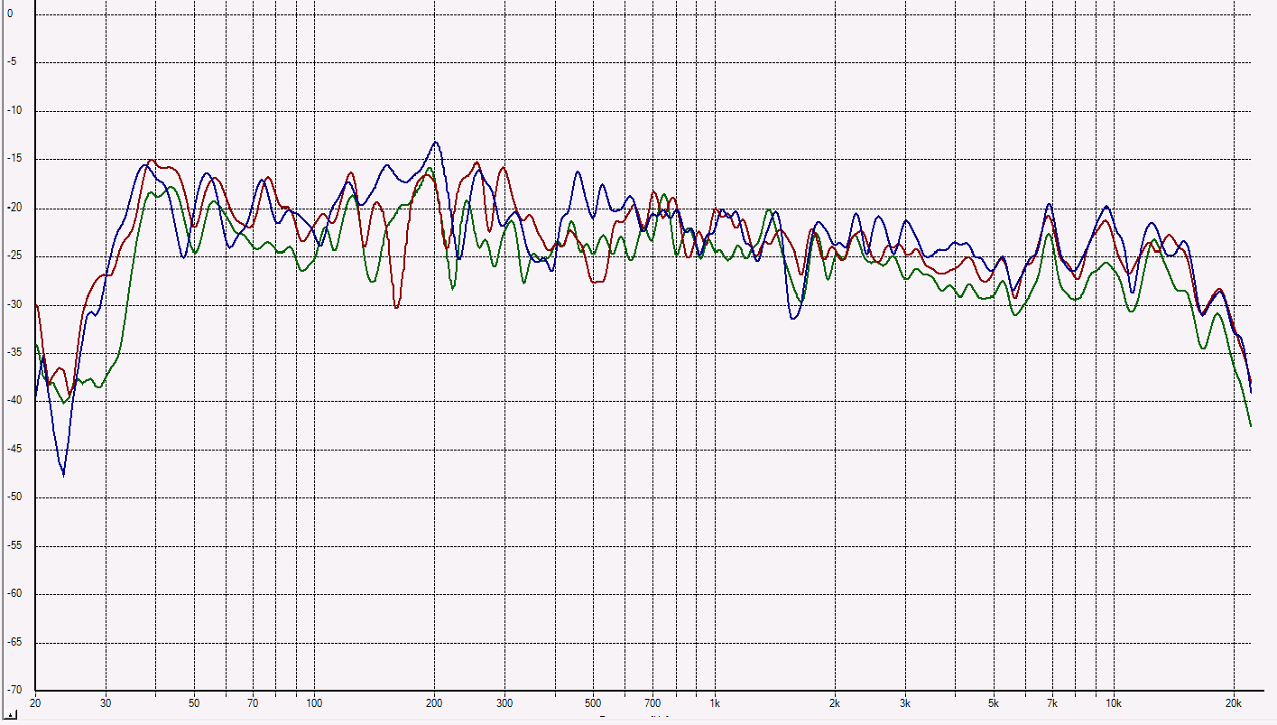

160 degree measurements in normal listening room
1 meter almost from side (80 degree) - direct in front (red) - and one meter from other side (-80 degree).
Using Holm - but the sweep have just right now begun to make som strange noise, when going up in high frequencies, but still hope it gives some usefull information
Mine are 55 cm high
Mine are 55 cm high

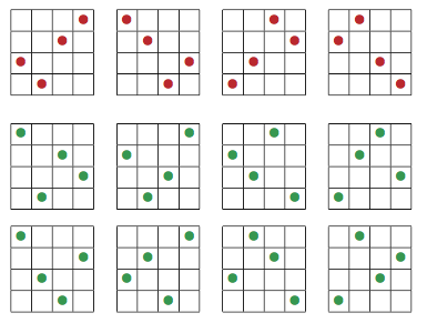

All is needed is a 2D pseudorandom location element array. It has on axis gain and phase responses close to that of a single driver, but off axis phase is very random. Also, off axis gain is much smoother than from a regular conventional array.
Maybe Gilbert / Costas array can help here ? It is a 2D arrangement of cells
Costas array - Wikipedia, the free encyclopedia
For example, take one arrangement from these N=4 arrays:

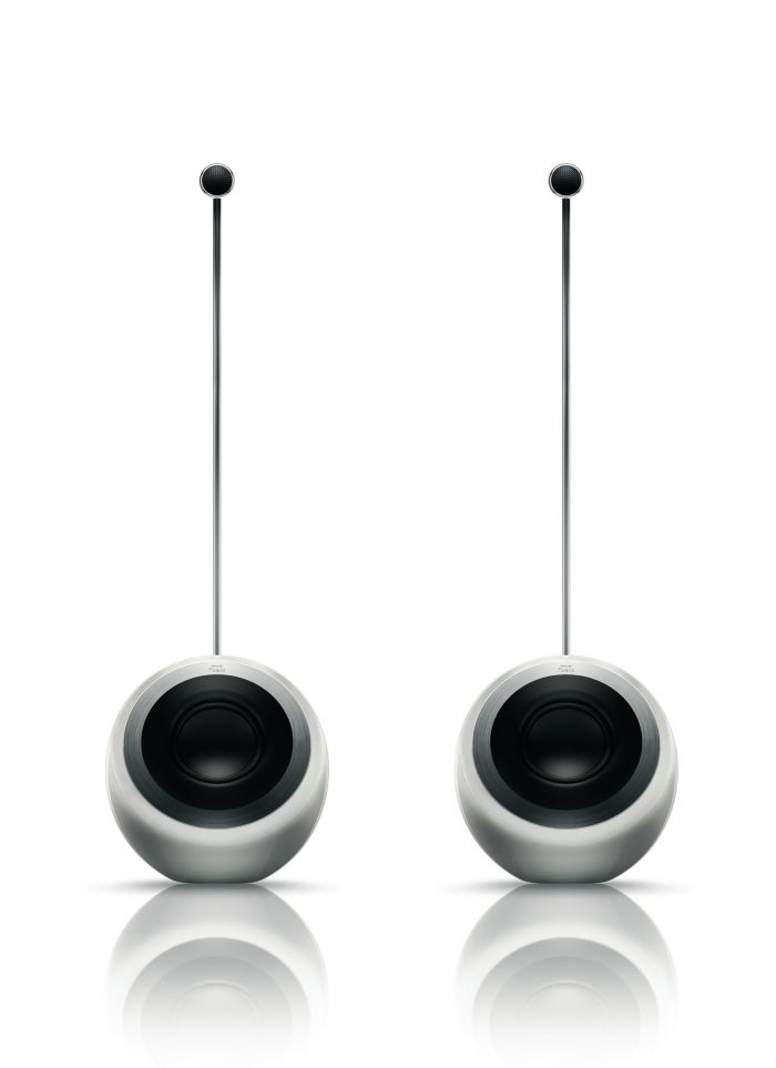

after 30 years Philips revives James Croft's proposed solution to the FCUFS soundstage height issues:
http://www.diyaudio.com/forums/mult...upled-up-firing-speakers-169.html#post3180924
Philips PS1
It IS possible, by a few different methods, to raise the height of the sound stage with the speaker boundary coupled close to the floor.
The psycho-acoustics of the situation is that we receive most of our information relative to image height from frequencies above 4 kHz, at least when we keep our head perfectly vertical. in actuality, we are always tilting our heads sideways a small amount as we listen to music and this allows our ear/brain system to start to use left/right ear comparison for vertical imaging, which lowers the frequency sensitivity down below 1 kHz for vertical detection.
Even so, one approach is to use the midrange or woofer/midrange driver floor coupled, while placing the tweeter up at ear level, crossing over at about 2 to 3 kHz with precision 8th order slope crossovers to minimize lobing in the vertical polar response at and near the crossover frequency. With this approach the tweeter provides the height information ... This approach has a number of things that have to be carefully optimized to work effectively ... but it can be made to work reasonably well.

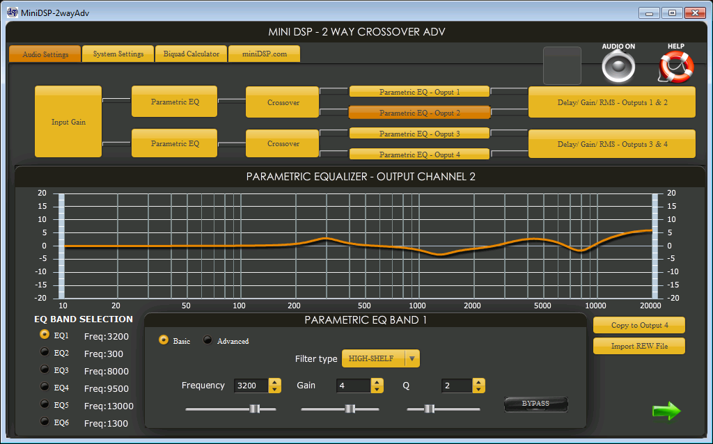

What I'm wondering, is whether you think it could be possible to improve significantly on the Heed 5 by modding them? That is - remove the internal passive crossover and do an external digital crossover, and also upgrade the drivers to drivers of a even higher quality.
